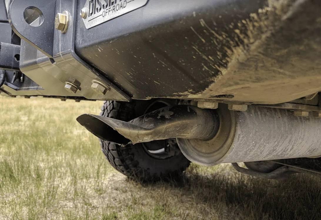

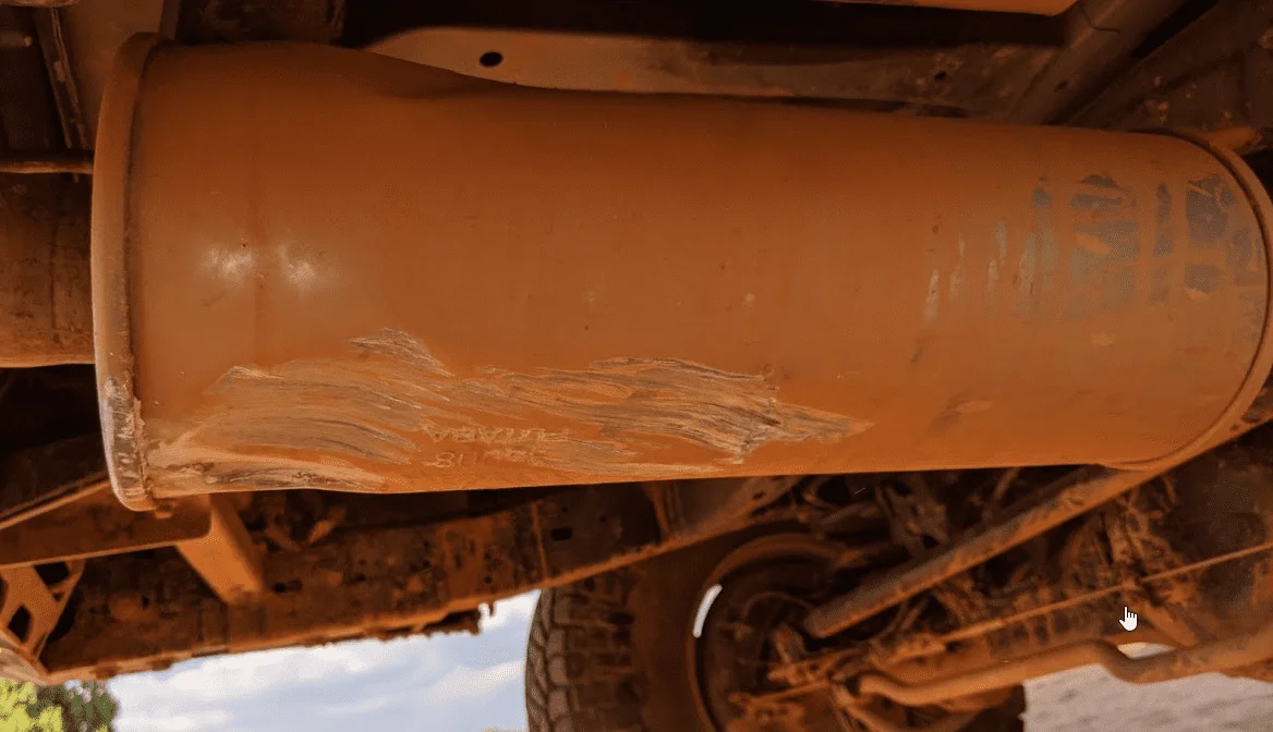

I keep crushing my mufflers.... first time cutting it "sort" of got me going. This time I totally crushed the muffler can. It sticks out way too far and the borla tip would most definitively get crushed. I've seen this one in life it tucks in nice and would hopefully not get crushed on a rock.
I'm really looking forward to it! I got underneath it for 5 or 10 minutes last night and got the tail pipe/resonator unhooked. It didn't slide out easy like I had hoped. I'm hoping to get it removed and the muffler loose this weekend so I'll be able to just bolt up the new one when it arrives.
Yup. I ran the stock exhaust with a V1 Dissent rear at HIH8 and had the exact same damage. I switched to the DT catback and had absolutely no problems at HIH9 or any other trails since then. It does tuck up nice and high.
I simply cut off the resonator on the rear and terminated the pipe just aft of the axle. No more bashing the exhaust system back there for me. 2 years on and no issues. Slightly better sound when on the gas without any drone when cruising on the highway.

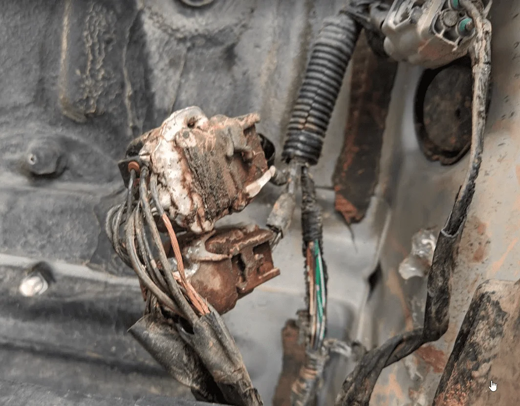

Thats what I have as a temporary solution, but there definitively seems to be more heat under the truck. I've heard reports of hotter ps rear tire, and my result is slight smell of fumes at startup. I really do want the exhaust to exit the body of the LC. Currently having to make repairs due to to this incident including melted wires due to heat, crackled powder coating and melting of locking nut plastic on the dissent and worst the arm sliding pad warped and melted. Having Ben shuffle around for a spare on the v1. There is a lot of heat output under there and you def want it to exit the body. Learned the hard way.
Thats what I have, but there definitively seems to be more heat under the truck. I've heard reports of hotter ps rear tire, and my result is slight smell of fumes at startup. I really do want the exhaust to exit the body of the LC. Currently having to make repairs due to to this incident including melted wires due to heat, crackled powder coating and melting of locking nut plastic on the dissent and worst the arm sliding pad warped and melted. Having Ben shuffle around for a spare on the v1. There is a lot of heat output under there and you def want it to exit the body. Learned the hard way.
Very good to know. I wonder if simply extending the pipe to just before the bumper edge at the rear would work. Could keep the pipe up high and then have an angled exit like the one the factory does aft of the resonator. I thankfully haven't seen any of the consequences you've experience, but definitely recognize the possibility and certainly want to mitigate that as much as possible.
That would be close, the dissent sort of creates a pocket right at edge holding up all that heat. I have to take pictures to show you the damage is extensive. I can't believe how much heat collected in there. It literally cracked off the powder off the dissent. I think the pipe has to clear the edge to be safe. I'll plan on posting a thread on this to warn others as a "hot mess". The harnesses damaged were not necessarily essential as to leave you on the side of the road mostly rear ac and trailer plugs, but could definitively start some spark if this happens to anyone.
here to give you an idea:
To be fair this all happened at the peak of Moab heat and almost 2k miles driving with the crushed can. The exhaust tip was partially covered by the dissent and I mean just a tad bit.
