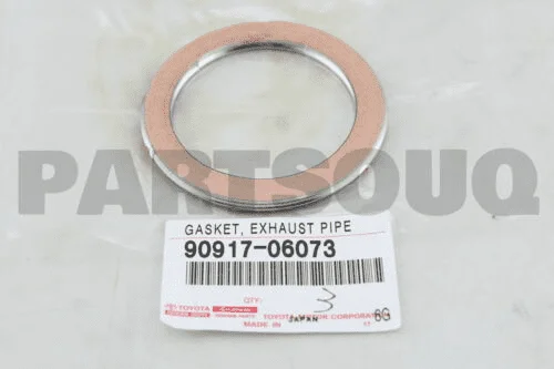

I found the Fel-Pro didn't work well with the Magnaflow. I replaced with OE ring gaskets, front and rear, and it fit much better and no leaks.

The newest part #

Hey Spike, sorry to zombie this thread, but that gasket you posted a photo of - that’s for the triangle flanges on either side of the stock cat? Looking for those and haven’t had much luck searching, except for this thread.

Yes, for CAT - that's the updated part # and as Cheezypoof posted, it's updated again.
Old number is 90917-06024 to 90917-06073 to 90080-43026
RockAuto has some under the old #
