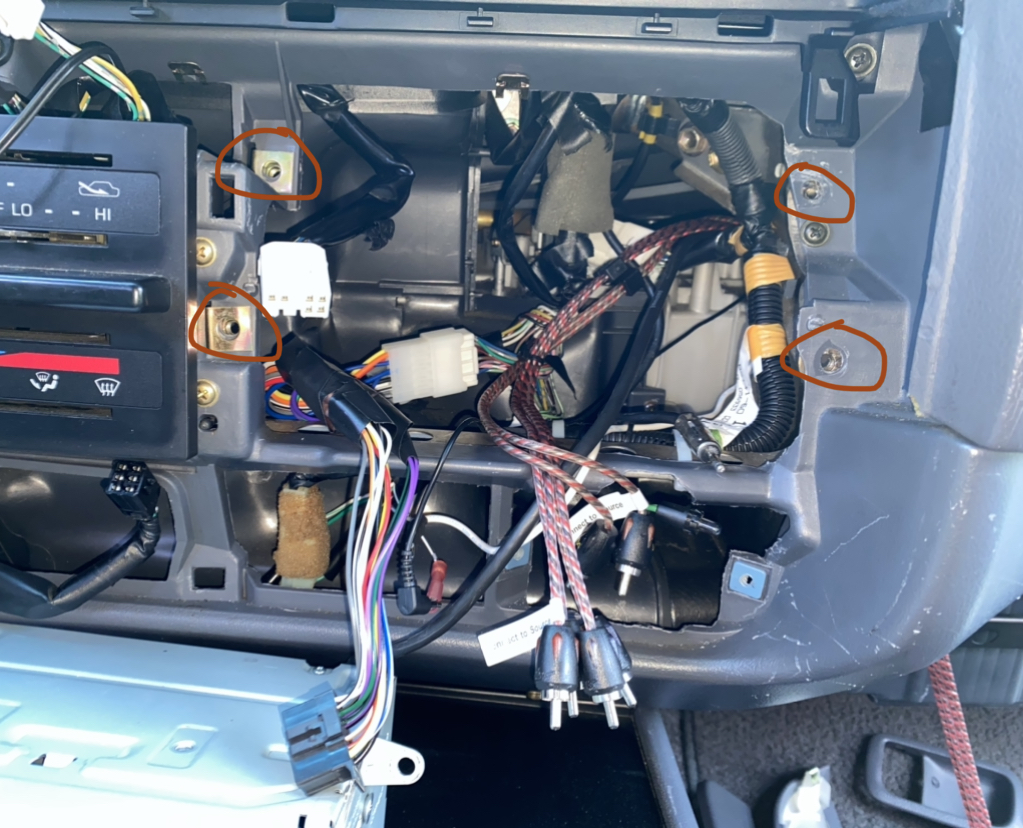

I removed a single din and replaced with a double din on my 95. I didn’t need any additional brackets. Just the radio.
There should be something that is L shaped to connect the body of radio to the dash. For example on my Subaru there are 2 plates that screw to the radio and have “ears” that screw into the Subaru.

This is the bracket I'm referring to. I'm pretty sure these were from the car side, not the radio side.

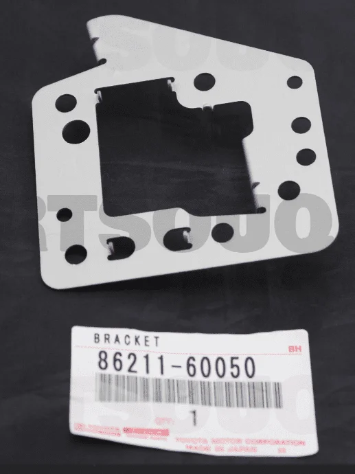

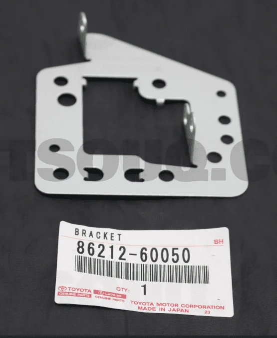

Partsouq has them in stock so you local dealer should be able to get them.
Ooh picture with part number, you're too kind.
You should verify the part number is correct. I looked up 94 but I'm not a parts person.
Will do though I’m pretty confident this, like the harness, is fairly ubiquitous among Toyotas in this age range. Most Japanese cars were very easy to add radios to with a simple dash kit. The manufacturers tended to make their radios fit and connect the same way among their various models.

You do need them. The one from toyotapartsdeal looks like the right one from when I did my swap. I think there's a different one for left and right, which I think is
86212-60050 and 86211-60050.

If it helps at all, I have a 91 and a 94. The brackets are identical across the 2 trucks. I did not require any trim kit for fitment of a kenwood double din unit & the OEM brackets attach directly to the head unit with no modification. I used metra wiring harness 70-1761 to connect the head unit to the factory connections. To bypass the factory amp, i just unplugged it (sort of behind the glove compartment).
The brackets you linked from cruiserparts do not look at all like the brackets in my trucks. 86211-60050 & 86212-60050 seem to be the ticket and cost less than a metra dash kit.

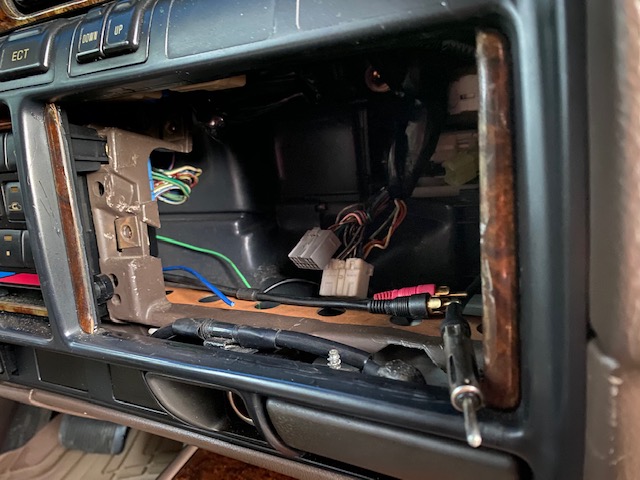

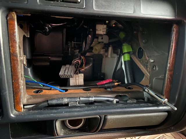

thanks, everyone, for the responses! Here are 2 pictures of the current situation......your thoughts? guessing I need the Metro wiring harness?
and parts 86211-60050 & 86212-60050? (still not sure about those brackets from Cruiser Parts and if I might need them too?)
also, can I use the factory amp with my new Sony double DIN stereo?
No, you cannot use the factory amp with any internally-amplified aftermarket receiver.
And yes, you need the brackets and the harness.
And I get that they're doing free installation, but if you can solder and/or do butt splice connectors, you're better off than how they'll likely butcher it.

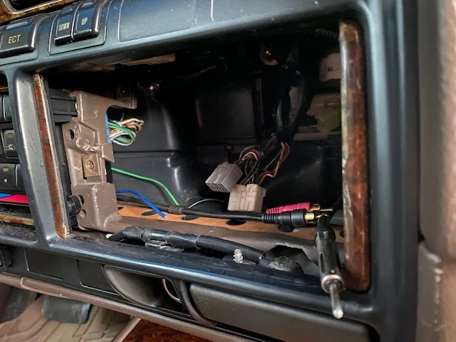

I dont have any idea what the cruiser parts brackets are… the other ones will screw on to your head unit and in to 4 screw holes that i see in your pics. If you use the Metra harness (wire it yourself, easy enough) it will bypass the factory amp, which is what you want. There are 3 plugs in the factory stereo harness, one is what the original stereo plugged into. The gray one. The two white ones are what the Metra harness uses to allow you to bypass the amp.
