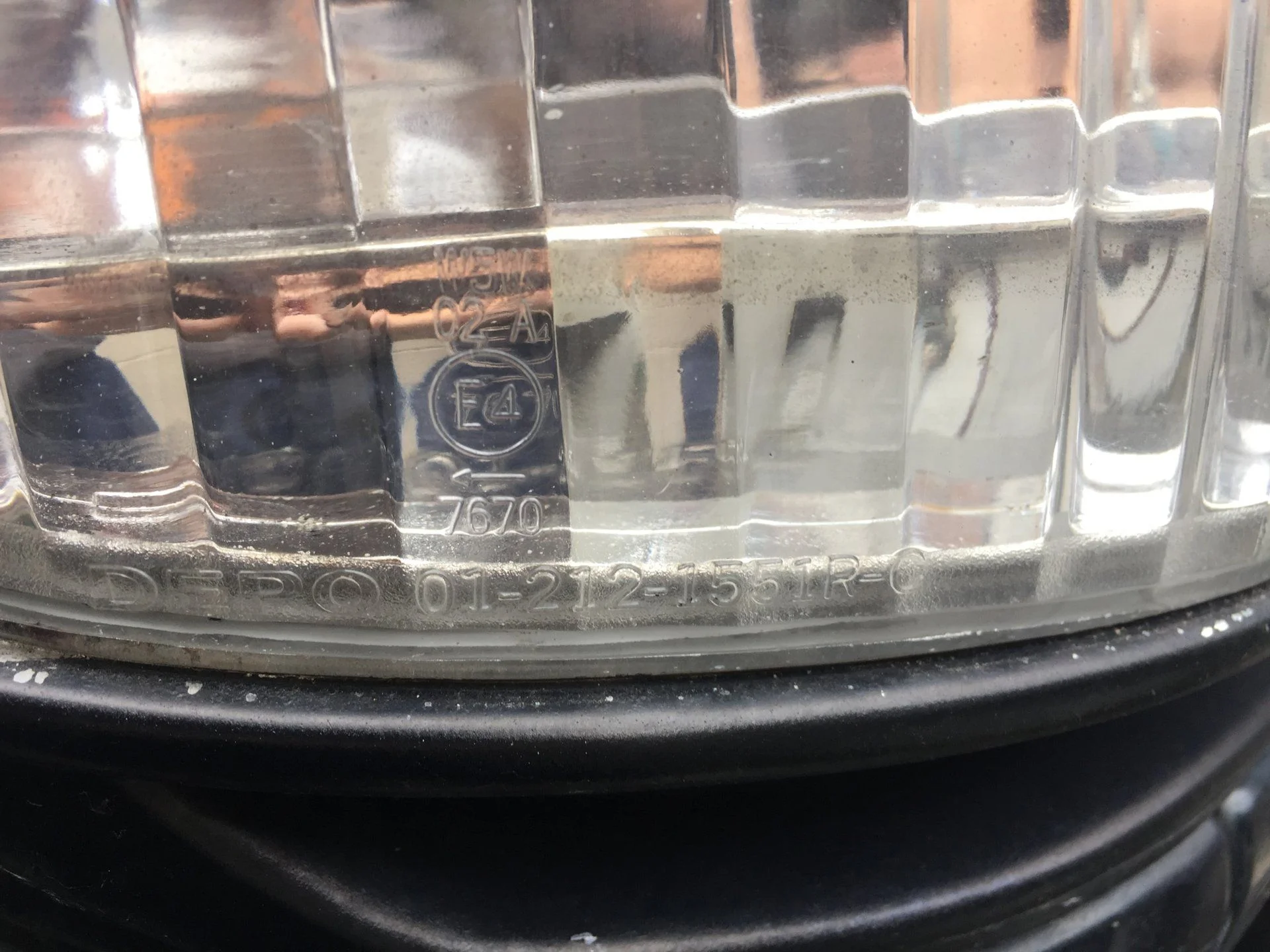

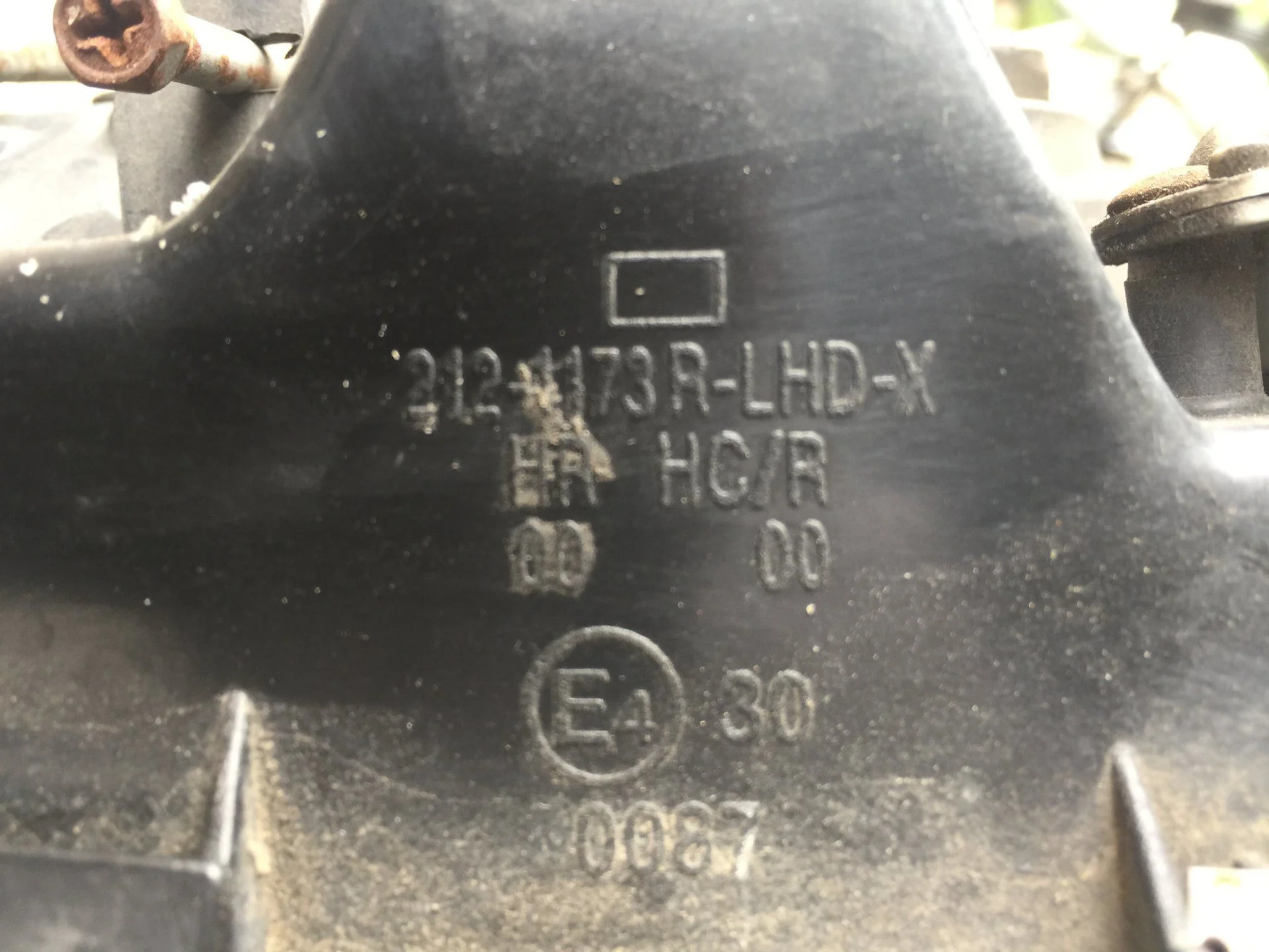

Oh bloody hell....I'm such an idiot. When I bought the truck 6 years ago it came with Depo headlights and I immediately changed them out for the OEM units because I was going to Hokkaido for the winter and the HID's wouldn't get warm enough to keep the ice off the lenses....SO.... just checked down the basement and voila...big DEPO box with the headlights and corner lights. Both have the E4 dot and truck is already HID retrofitted.... My wife told me this is a "sign"... I agree. Let me know if these are the right dot or not.

Thank you MonsterCruiser....it was your post to the yahoo pages that jogged my memory. I did a further search for sources here in Japan for depos and it sure has dried up. There are a lot of other cheap look a likes but I can't see if any of them have the dot.
Will they? Its RHD isnt it, so the reflectors are all angled "wrong" and you would need LHD ones.
Good point Enigma. I have no idea. Any one else have insight on this?
Type that part number into the DEPO website, see if it indicates RHD or LHD.
I took a closer look at the housings and it clearly states LHD...I should be ok I'd think.

If it says LHD then I think you can live with that. Certainly if an inspector questions your integrity about it
keep the pic handy and you can honestly say you did your due diligence, and move on.
