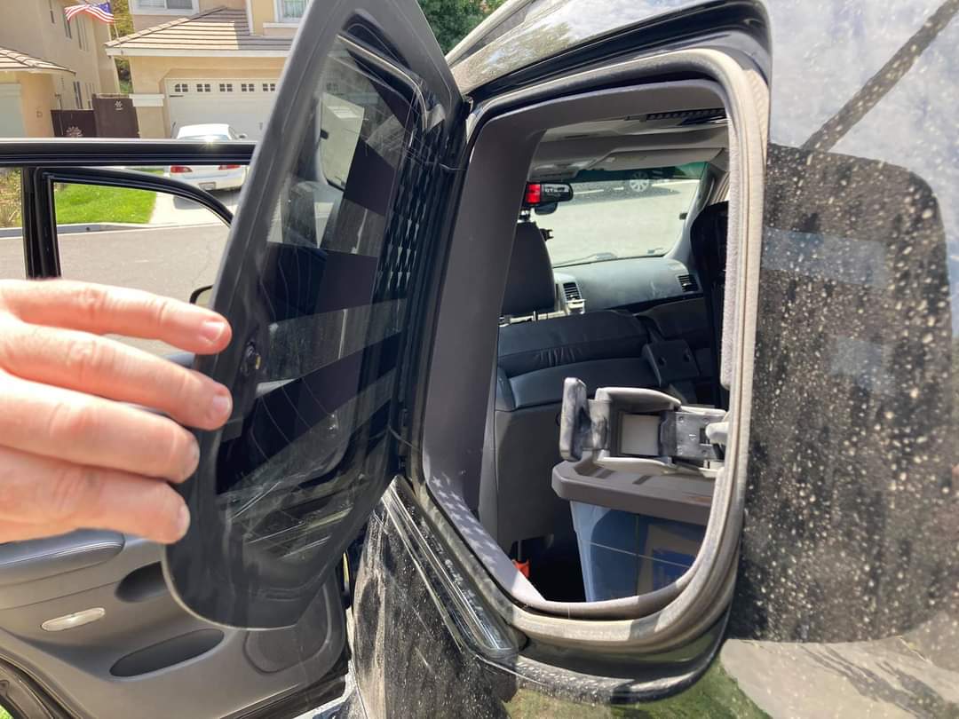

I replaced mine bare handed, so I was either lucky or careful. Yikes

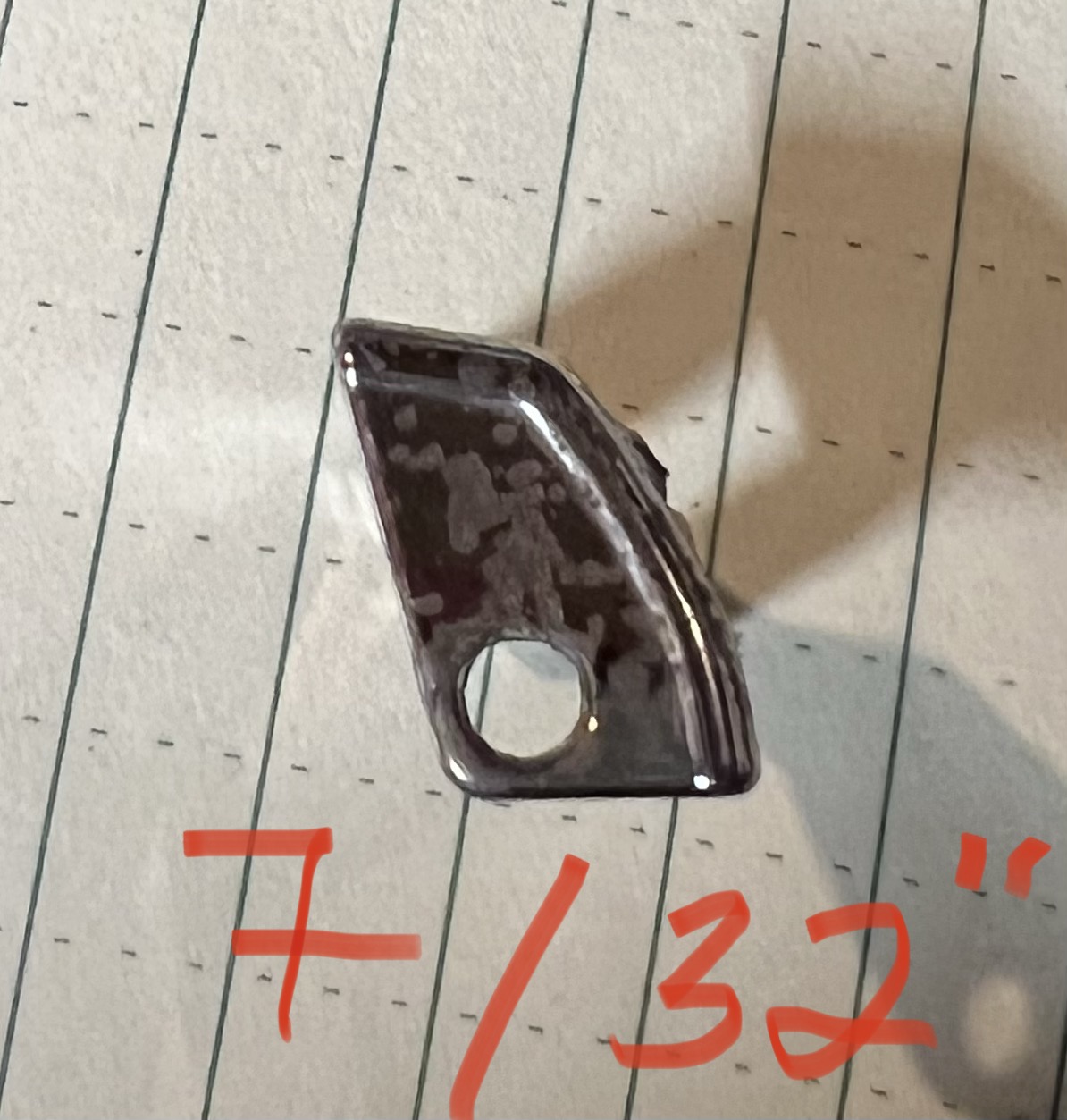

My contribution to the collective knowledge base:
For those that purchase the eBay sets in black that do not have the small hole in the leading edge of the rear door sections, see photo showing location of the stock hole and diameter 7/32" drill for rear door leading edge trim piece.
I also found it much easier for all four to start at the end that had the securing screw and move down from that, so front to back on front doors & rear to front on rear doors. But as others have stated, brute force works well in any and all directions.
