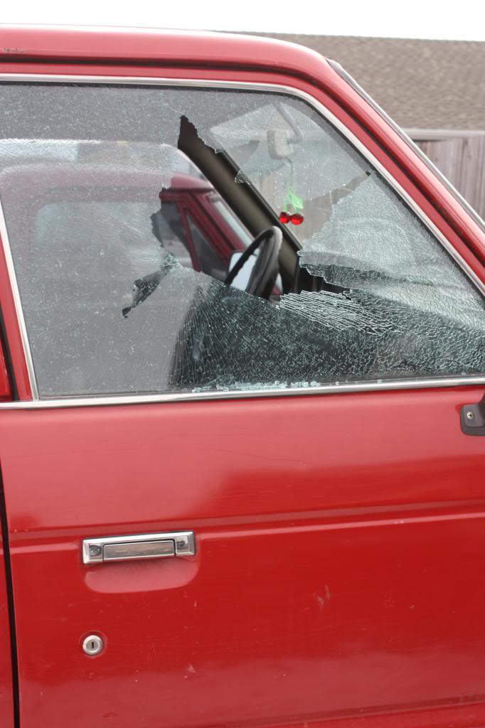

I had to tear into my door to replace a window that some jackass decided to smash out and since I know some people are intimidated by the door I figured I'd do a quick write-up.
This is what I woke up to on Christmas Eve (we had one window in three cars of our four cars broken, I had spares for the one that didn't)

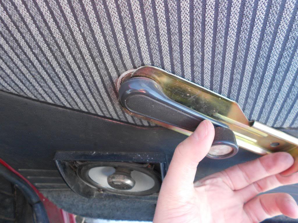

Tools: Phillips (#2, and #3), flat-blade screwdriver, window crank tool, and a helper
Step One: Strip the door. Speaker, arm rest, window crank, and door latch trim all need to come off. The door latch and arm rest are just held on with screws but the window crank is a little trickier. A tool like this makes for a much easier removal; just slide it between the crank and the trim ring. A flat-blade screwdriver can be used if it's all you've got. Be careful with the trim ring. Mine crumbled apart as soon as I touched it.

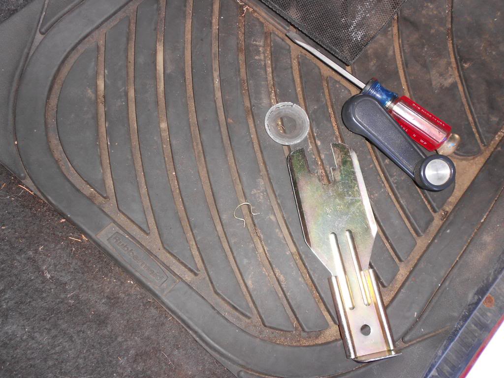

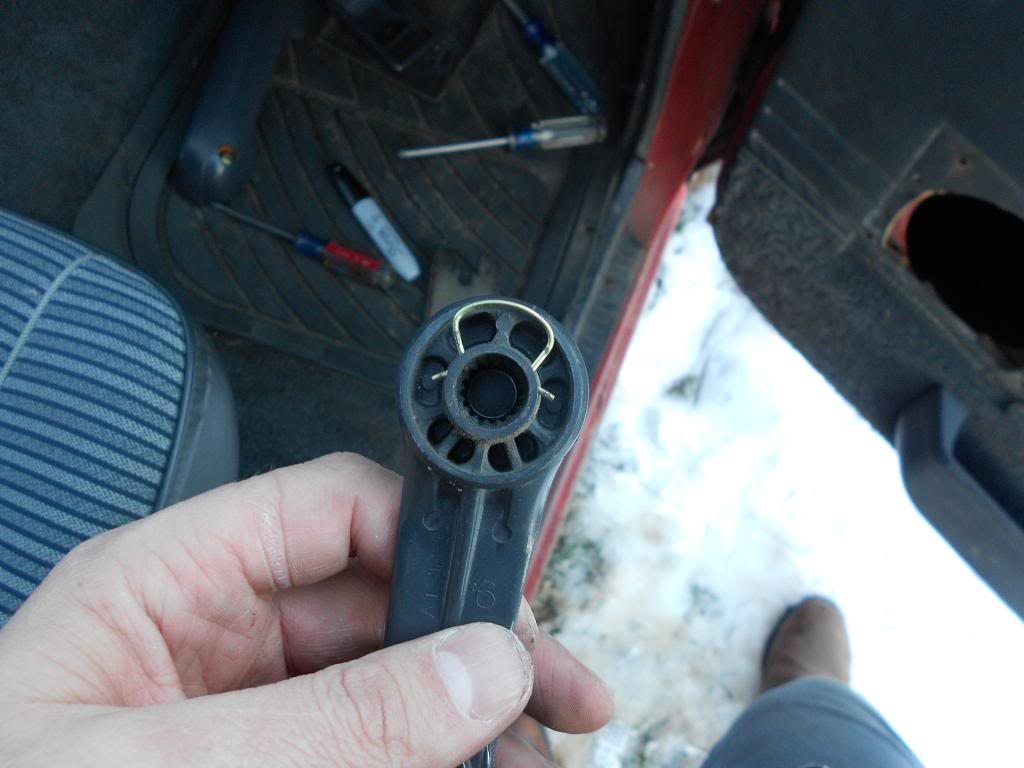

Make sure not to loose the clip that holds the crank on. Mine kept walking away with the assistance of my helper.

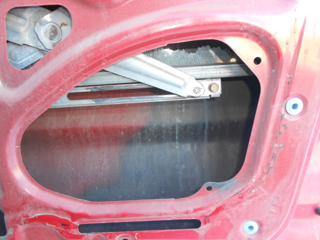

Step Five: If you are only replacing glass like I am (and if you still had the plastic in place), you only need to peel it up from the bottom two corners to allow access to the two bolts that hold the window channel to the regulator.
Step Six: Undo the two bolts pictured above and pull the glass out carefully. On the front doors the straight edge (latch side of the door) has to come out first as you let the mirror side drop into the door. It also needs to be pulled inside the door, following the curve of the glass. I assume the back doors are the same, but I haven't pulled one apart yet. Now you can replace weatherstripping, the window regulator, etc.
Step Seven: Installation is pretty much the opposite of removal, mirror edge of the glass goes in first, followed by the door latch side. Make sure the window is seated in both the front and back channels before you bolt it to the regulator. This is much easier to do with two people.

If you dont have that fancy tool a screwdriver can actually be difficult to get in there to get the window crank retaining pin off. As the handle of a screwdriver is too wide to get the right angle. What I was taught to do is grab a shop rag and put it behind the window crank and gently pull one end of it as if your were pulling a rope through a pulley. The retaining pin end will "hook" into the threads of the rag and then it will pop off. You just need to keep a sharp eye and ear out for when it pops so you can see where it lands. This is a super easy and fast way to get that stupid pin off.
Not good to use any old RTV for this. In addition to being very dificult to remove, certain kinds outgas acid and corrode metal. The correct material used at the factory to hold the moisture barrier is butyl rope caulk. However, duct tape works really well, too. I used the "real" kind, with a Mylar face, and the seal is better than factory. Any 3-4 poly sheeting will do for the barrier itself.
Or if you cant find a screw driver you can actually use a towel like it shows in the FSM to take the clip off and it actually keeps it from launching itself. However, I have already lost my clip on my drivers side so I need to go and grab another, never tried just placing it on and them pushing the handle on.

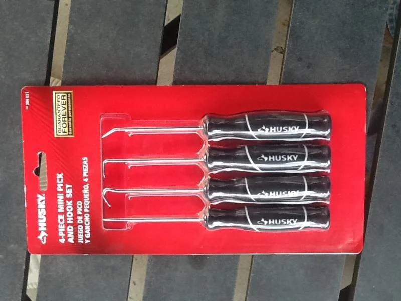

A pick set is very helpful with these window crank clips. I use the looped one second from left pictured below. This way if turned correctly the pick stays low profile while grabbing the closed end of the clip. The clip also stays on the pick and doesn't go flying across the garage/ driveway/ wherever.
I picked up this Husky set from the Home Depot yesterday, the 21st, on sale for $2.00! Regular price was 4.88.

I'll keep that in mind. I've have plenty of duct tape lying around. On my door, it looked like the PO had tried to use brown packaging tape to hold the plastic on but then gave up and ripped it all off.
Didn't realize you had to rotate the glass then pull it out, I fought with mine for an hour before finally using a piece of 1x1 wood to hold it up out of the way while I put my new regulator in.
I had never heard of the towel trick, although usmcruiser mentioned it too. I may have to give it a try next time. It probably would have kept the plastic ring behind the crank from crumbling apart. I fought with my clip removal tool for quite awhile (tearing up the trim ring even more) before I realized I could just put it back on the handle and push it on; felt kinda dumb after that :)
I've been meaning to get a set of picks like that for various hard to reach areas. Guess I know what I'm doing for lunch tomorrow.

the little plastic cup behind the hand crank is pretty cheap from Toyota, just replaced mine. I try to keep an extra clip around.....because I loose it every-time....always found in the door pocket...but after crawling on my hands and knees for too long. I use the towel trick and then put the clip on the handle and push on.
