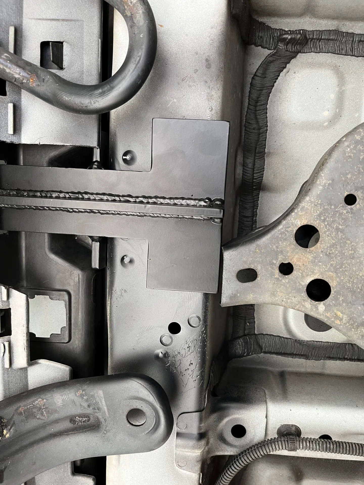

Figured it out!! There’s a metal bracket attached to the spare tire crank under the truck, and the brace that ACC installs was rubbing against it. This led to the awful metal on metal sound.
I removed this piece of metal - held on by 2 bolts - and a test drive around the neighborhood’s speed bumps and turns was silent (except for my usual squeaks from shot KDSS bushings that will be replaced this weekend).
Now, where I’m curious, does this rubbing imply the tire support bracket may not be tightened properly? My guess is no, and that it’s just a little normal flex and limited clearance between those 2 pieces.
The curved piece on the right is what was removed.
What's the purpose of the curved metal bracket you removed? If not important, then just leave it off. Otherwise improve the clearance so they are not so close to each other.

that is the cover and channel for the spare tire winch.
Thanks, @GXO!
I don’t think it’s problematic to remove. Just two small bolts held it to the winch. Connected with ACC. As long as the strike plate has solid contact with the truck and the door rises when it makes contact on close, then I’m good. Figure it was just some flex when the truck hit bumps that made the two parts touch.
