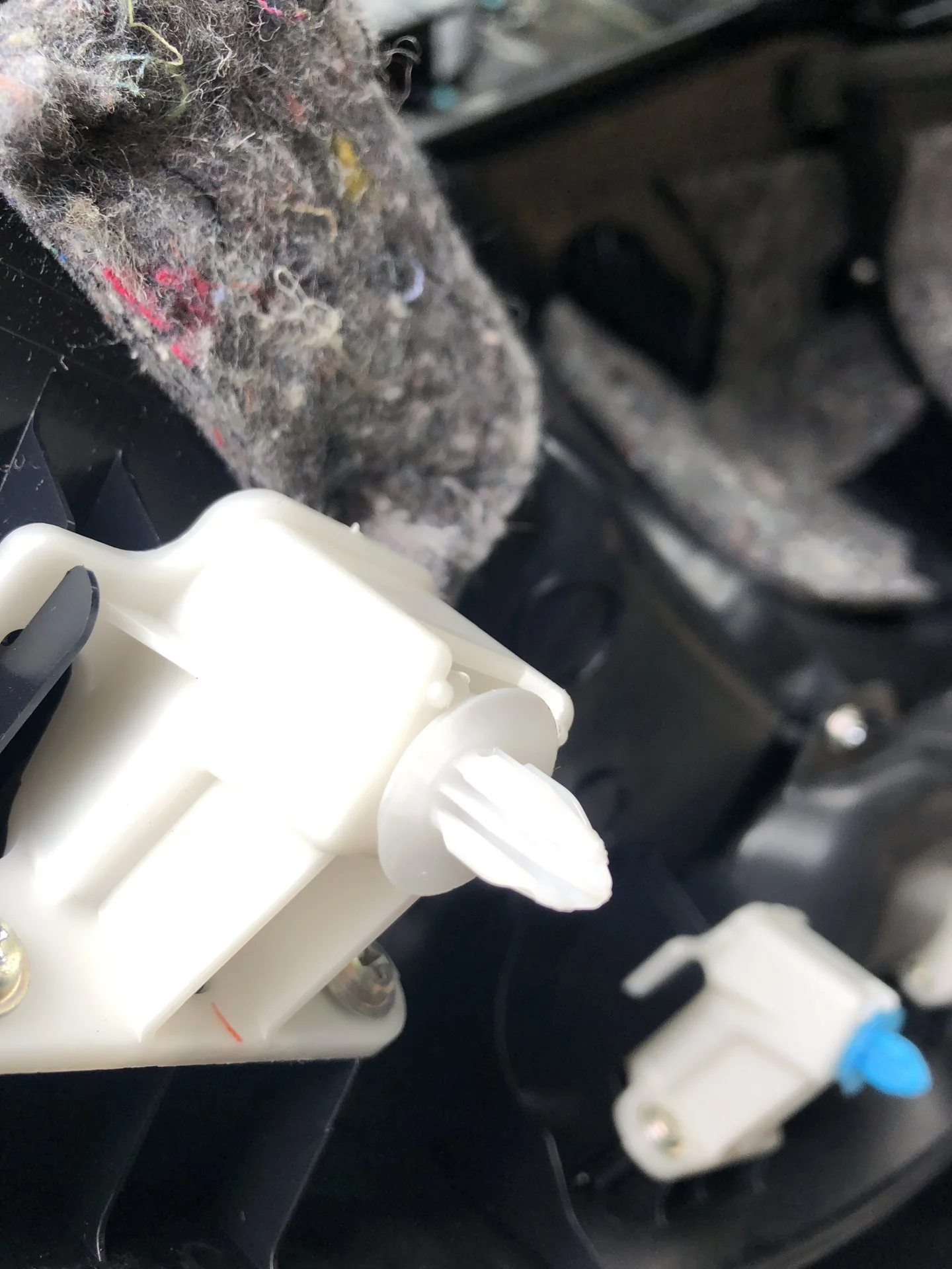

My passenger door started acting up a year ago, wouldn't lock with the FOB, only from inside the car I was manually able to lock the car, I ended up replacing the actuator, part itself wasn't terribly expensive, took me about an hour to replace it.

Take this with a grain of salt- I haven’t replaced them on a LC, but have on other vehicles - this job is mostly taking the door card off and putting it back on with a couple of unplug/replug of electrical plugs to the door switches and lighting. The actuator itself is probably bolted on, has a single electrical plug and has a clip attaching it to the actuator rod. If you’re good with mechanical work, a project like this should be easy.

As @CharlieS said, it's a fairly straight forward remove and replace operation. Find and remove all of the hidden screws attaching the interior door skin, swap out the actuator, and reinstall everything.

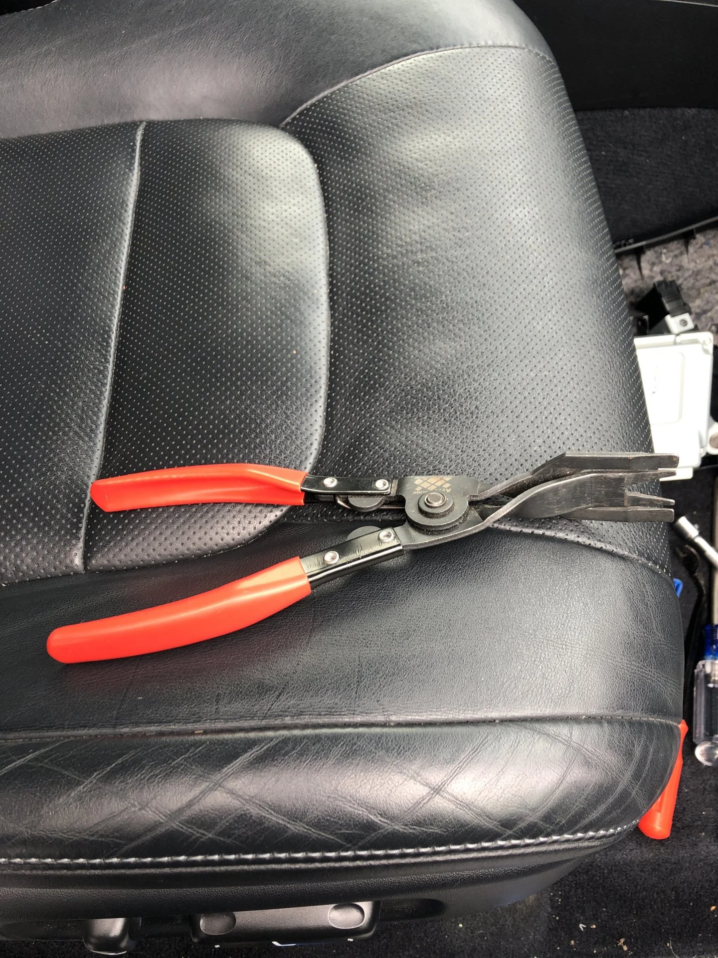

Is the door panel installed with screws, ie not those very breakable plastic things?
Both. The plastic tabs are pretty robust.
You can absolutely do without it, but a tool like this will make you very happy when popping trim fasteners:
These are a common type of fastener in trim panels:
