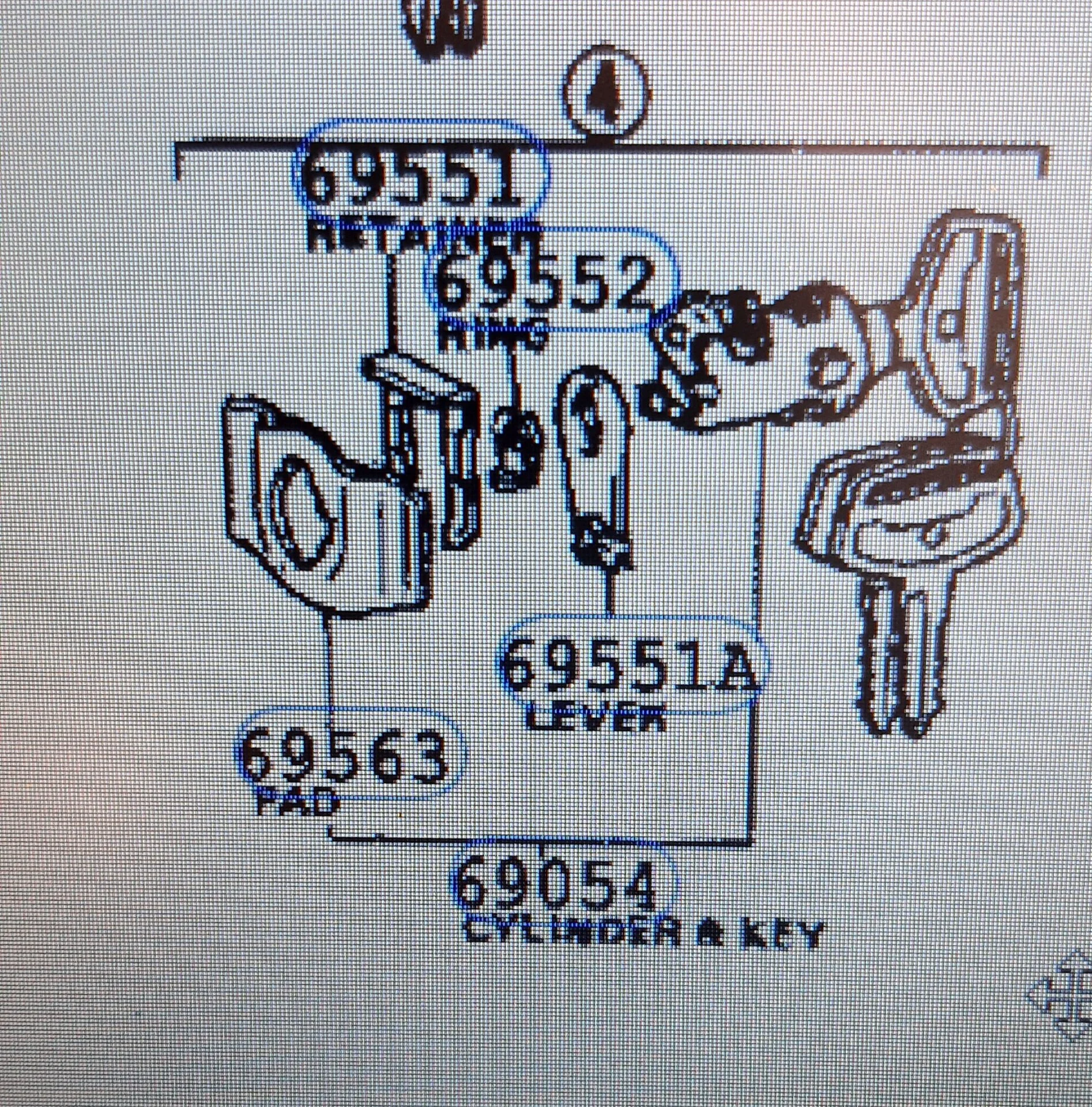

Hello all. I need your help.
A bastard broke the backdoor lock cylinder. I need the parts. Thanls you! GreetsView attachment 3215618
Place a "wanted" ad in the classifieds section or better yet look at the "parting out" section of the classifieds and start PM'ing members that are parting out fj60s. If you can't get a key but do find a cylinder and linkage, you might be able to send the cylinder to @ToyotaMatt and have him make a key for it. If you just need a cylinder he might be able to help. I'd also ask him if he can reconfigure the tumbler so your ignition key would fit it. FYI...60 and 62 rear locks are different and not interchangeable.

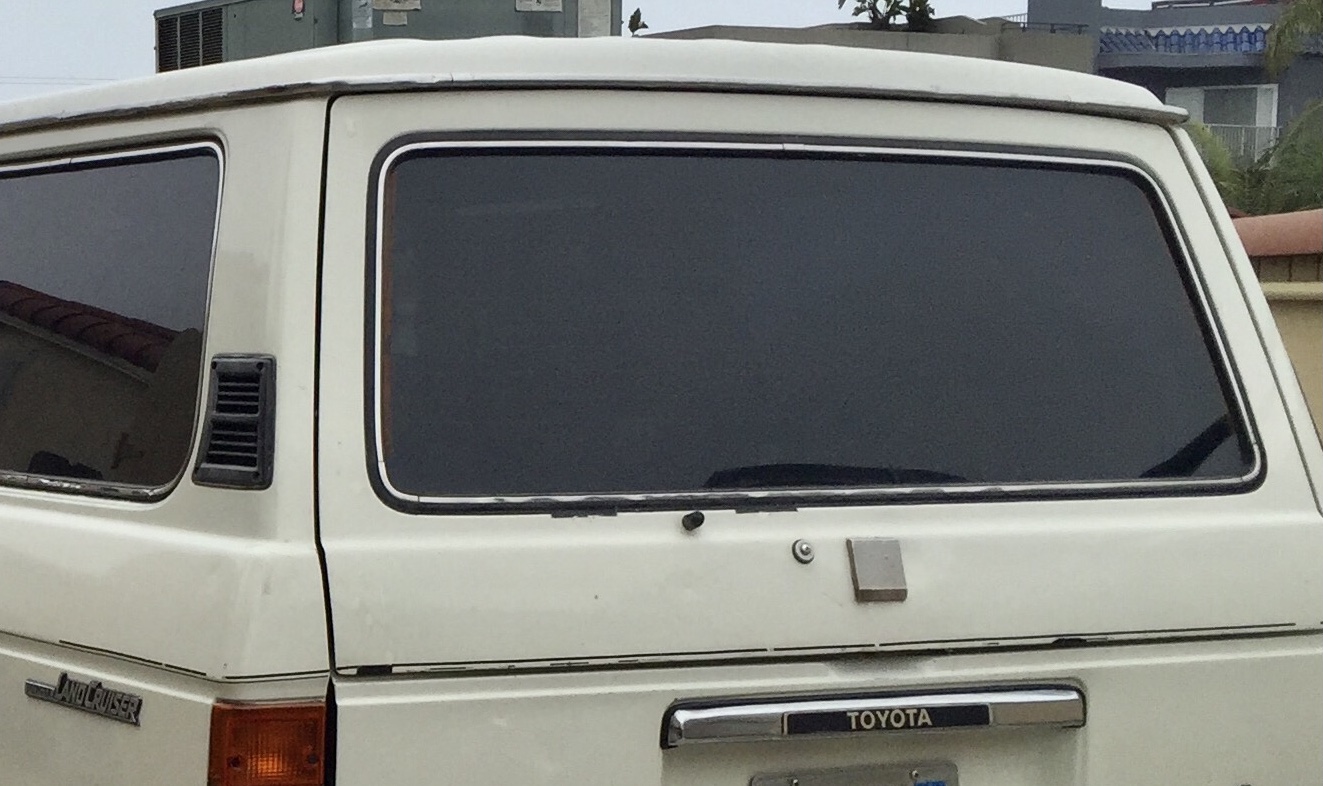

A thief broke into my cruiser and destroyed the rear lock AND mangled the hole in the hatch that retains it.
I couldn’t install a new lock cylinder because it wouldn’t fit in the mangled hole any more.
This is how it got fixed: stainless steel plate bolted through from the inside. The hatch became intamperable after that.
Actually this fix is an upgrade from the easily broken rear lock. Much more secure.
A line was tied to the lock lever inside the hatch and led to the grab handle behind driver’s side. Easy to release the lock.
