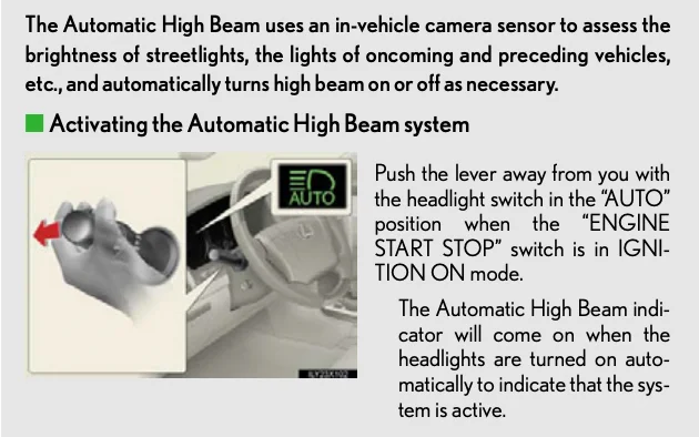

Based on the manual it seems to have automatic high beam but when I turned high beam on mine, I do not see the "auto" in the green icon.

My icon does light up green but not showing the "Auto" as shown in the manual.

On your '14, when the high beam light does com on, do you see the "auto" in the green high beam icon showing in the dashboard? My doesn't have the "auto" part on the icon.

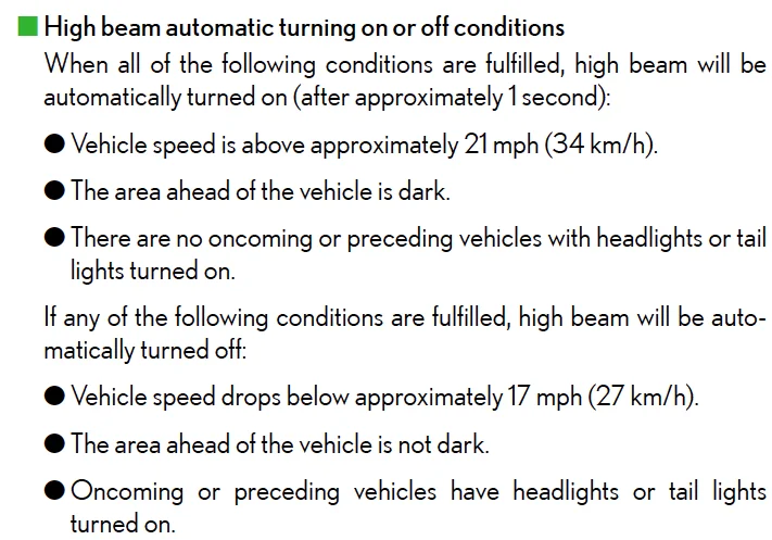

I have tried push the lever away from me and the green high beam light icon does show up on the dashboard. I do see the high beam light. However, for automatic high beam, the manual does have these conditions:
Base on these conditions, I shouldn't see the high beam light since I'm stationary. However, I do see the high beam light. I assumed all three conditions have to be met for the automatic high beam to turn on. In my case, it's dark and no oncoming vehicles but I'm stationary.
This feature is available on 13-15 and activated by tech stream, the default is on but a lot of people had dealers change the setting. If you don't want to use the feature turn the light switch to on rather than auto.
