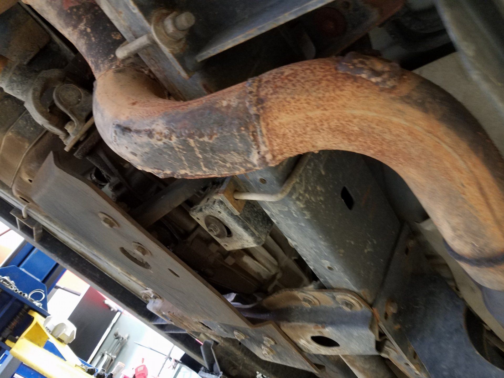

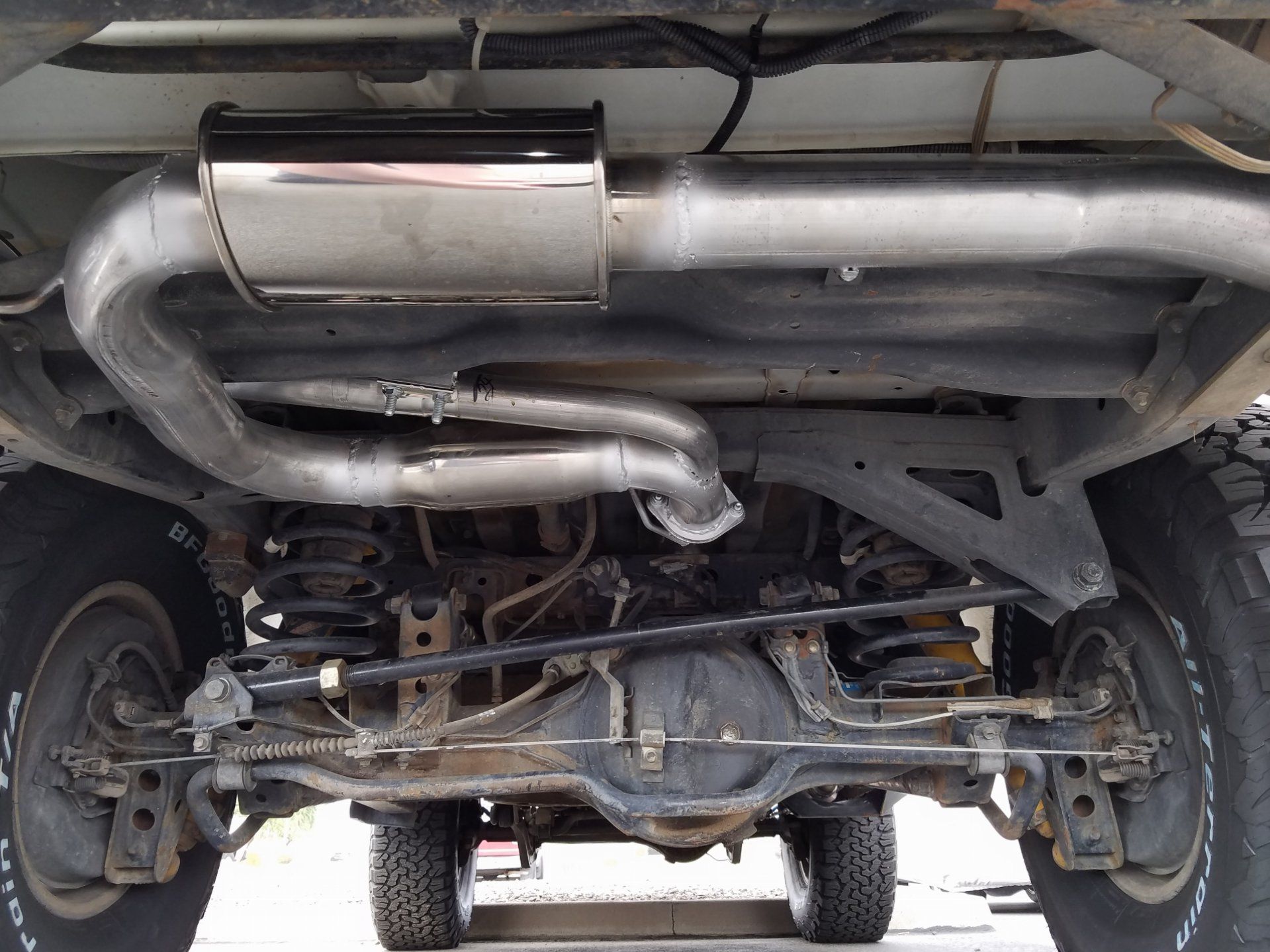

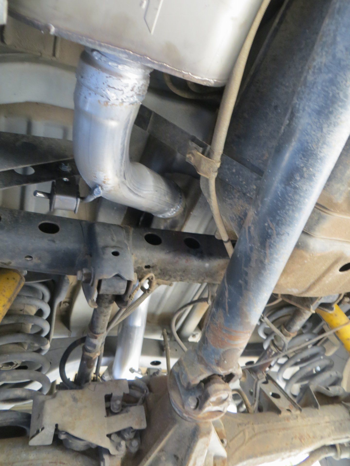

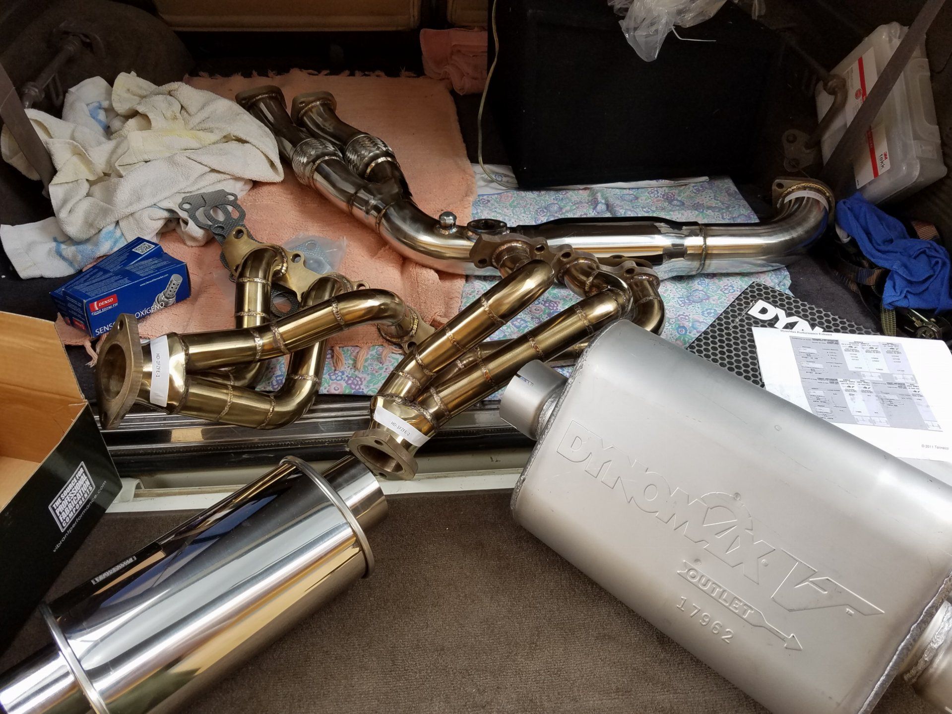

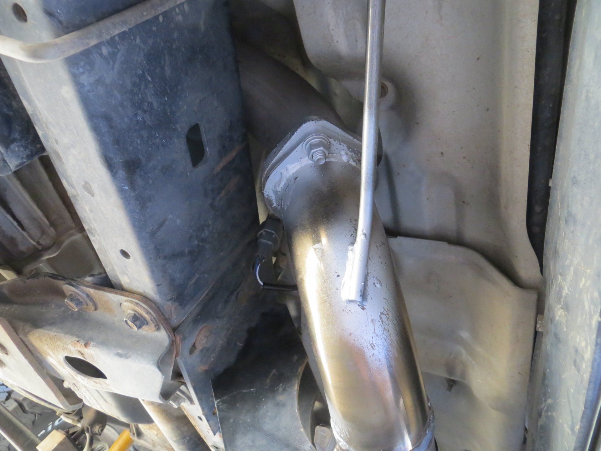

I had put headers on my '78 FJ40 over 25 years ago and had always lusted after them for the 80 series. Found them on line and ordered them. Did not realize they cut off the feed for the EGR, but found a way around that. Scottsdale Muffler in AZ is the bomb for custom exhaust work. Chris and crew are awesome. They got the exhaust over the frame behind the cats. I had 4 repairs on this section due to it hanging below the frame before. Greg's Japanese in Chandler helped me delete the rear heater and some I do not have to worry about melting the heater hoes above the frame where the exhaust now goes.

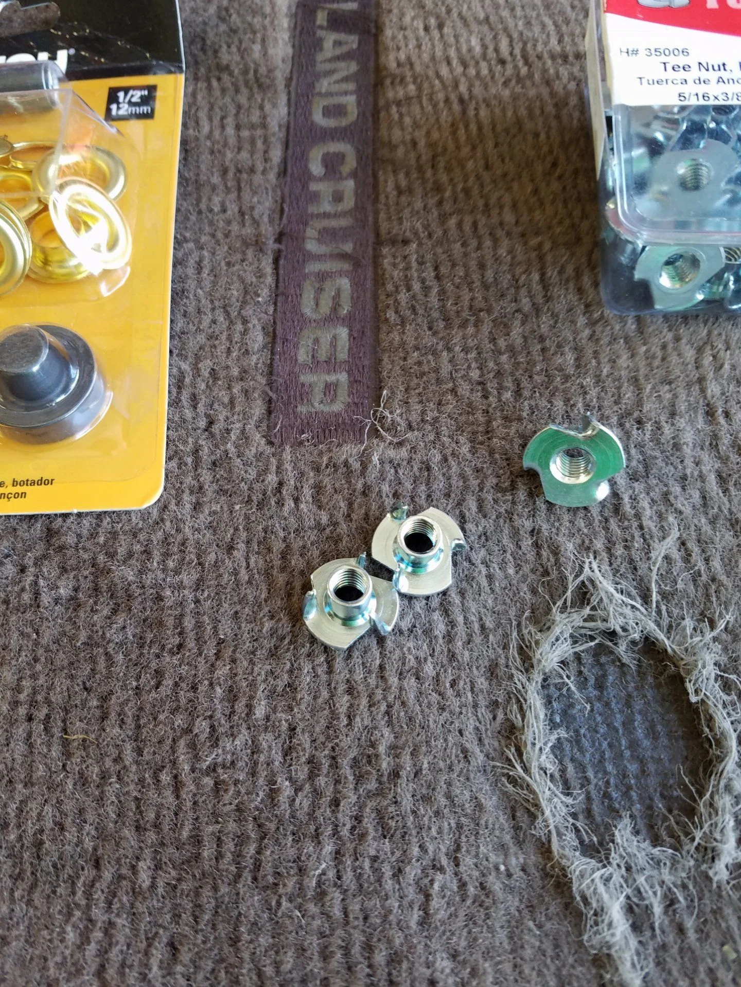

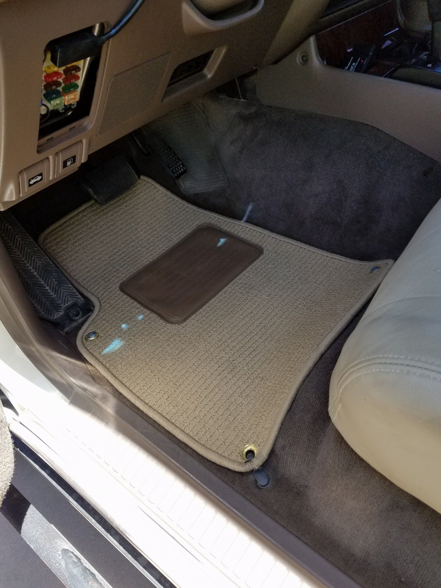

Way tired of the driver's side floor mat sliding to the left and getting crunched up and deformed. I noted that later models had two hold points. Found some "tee nuts" that have spikes that could grab the carpet below the floor mat. Made it pretty by using brass grommets and fasteners. Very happy with the results.

This is so-so sound quality and worse video! I was recording the frequency spectrum vs speed by taking a video of a tablet running two apps. The site won't let me post here. Hopefully this link to YouTube works. The J-pipe length was tuned to eliminate the drone at 75MPH/2800rpm, and you can see the peak dB at around 120Hz roll off at 75MPH. This is about 45 seconds into the clip. I was driving one handed while recording and got too nervous to push it faster.
Ulysse Speedometer app (on the left) lets you do 1/4 mile, 0-60, and 0-100 timings and speedometer using GPS. Physics Toolbox (on the right) has a spectrum analyzer.
The J-pipe itself is in the 3rd picture of post #8. The smaller pipe with a two bolt clamp pointing to the left and going over the main exhaust.
