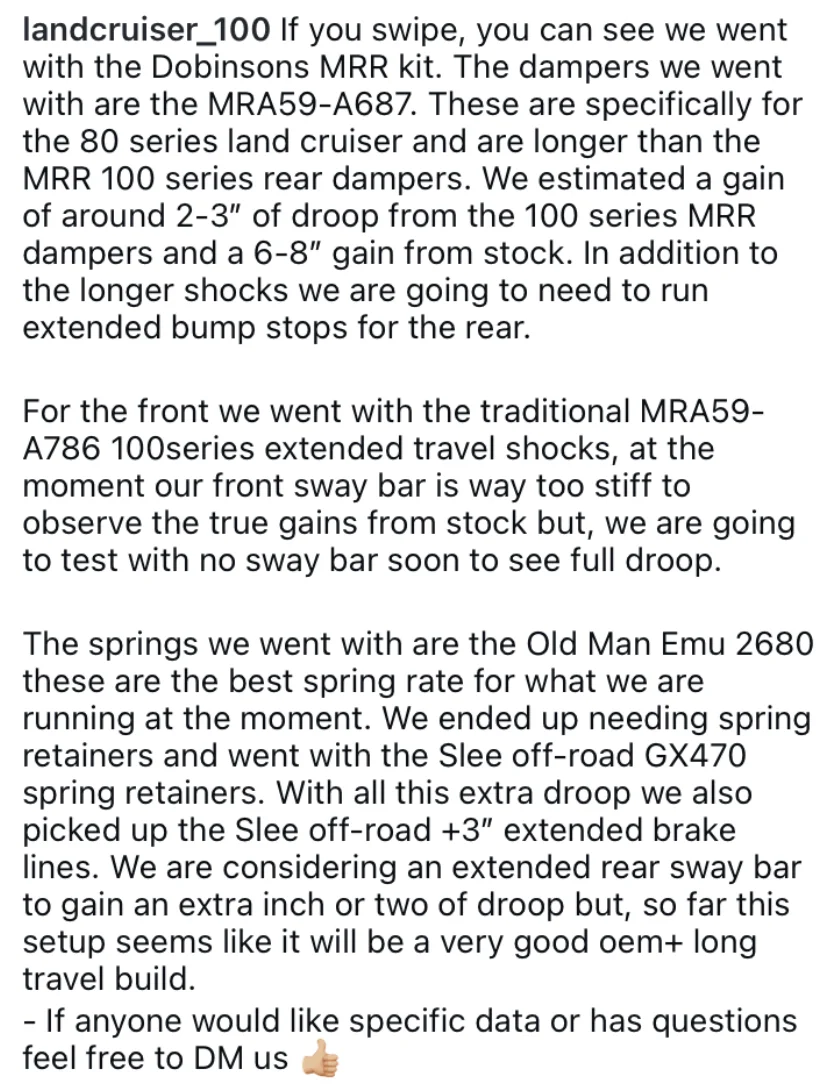

Then I came across these guys’ setup on Instagram, and their rig looks awesome (I believe they’re on mud as well, so please feel free to chime in guys if you see this):

1) Given my “mild” front lift goal of 1.5”, should I go with the MRA59-A782 (advertised for up to 2” lift)? Or can I go with the MRA59-A786 (advertised for 2-2.5” lift), with the hopes of gaining more down travel? Is my rationale flawed? Would the ride quality or shock durability suffer if compressed at a ride height they were not intended for?
2) For the rear, can I go with the MRA59-A687 (specifically for the 80 series, not 100) as the guys above? Or would that be overkill and potentially problematic for a rig like mine with only 2” lift in the rear sitting on 33s?

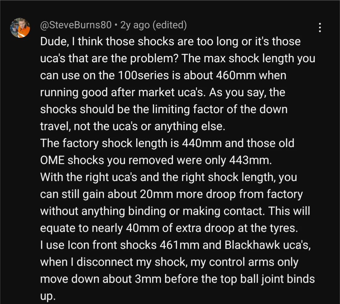

@crikeymike I haven't confirmed this myself, but this comment on the YouTube video I shared says:
If we assume it's accurate, are the A782's longer than 440mm?
Dobinsons twin tube GS59-782 are 442mm. IMS and MRA are 455mm. Extended length 786's are 470.
CV's will bind up if the diff drop kit is not used with the extra travel of the 786's.
