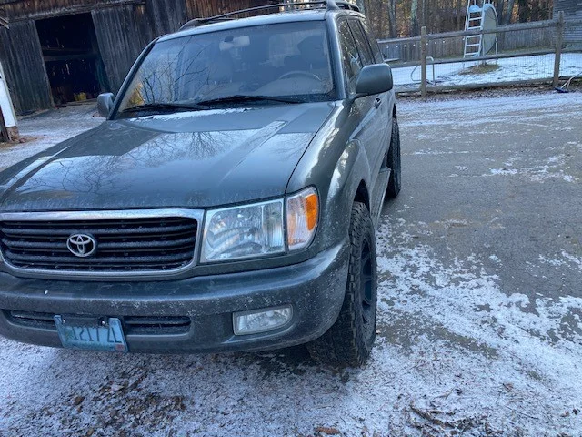

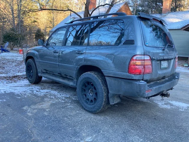

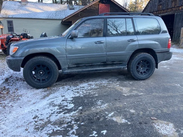

As much as I have learned from IH8MUD, I got zero help for these posts. Adding my contributions so hopefully someone else can find out the info if they are interested. These pics are 265-75-16 worn tires on stock rims after the Dobinsons springs were installed (specs in first post). I adjusted the TB to 1" drop that day, and it drove notably worse than it did with the old springs/shocks. The springs raised me over 2" in the rear, so I did have to crank the TB up a fair bit to 1" rake. However, I also found a broken sway bar link on the front drivers side when I was in there.
After the sway bar parts came in (I ordered front & rear refresh kit from Cruiser Outfitters) I went back to the shop. Measured droop as I lifted it off the ground and I was right at 50mm (2"). Also, my rake had decreased and I was sitting level (obviously measured on the ground). So I brought the front down 5 turns which gave me 2.5" droop and an about an inch of rake. It drove great, but I'm not sure if it was the TB adjustment or the sway bar repair!
Here is is now, with 18" Method 308. No spacers. 275/70/18 Cooper Discoverer A/T, which from what I can tell is the same tire as the new Cooper AT3 XLT but without the new sidewall pattern. They were $200 each from Walmart vs. $300 each for the XLT.
