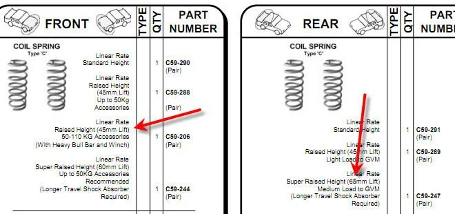

There was a revived thread about lift kits a short while ago that raised some questions for me about my pending order of a Dobinson lift kit for my rig.
I agree. I miss my Dobinson set up so much. You could drive 60 km per hour down a washed out logging road not spilling a drop. If they could only keep the truck level, that was my only complaint.
With a winch, bull bar and a couple times a year of camping with 6 passengers and gear on the roof otherwise a dd and 5% offroad, this is what Dobinson recommended:
They have recommended the heavy fronts (40mm) and the medium rear (65mm) which raised the concern based on the comment above
Would you opt for using the super lift (60mm front and 65mm rear), the regular lift (40mm front and 45 rear) or mix it up the way Dob's has suggested?

If Dobinsons says that combination is good it will probably be fine.

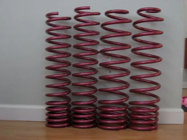

A heavier rate spring will hold up better to extra weight causing less sag over time. A taller spring with a lesser rate may be taller at first but it will sag and fatigue over time due to not being able to hold the extra weight if that makes sense. I have gone from the Dobinson coils to the Rabbit 4x4 coils. The Rabbit coils leveled the truck out perfectly. They were all different sizes see the picture below. I have now moved to the OME 80 series front 850j spring for the rear and it is stiffer with helps out for my three link and I still have the Rabbit coils in the front. Need coils, I have a bunch lol!! I haven't heard much about other people having the lean to the right maybe dobinsons have figured out about the lean or maybe it was my truck to blame:meh:

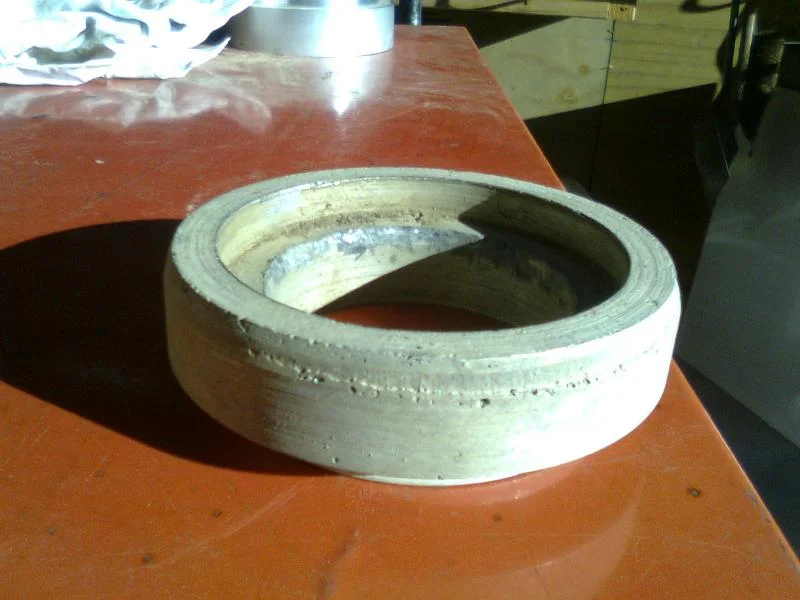

Hey kzj78 looking good. You still have the dreaded lean to the starboard side :hhmm:.With a tape measure, on flat ground, which wheel well is the lowest height on the right side?? My suggestion would be to use a scissor or bottle jack, place it on the top of your right rear tire and crank the body up. As you lift the right rear the right front will rise also and the left front will go down making the truck level. Measure the amount of lift you needed on the right rear and buy a coil spacer and stuff it in the rear. Cheap, easy and works. The 80 series front coil spacer fits perfectly on the rear spring and there are lots of different sizes you can buy check eBay out. I haven't found a supplier that sells front coil spacers or you could do the same with the right front. Another option would be to cut the welds on the right front upper coil spring saddle, lower it down and re weld.
