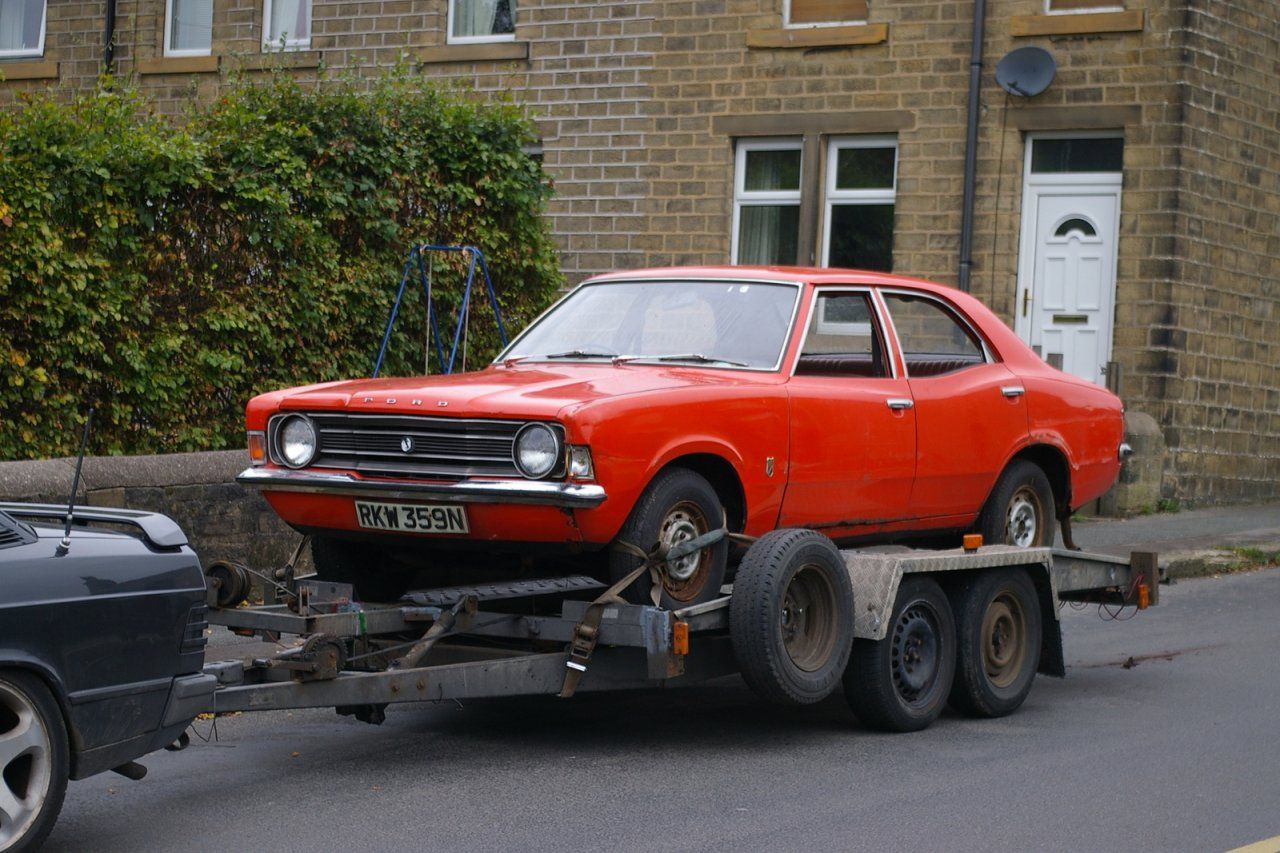

'74 Ford Cortina. 4 door, 4 speed, with a weber carb on a 2000cc motor. Was rusty as hell but was fun :)
But good luck finding one.

Never even heard of a Cortina... Looks like something Columbo would drive.
