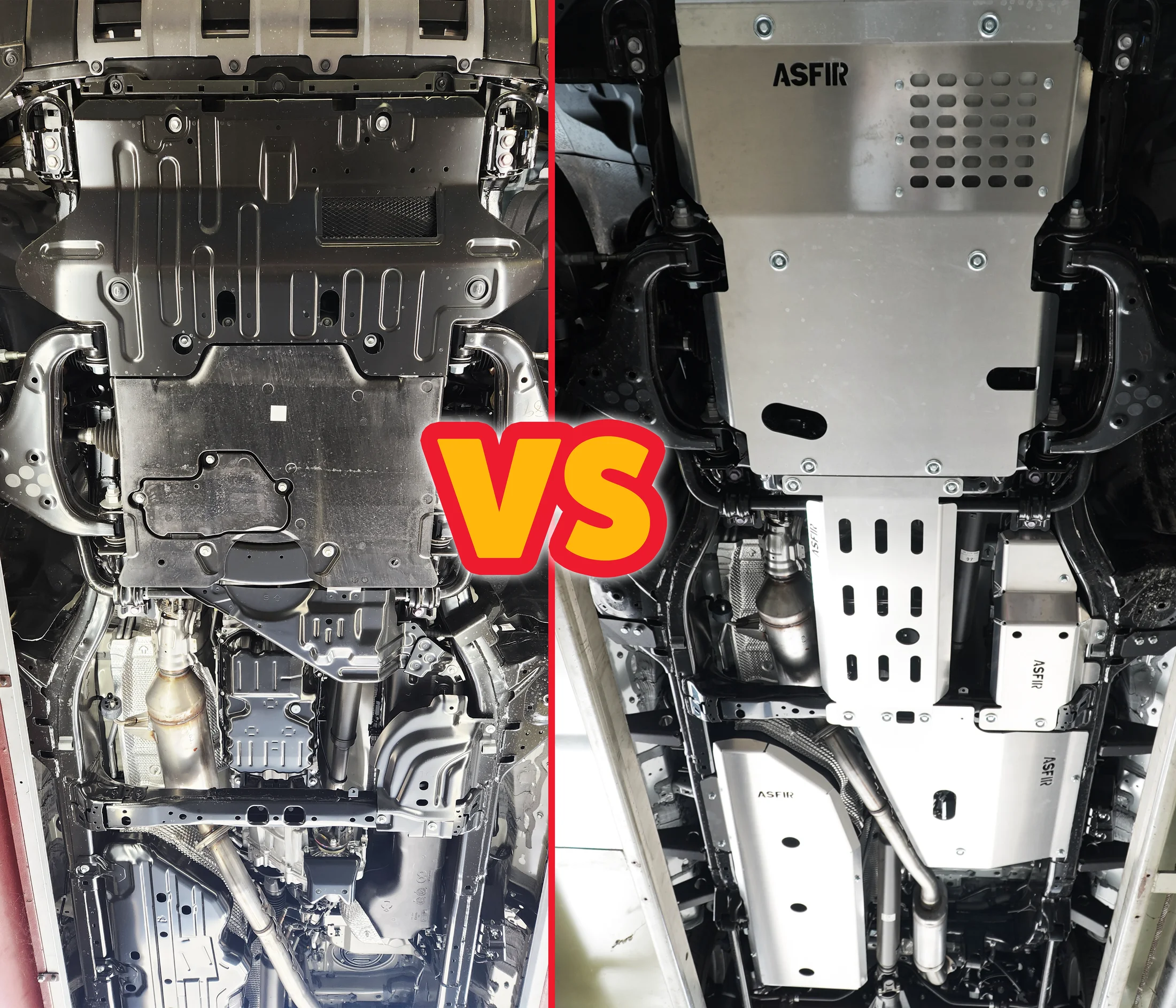

Do you guys armor up your ride?
What’s your take on aluminum vs. steel skid plates?
In the pic: a LC250 rocking our aluminum skid plates.
On the future mod list for sure have to save up for awhile
why didn't you make an oil filter and oil drain plug access?
Does the engine skid have slotted mounts?
thats the diesel version so the oil filter is on top.
you can see in the photo there are drain points for both engine oil and front diff.
in the gasoline version there is a filter access
so the US gasoline version, we can perform oil/filter change without removing the skid plate?

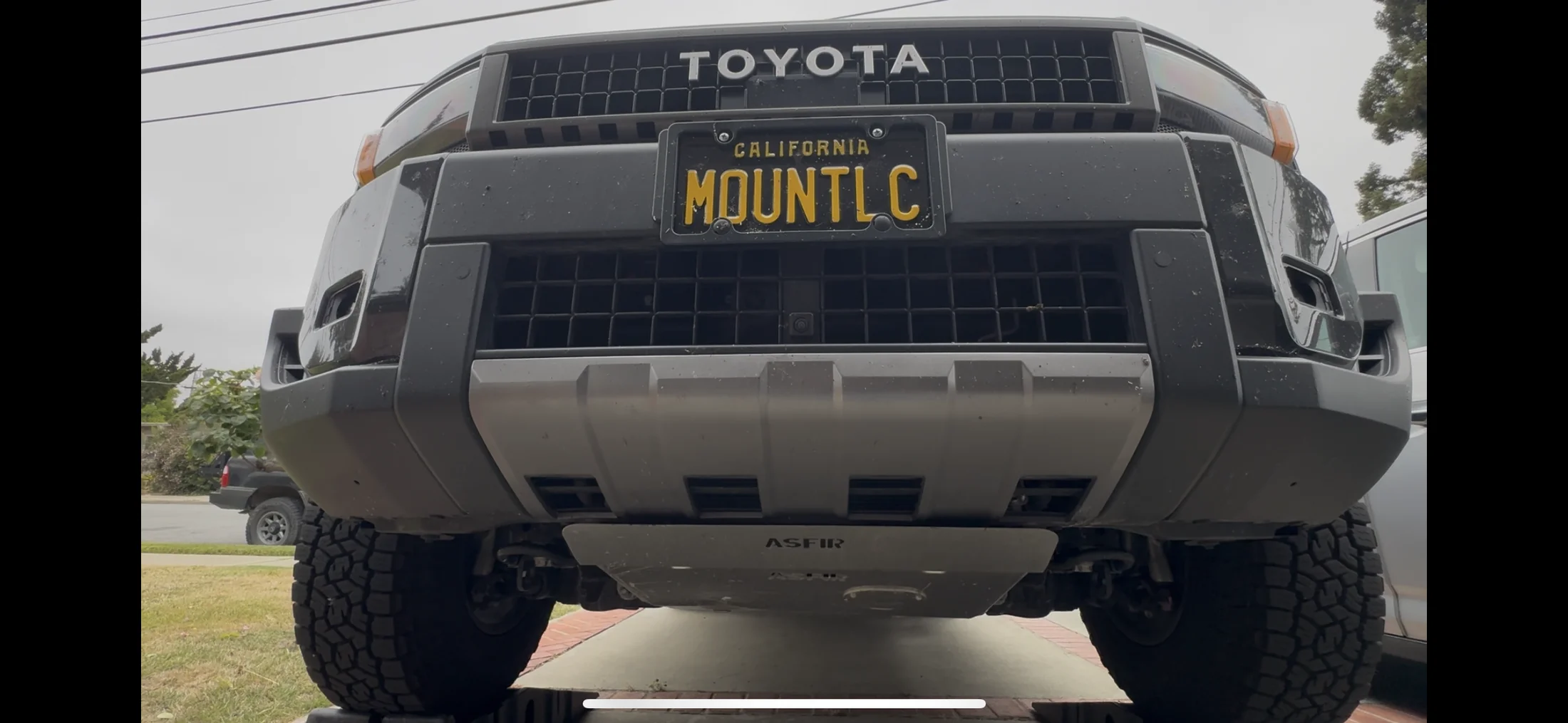

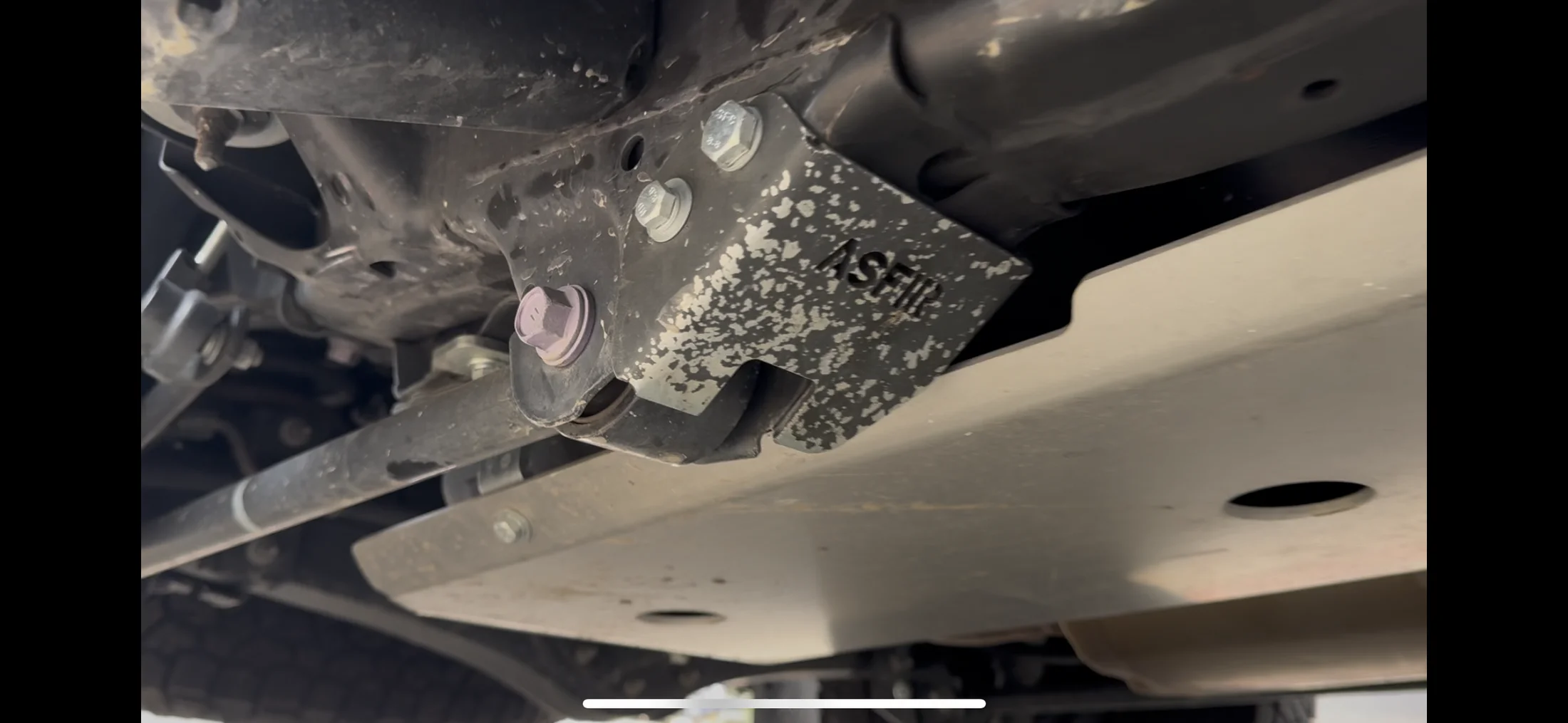

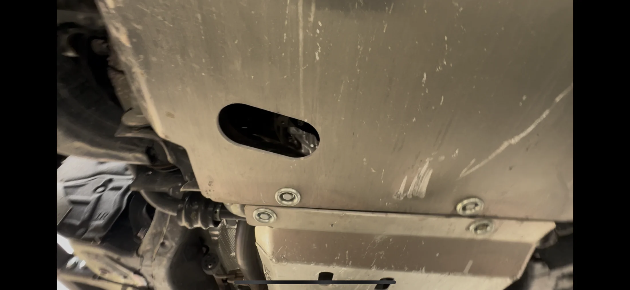

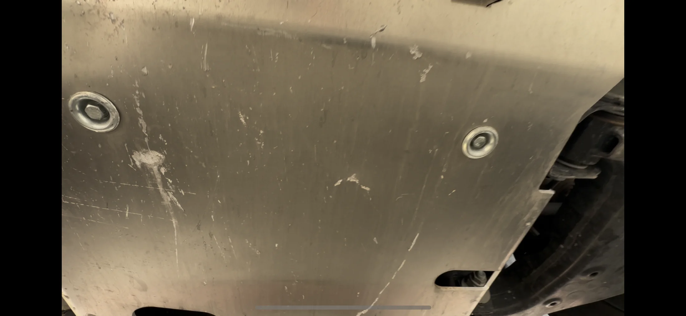

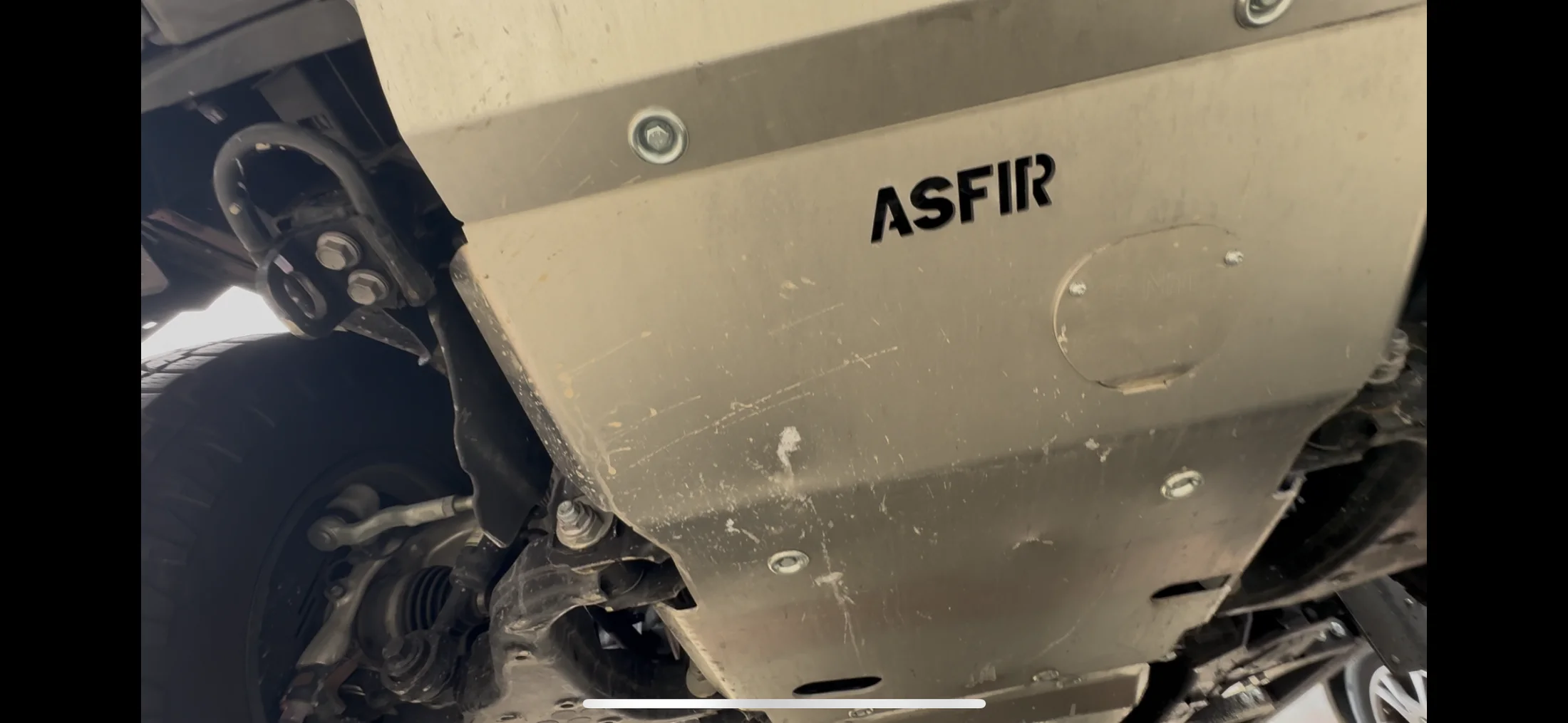

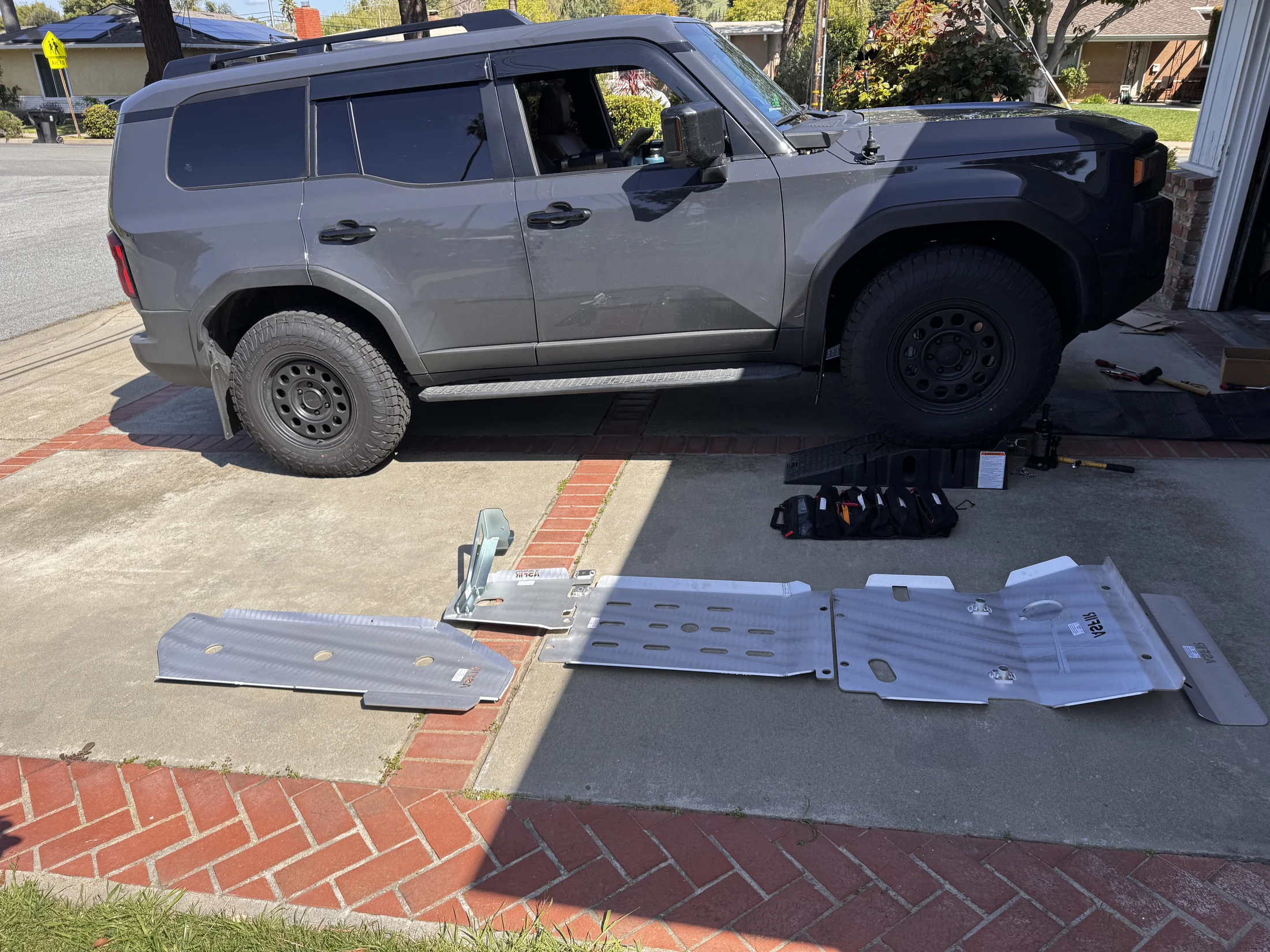

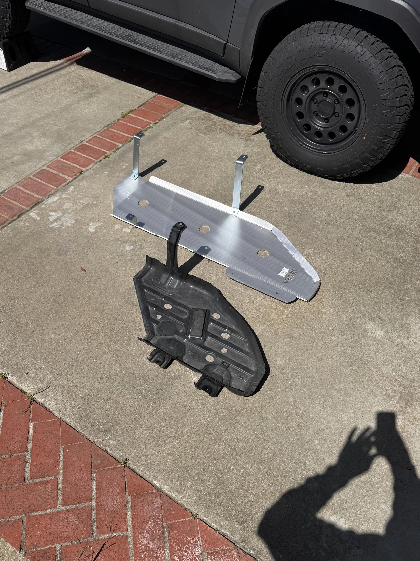

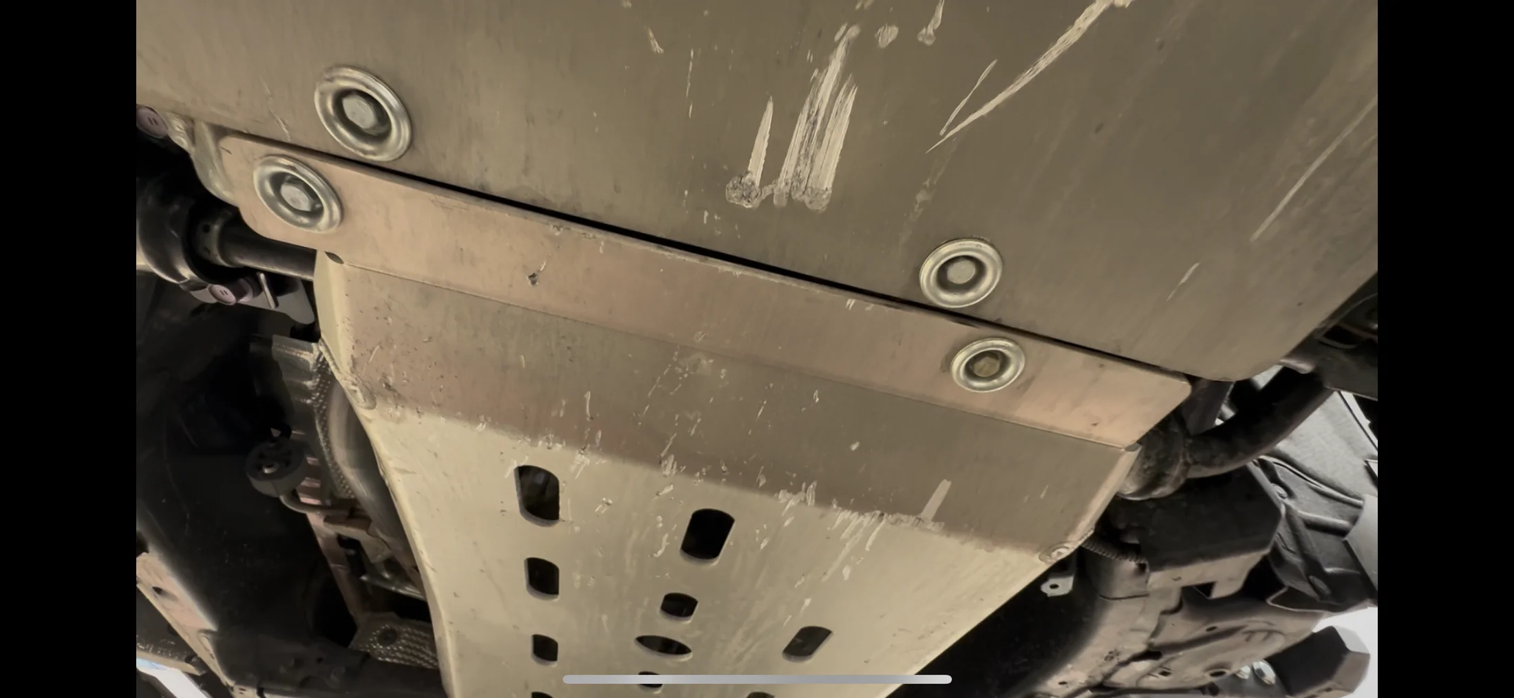

I had a really good experience with the full ASFIR skid set for the LC 250. With no lift (yet) and only a 33” tire, I knew before we went to Death Valley that we would’ve needed extra protection. Prior to DV, I bashed my stock front skid plate at Pismo Dunes, which put a good dent on the front lip. We took the truck through the usual places (Trona Pinnacles, Racetrack, Lippincott, and Saline Valley) and covered about 150miles of offroad desert washboards
I think because I had such beefy skid plates underneath the truck. I was a little bit reckless going through some of the rocky areas, hence there are so many dents on the underside of the truck. Through Lippincott, they got rid of a lot of the rock gardens so I didn’t get a chance to use the sliders this time. These good place definitely saved my underside. Otherwise the damage would have been much worse with the fully loaded truck at probably 7 1/2 inches of clearance in the back. I would say, if you are going to do any sort of offloading as good plates are one of the best in the business with full coverage throughout.
Full disclosure: I reached out to Asfir before my trip and they were gracious enough to let me use their skid plates for the LC250. I have a set of front ski plates from Asfir on my 100-series and have been really happy with the beefiness since, that’s why I reached out to them.

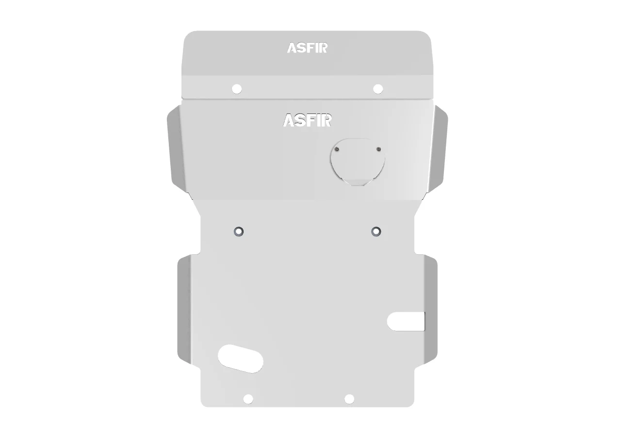

absolutely! heres a photo from our website of the gasoline version.
you can see the engine oil, filter and diff oil

Could you clarify whether your skid plate mounts at the original radiator support location, or if it attaches elsewhere - such as frame or recovery points? If it uses the radiator support, what reinforcements are in place to prevent damage to the radiator?
Yep, our skid plate uses the same radiator support brackets as the factory plate, so it bolts up just like OEM. The stock skid plate connects there too, so it’s a proven mounting point.
That said, the best “protection” in the trail is always smart driving, picking your lines and avoiding smashing into big rocks or ledges. No matter what brand of skid plate you have, if you slam it hard enough, something’s gonna give.
In fact this isn’t a proven location. Other manufacturers have noted the extreme damage that can come from mounting at this location, and have thus designed their products to mount elsewhere (such as on the recovery points). This puts your product out of consideration.
