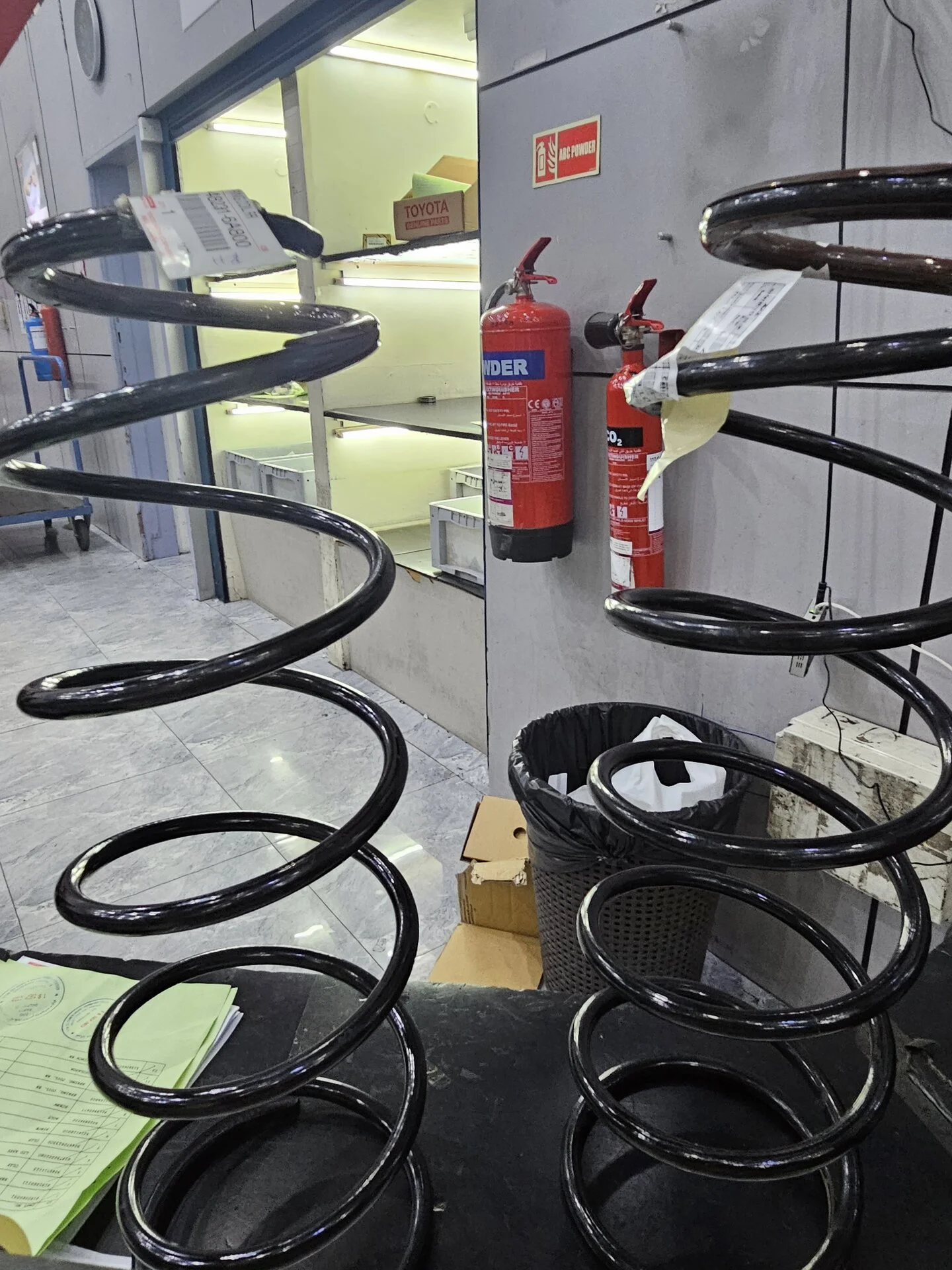

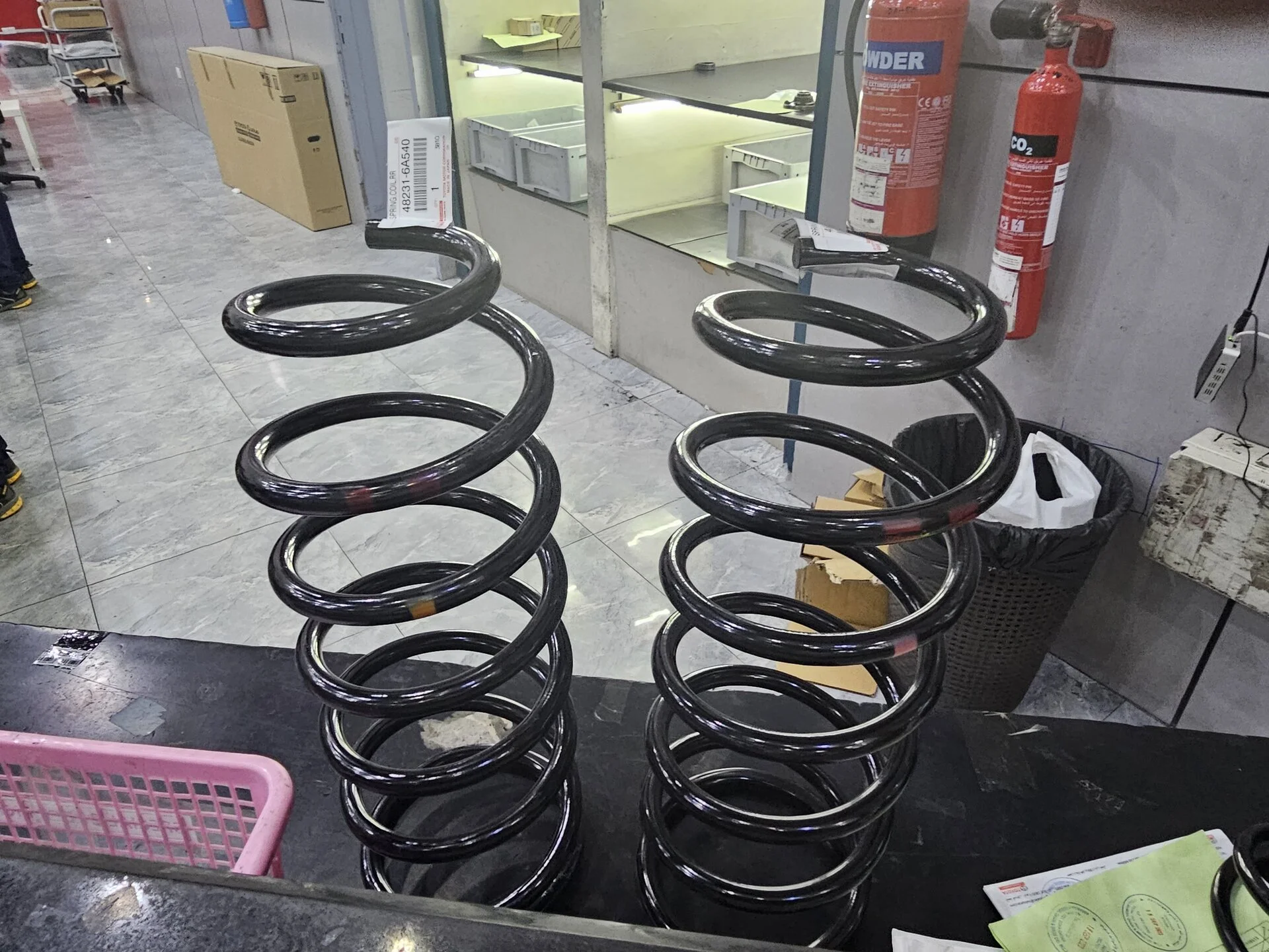

So we are looking for replacement rear springs for a non ahc uzj lc100 with two spare tyres.

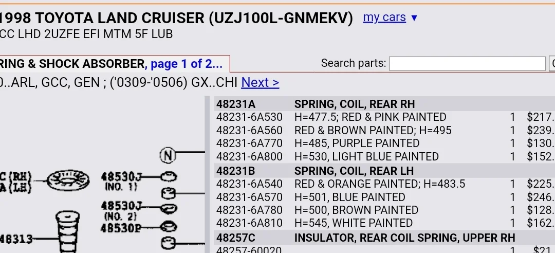

On toyota diy
I get this list of springs
Looking at the ones that end in 800 / 810 to be specific
The tallest ones (which are usually supposed to be the ones for the dual spare versions)
We found them at the dealer
My friend says these may be for a vehicle with AHC? As that was also on option here..
What do you think? Do these look like springs for a vehicle with ahc.

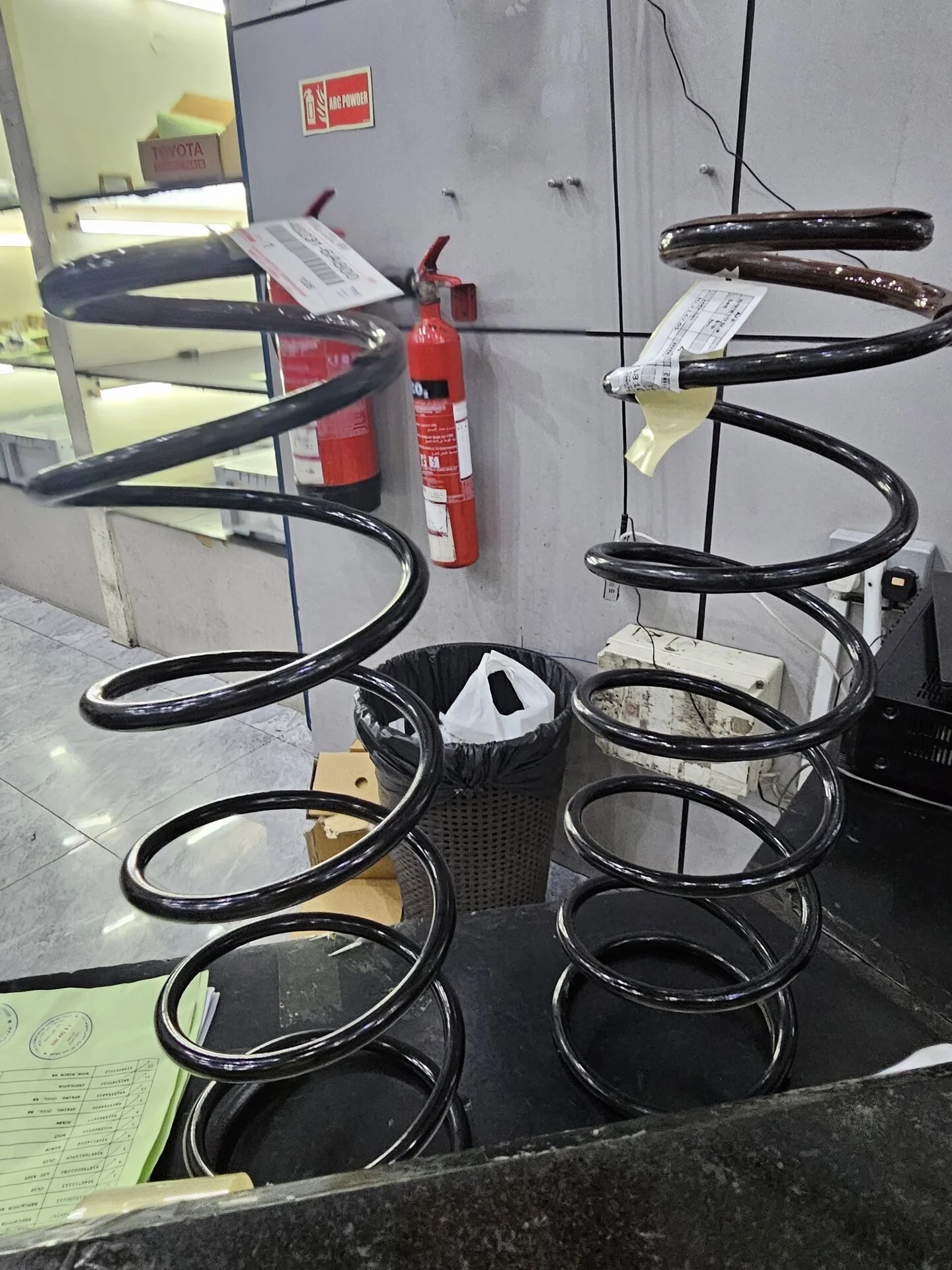

Here is another set of springs also for a uzj100 that look much thicker in comparison which makes me suspicious that the ones above are for an ahc rig.

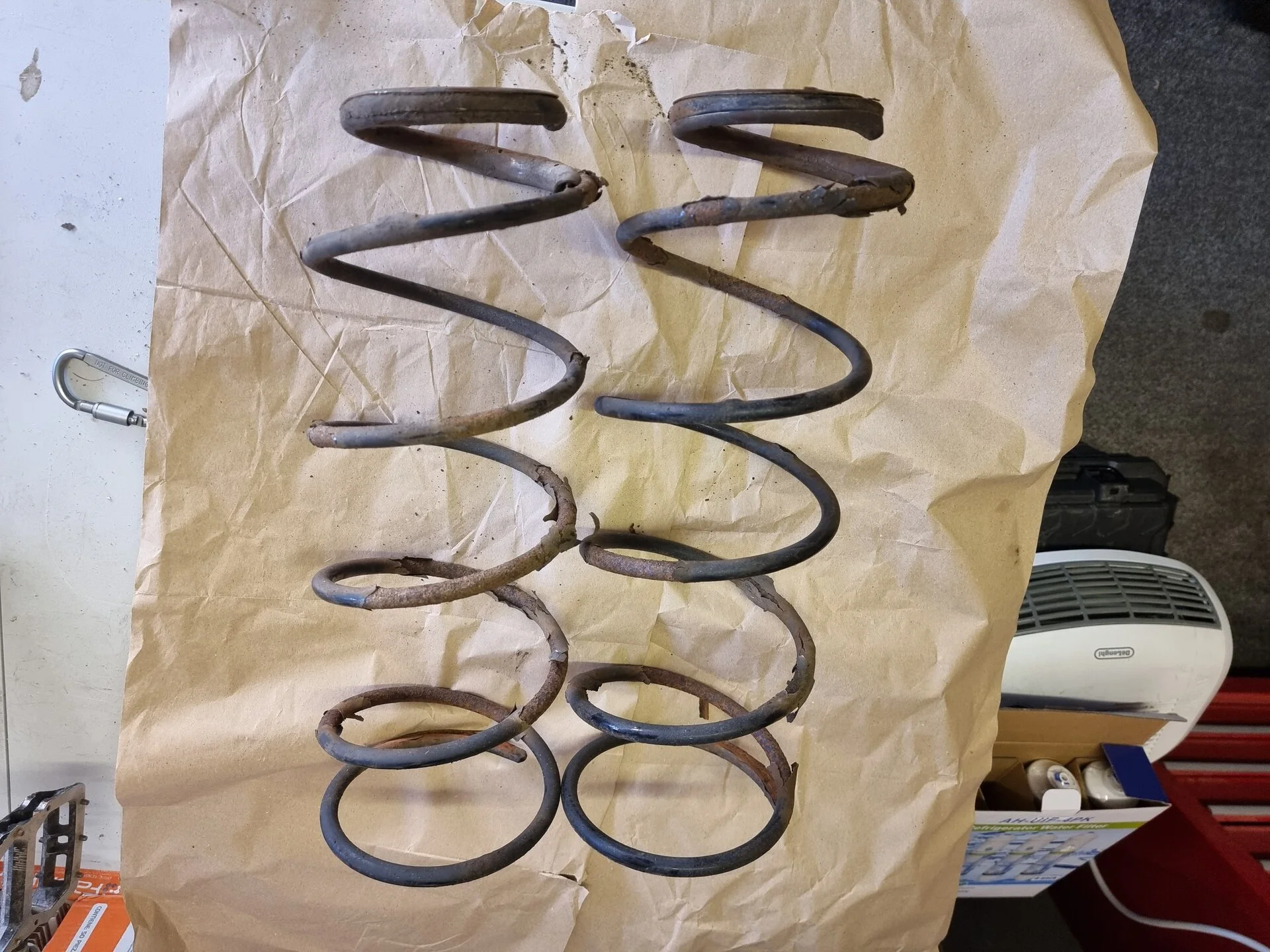

They look very similar to the AHC springs I just removed, but they appear to have an extra coil vs what I have here (mine was a diesel AHC car). It's making my eyes go crossed trying to count - so here's a picture of my 100% AHC springs currently on my floor:
Thanks @Viio, turns out they are AHC springs indeed
I have managed to deduce that atleast in the case of GCC SPEC part numbers, springs that end in 7## or 8## are AHC springs. When you see them in real life it would be very obvious but I just had to make sure
So if anyone ever reads this in the future and you're looking for new OE springs for your GCC spec UZJ100 LC100, atleast now you know the part numbers of NON AHC and AHC springs.
