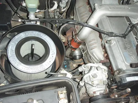

I'm pretty sure they both use the same configuration of the Landcruiser CT26 turbo. I'm sure someone else will have a definitive answer. Here is a pic of the OEM turbo on my old 1997 1HD-FT powered beast. :)

I'm talking about minor differences between 1HD-T and 1HD-FT CT26 .. on the FTE engine total different story ..
This proved to me that your statement is WRONG. FTE does not comes with CT26 from factory, for sure. CT26 is till FT only. FTE is upgraded to a bearing turbo.

That auction shows a CT26 off a 1HD-FTE. No surprises there. They are not ball bearing.
The CT26 is a range of turbos used on landcruiser, supra's and a whole lot of other toyotas. The housings and flanges vary as there is not one turbo known as a CT26.
