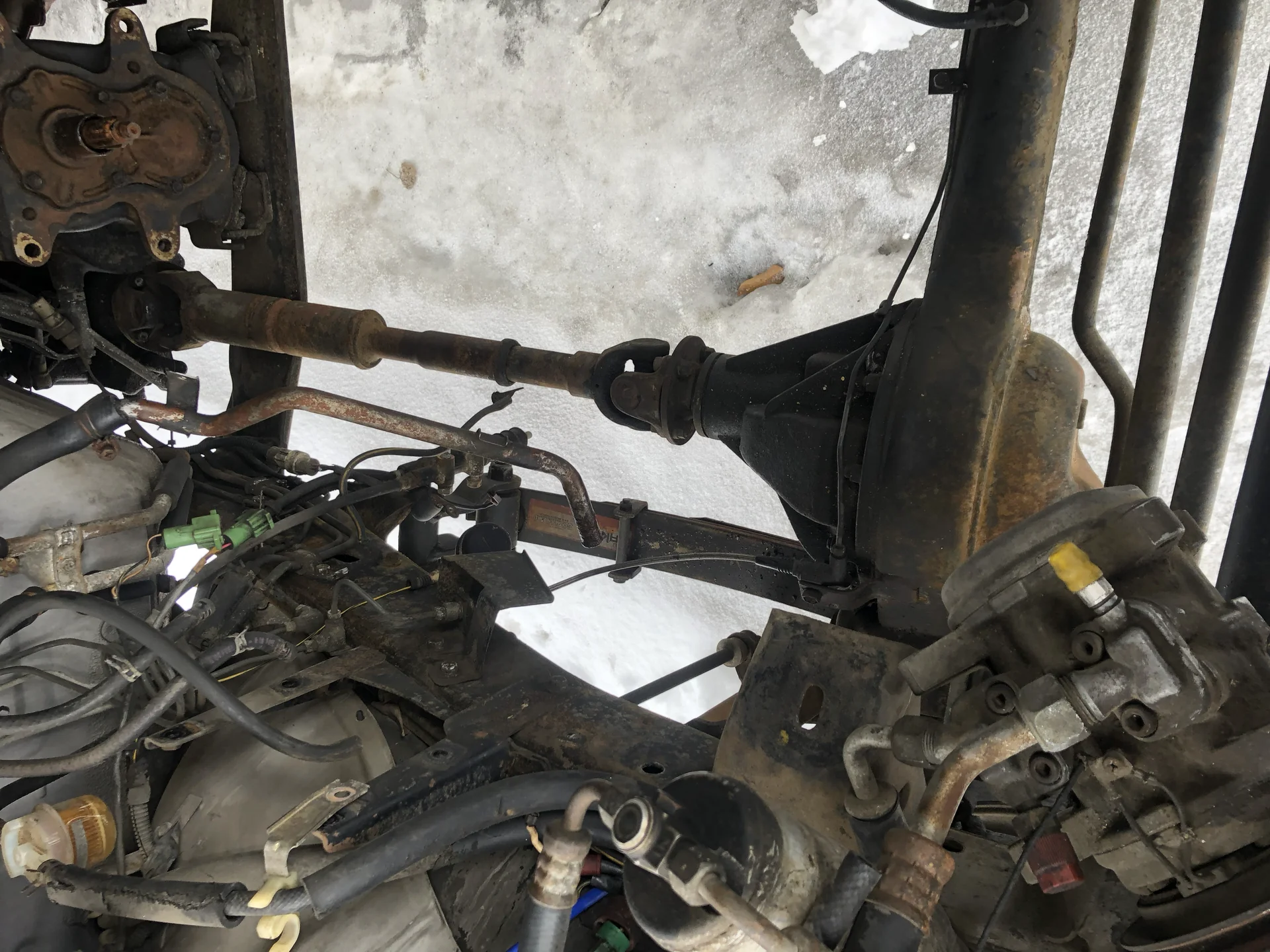

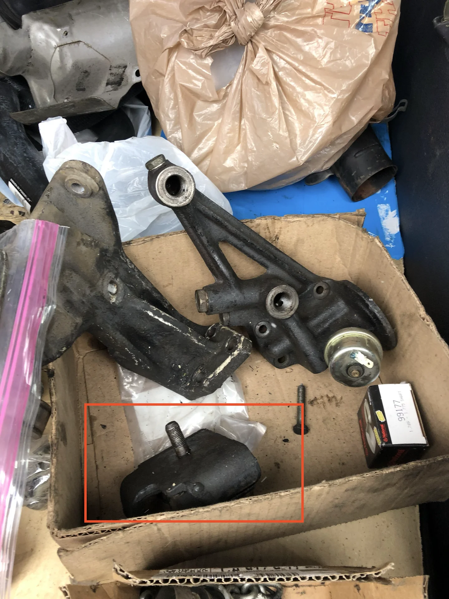

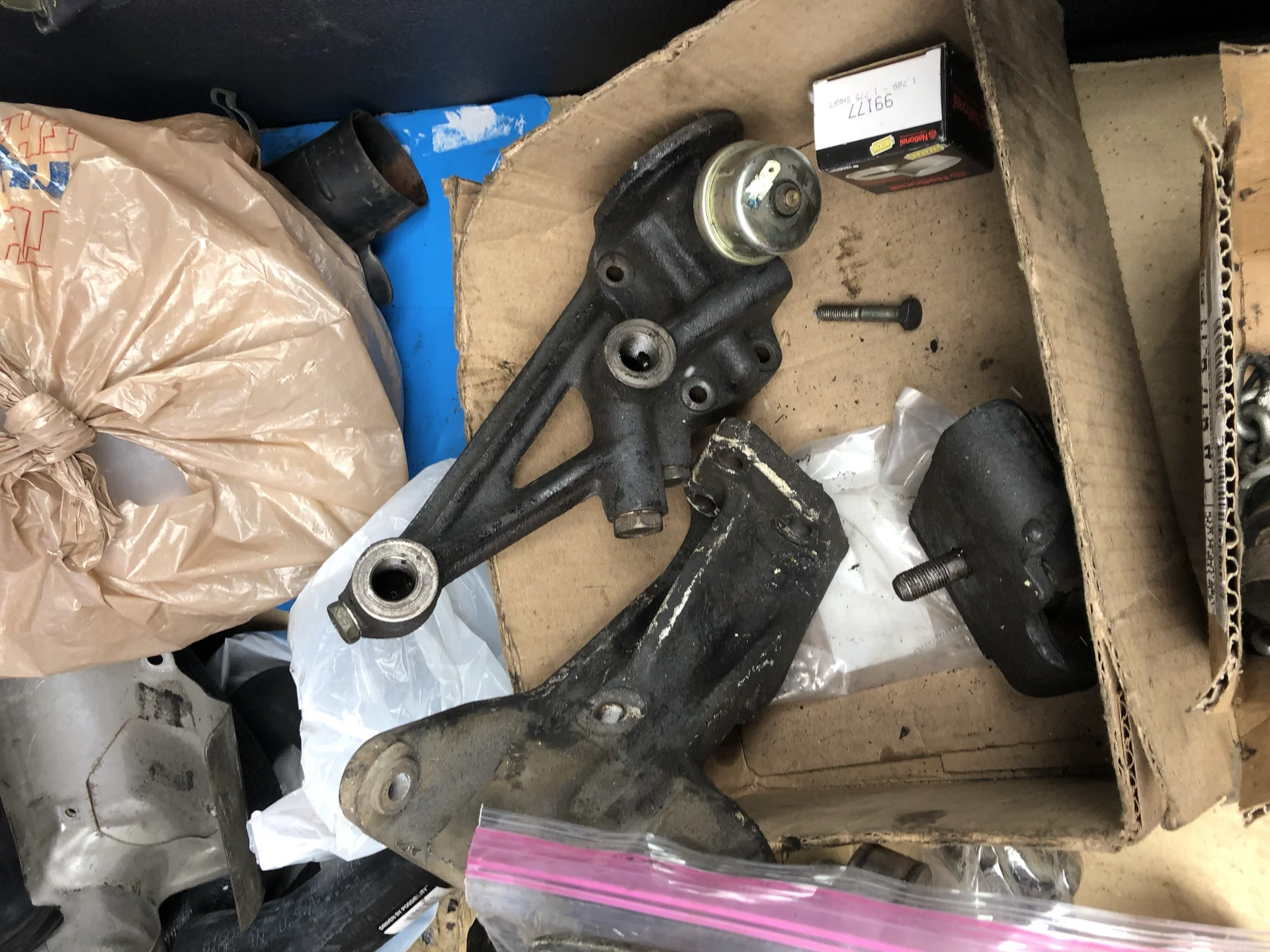

Moved a project and wasn't the one who took this motor out. The mechanic left one mounts in the rig and one in a box as shown in the photo below.

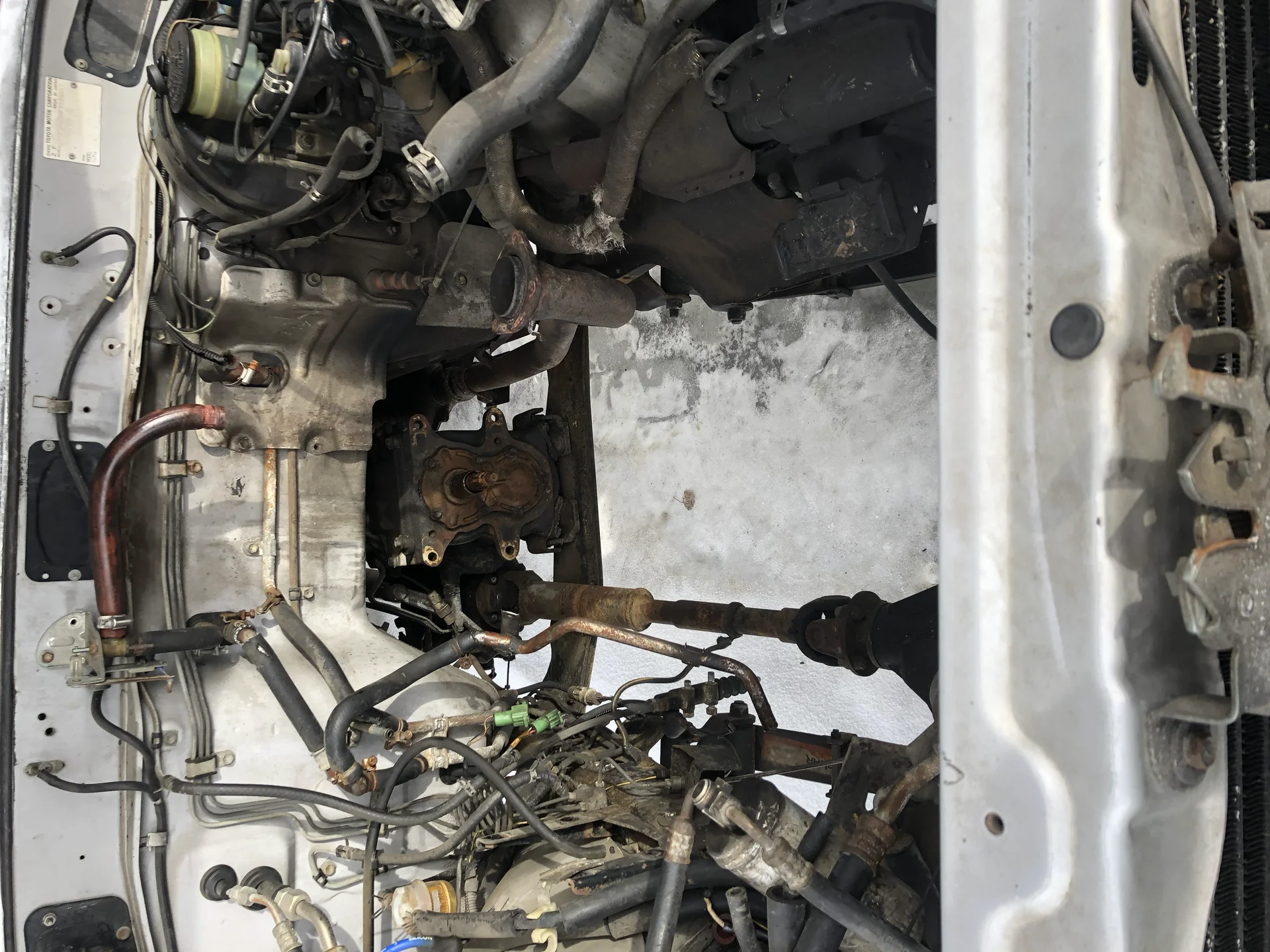

I want to make sure I have what I need mounting wise to put the engine in. Also, the rear mount seems to be at an angle, along with the transfer case. Its pointing slightly right and angled right as well.
(I'm also aware the driveshaft is grinding on the frame, I found out the other day. It's from the lift the PO put on, only driven this rig a few months before engine rebuild.)
Anyway, is anything additionally needed, do the mounts look good, and is it okay the transfer case is at an angle like this?

I see a torn driver’s side mount and no passenger side.

the a/c mount is the passenger side mount on the engine
do you have the short driver side mount?
I explained the trans/transfer issue in your other thread about the driveshaft
you probably want to change the trans mount along with both front mounts/isolators

Is this not the short driver side mount?
that is 1 of the front isolators/mount
the one still attached to the frame is half of the one circled, as it is broken which happens as all the torque pulls up on the driver side mount

I would recommend new engine mounts and a new transmission mount. We keep them all in stock
