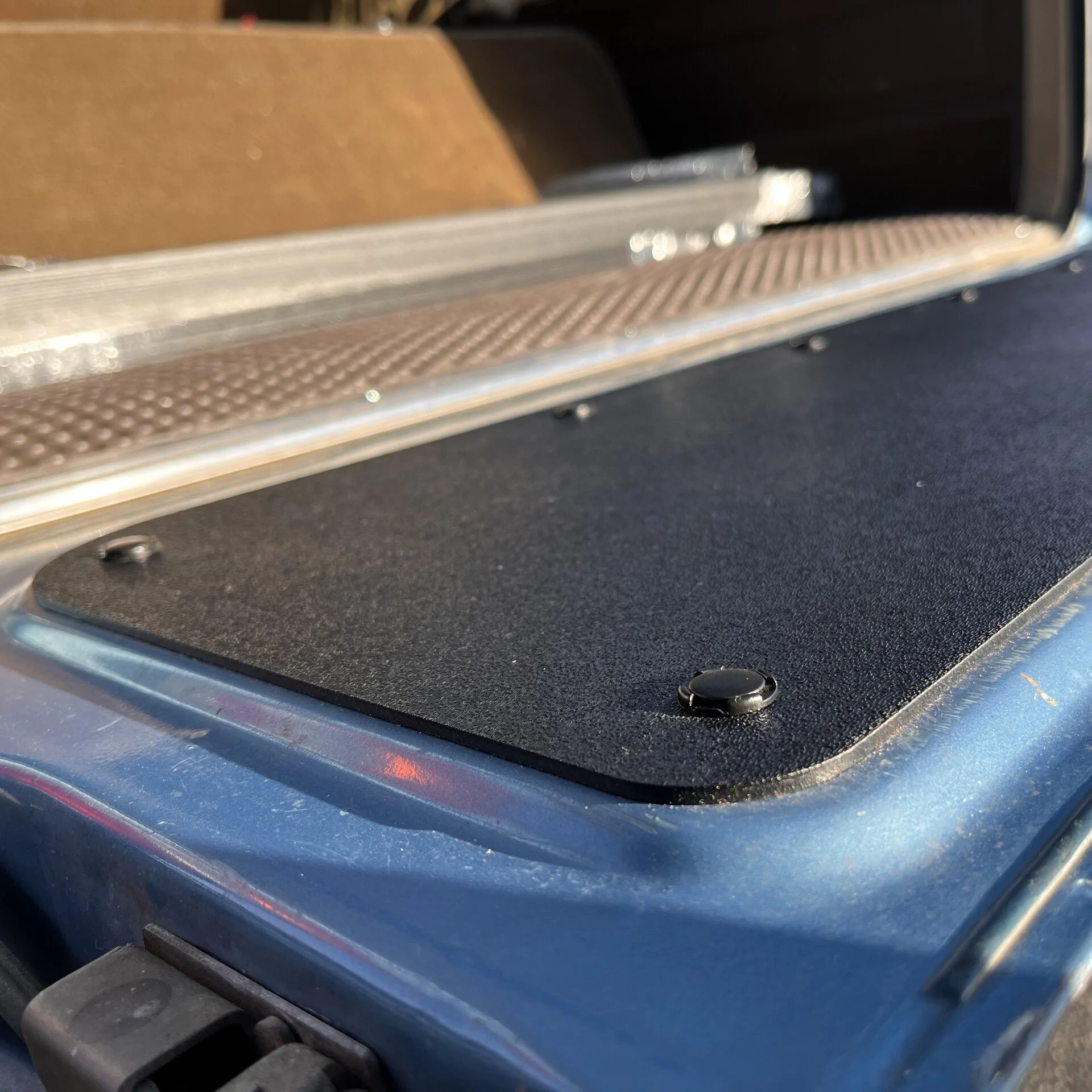

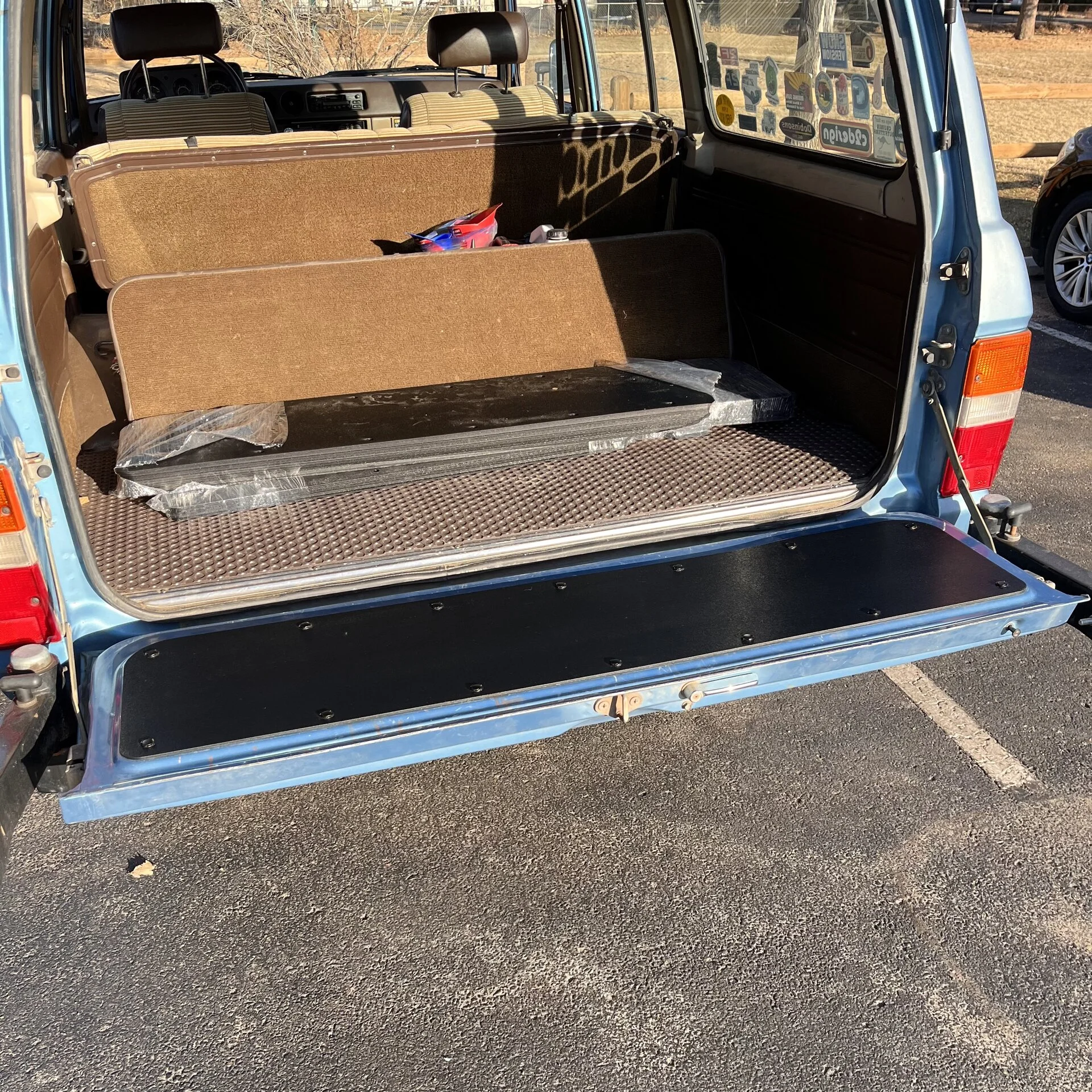

For what it's worth - and I don't know if your original panel is trashed or not - I make a laser cut ABS replacement for the tailgate panel. Installation takes about 10 minutes tops. Just throwing it out there. Let me know if you're interested, I'm happy to get your more info and more photos.
