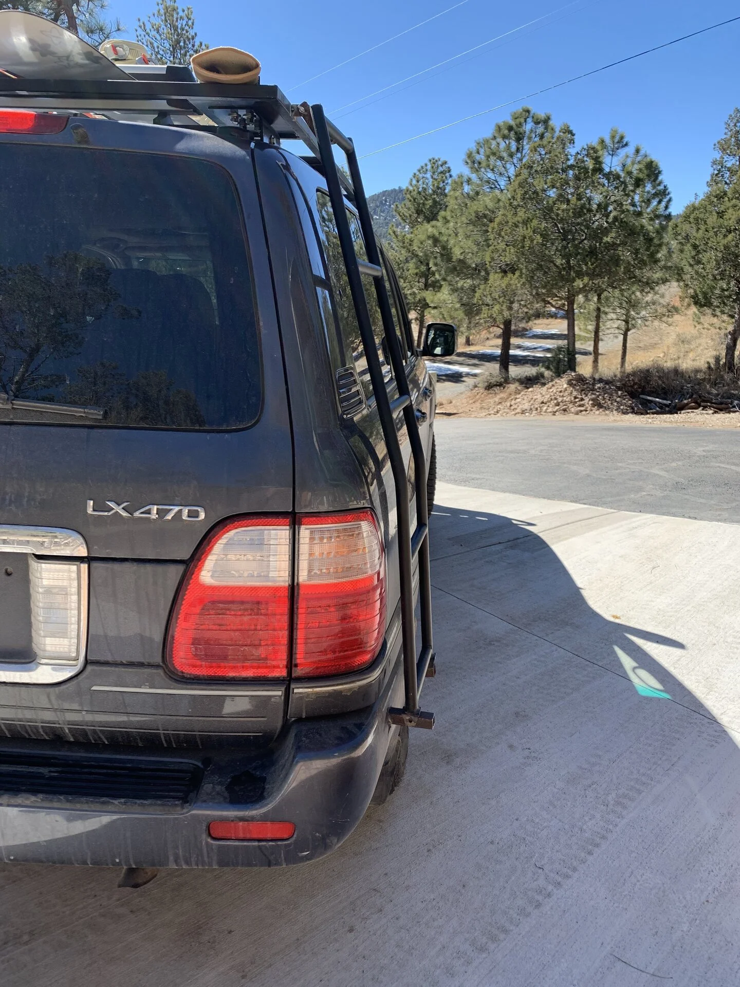

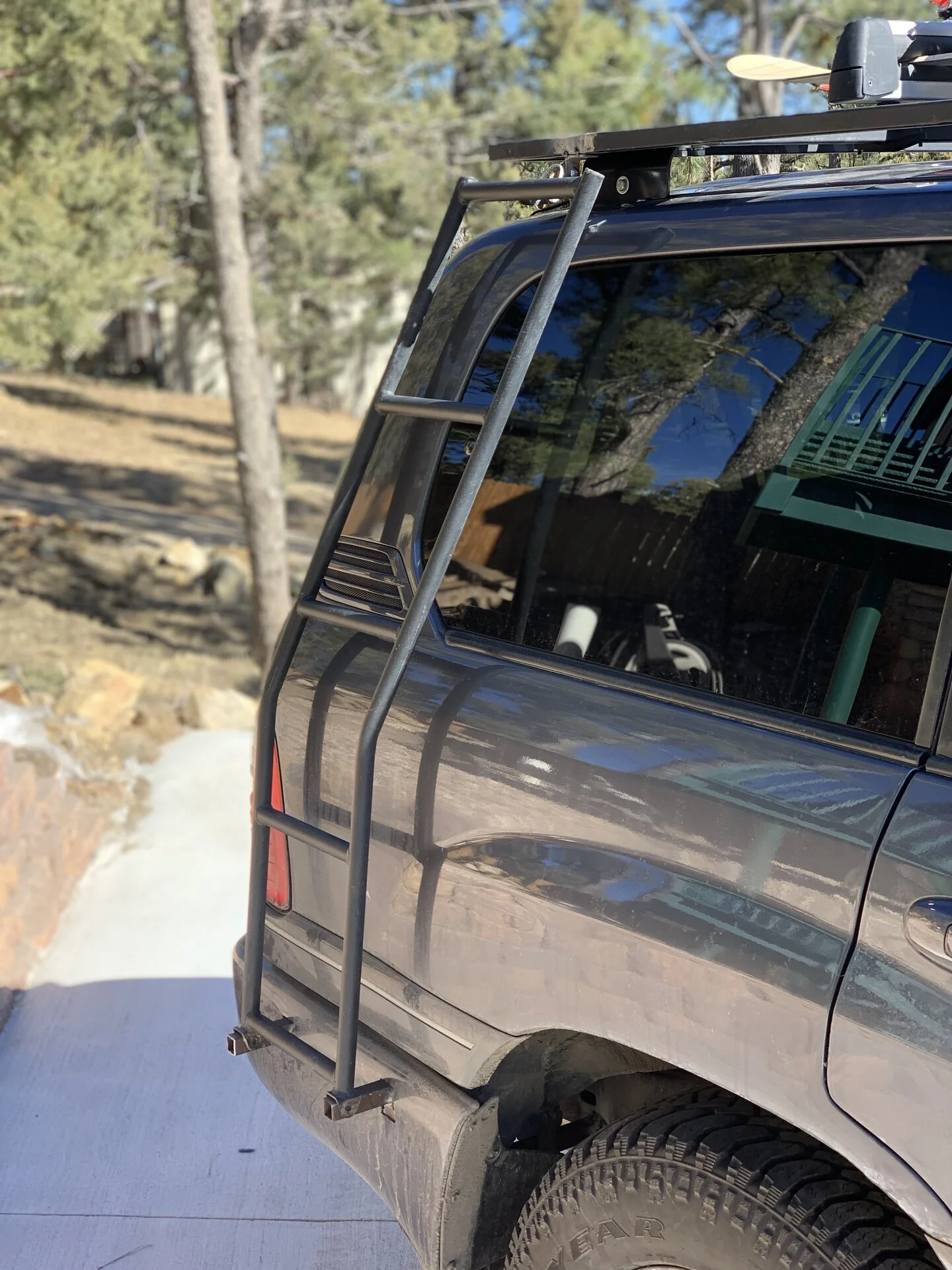

Thank you thank you thank you @saucebox. I drilled/cut holes in my bumper, fabricated a couple brackets, and welded them to the frame. Welded a little bracket to my roof rack for the hinge piece. Still need to weld one more reinforcement to the forward bracket, and tidy up and paint all the parts. gamiviti ladders are real nice @nakman.
Progress pic:
Thank you thank you thank you @saucebox. I drilled/cut holes in my bumper, fabricated a couple brackets, and welded them to the frame. Welded a little bracket to my roof rack for the hinge piece. Still need to weld one more reinforcement to the forward bracket, and tidy up and paint all the parts. @gamiviti ladders are real nice.
Progress pic:

@banjo1981, do you have any photos of the brackets from inside the bumper? Is it basically square tube that extends from the frame through the stock bumper?
Sorry for reviving the dormant thread, but I'm interested in doing something similar.
Here you go. It’s not pretty, but it’s strong enough for me. There are other ways to do this, like maybe do two pieces. One whole assembly behind the bumper with a plate then add a plate on the outside that bolts to the inside. I don’t know, but this is working well for me.
