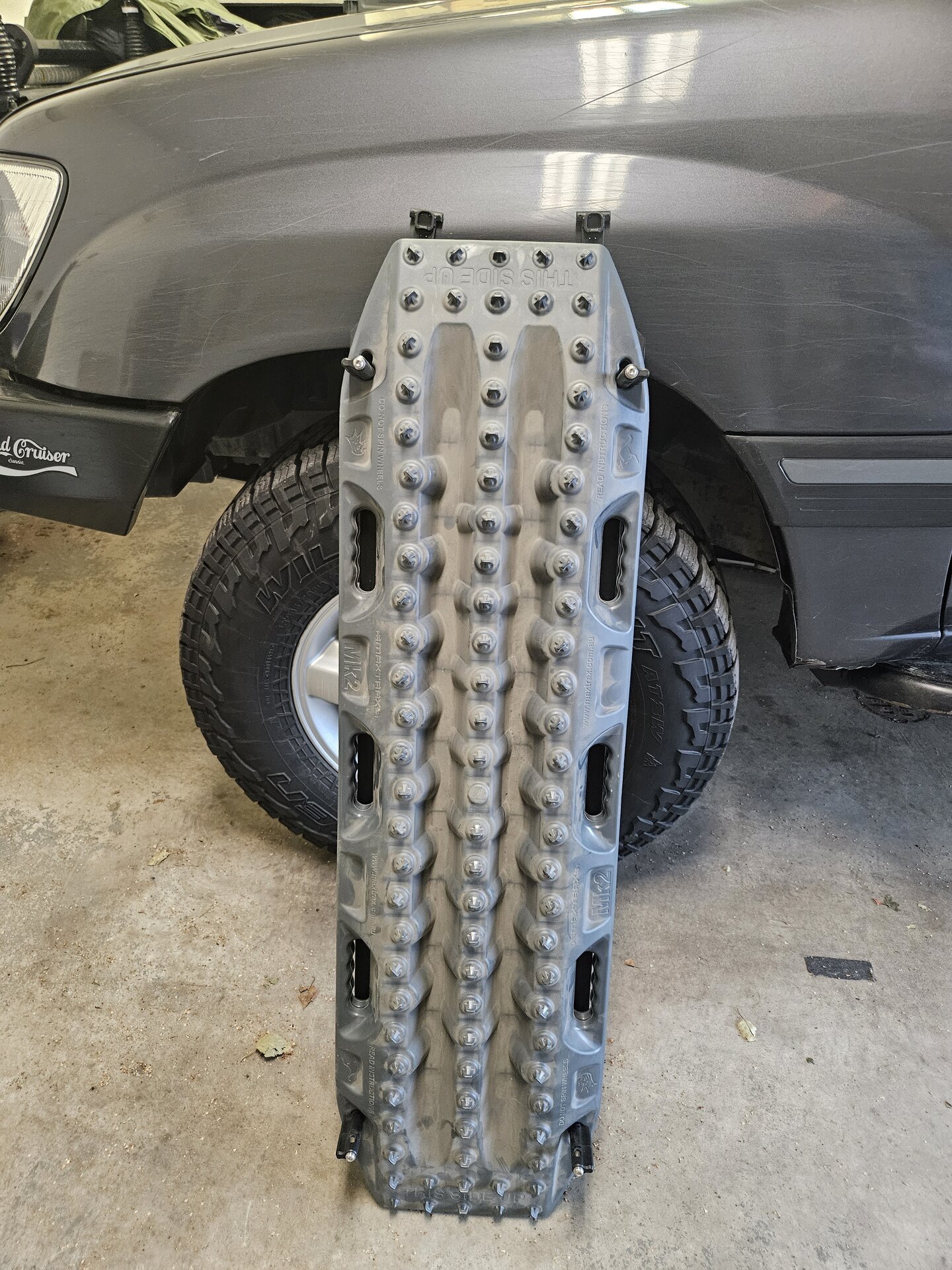

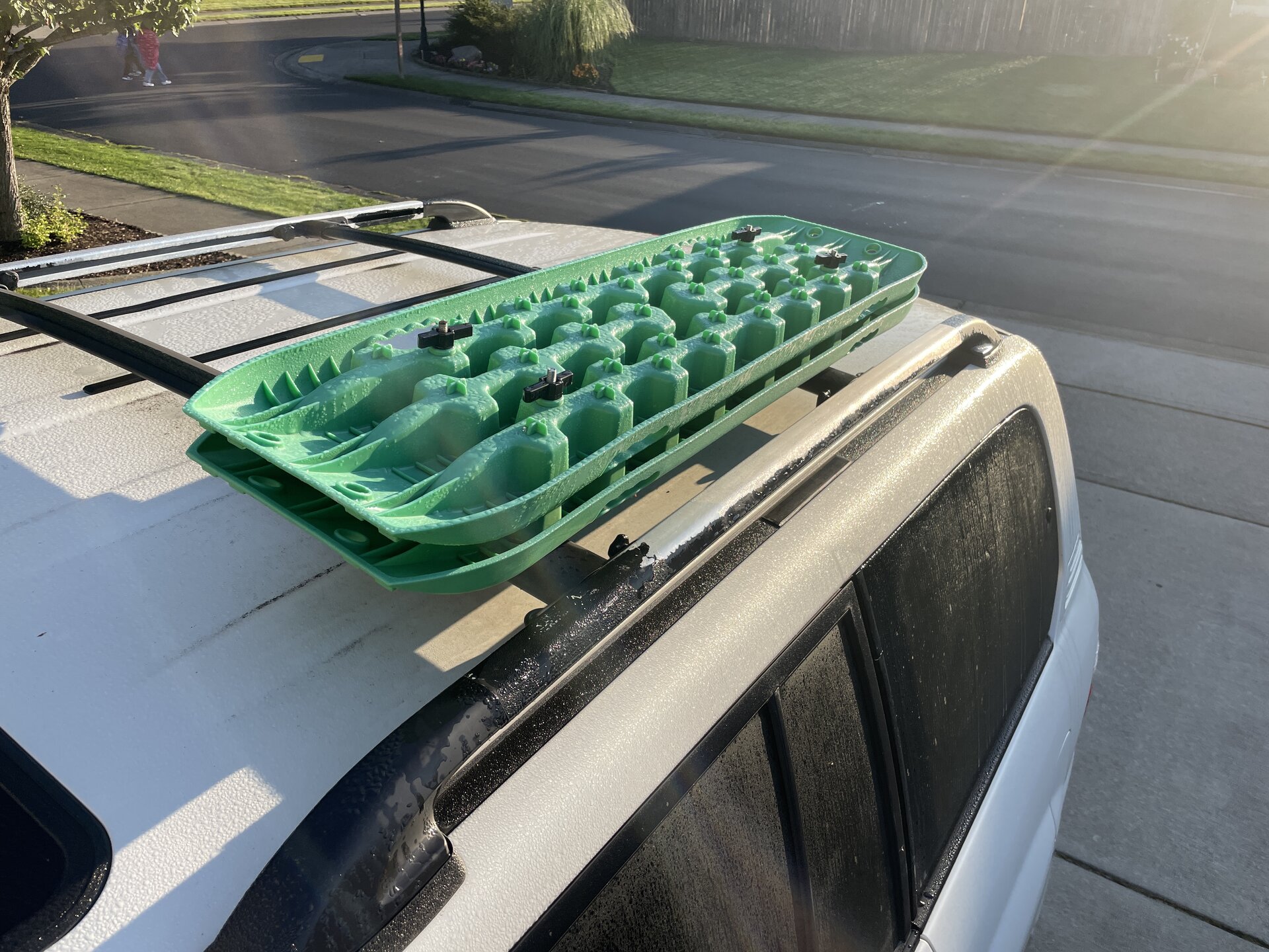

Needed a way to mount them on my roof, it's the most logical real estate for me given my setup. Fits right between my skinny Yakima basket and my Yakima awning. And since I can barely fit the LC in my garage, all things mounted to my roof need to be quickly removable.
So here's my overpriced DIY solution.

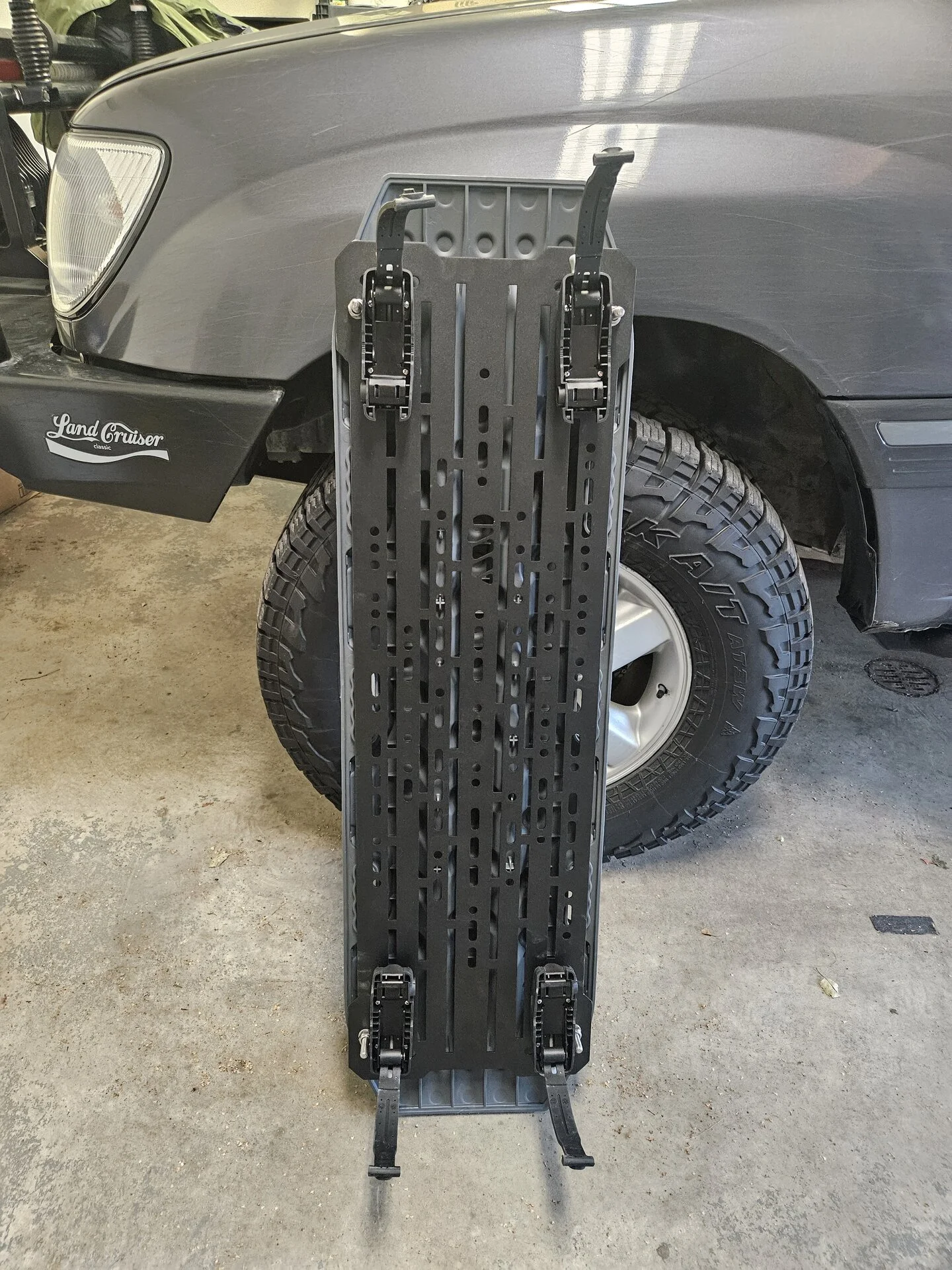

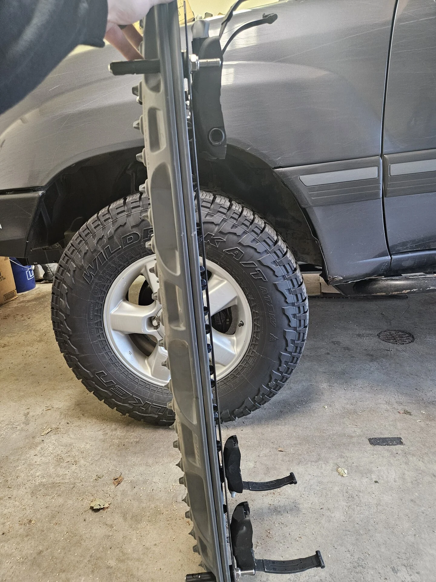

1x Warrior Products one piece mount (Warrior Products MAXTRAX & RotopaX Mount System - https://www.quadratec.com/p/warrior-products/full-maxtrax-rotopax-mount-system)

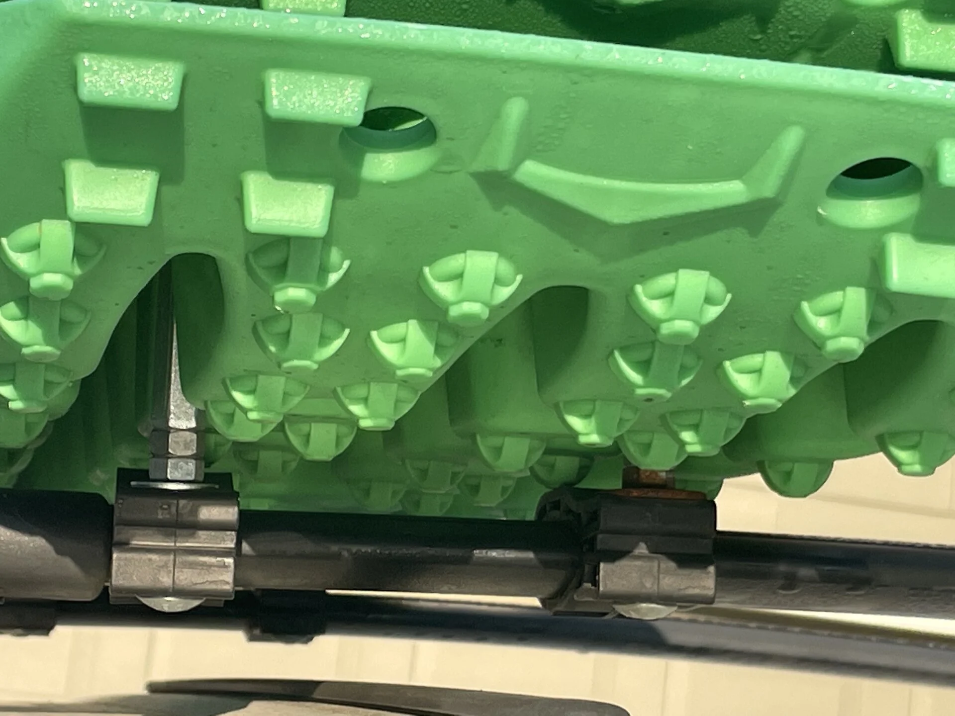

4x Thule replacement crossbar clamps (https://www.etrailer.com/Accessories-and-Parts/Thule/7521241001.html)
4x Maxtrax pins from a friend, shoutout Nic Cardin
The Thule clamps are easy to secure to the crossbars which is what I wanted. They have one 6mm thread coming out the top of each clamp, which I put a washer and lock nut on the other side of. I like the full length one piece Warrior Products mount because if I had the two piece board mounts, I'd have to line up the front cross bar mount with the rear crossbar mount each time I put it on. This is probably a pretty overpriced way to mount them, but such are the sacrifices of having OEM crossbars. If you're not as lazy as me, you could probably cut some metal and do something for cheaper. But these fit my purpose, can be locked to keep honest people honest, and were quick to put together.

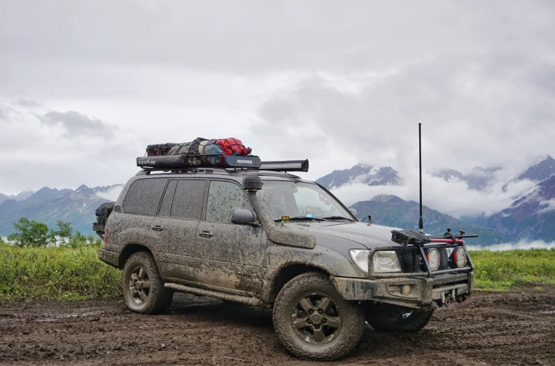

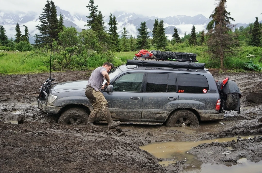

Haha, well in Alaska mud often gets on my roof anyway from my tires flinging it, so a little mud from traction boards won't hurt. See pics below. I haven't wheeled in the L48 but I'm sure it happens down there too.
