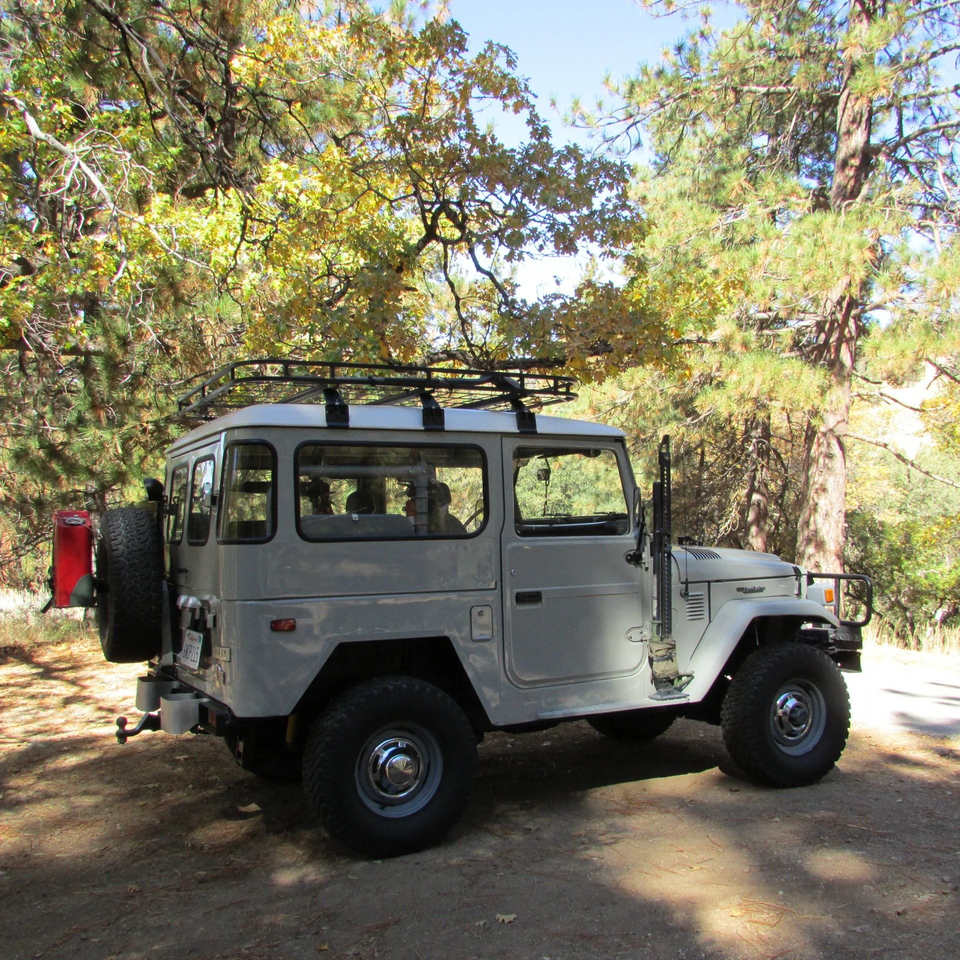

I used a 9 dollar Harbor freight spray gun, Nason single stage paint on my '40 and was happy with the results. Had I known it would turn out so good ,I would have spent more Time on the prep. Not a show car by any stretch of the imagination but Ive got a lot of compliments on the paint job.
