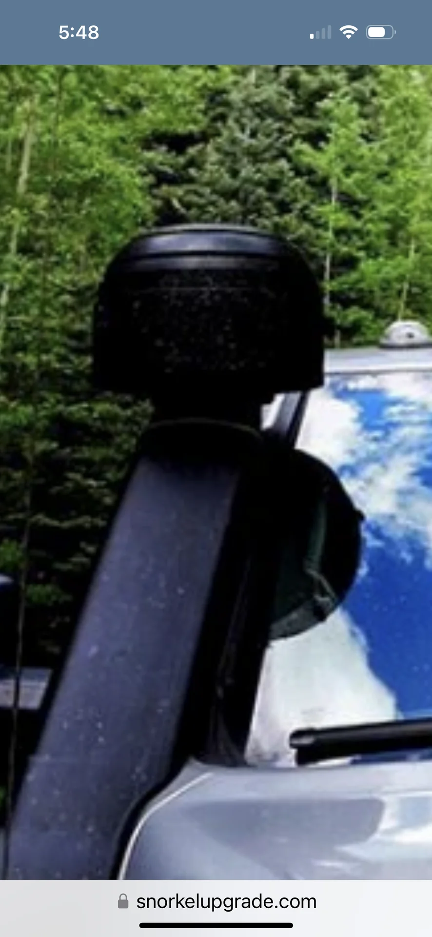

Well, the truth is that my skills just weren't good enough to leave it showing. There were so many imperfections in the surface that I had to give it a skim coat of bondo to smooth it out and make it look nice.

That might be your opinion, but if I had done something like that, I would certainly show it off! It could look like crap and I'd still be like "Hey look, I made this thing out of carbon fiber! Cool!"

Thank you for creating this thread. This has been super helpful. I guess it’s time to learn to use carbon fiber….. What wall thickness is needed with carbon fiber to support hose clamps and a pre cleaner?
