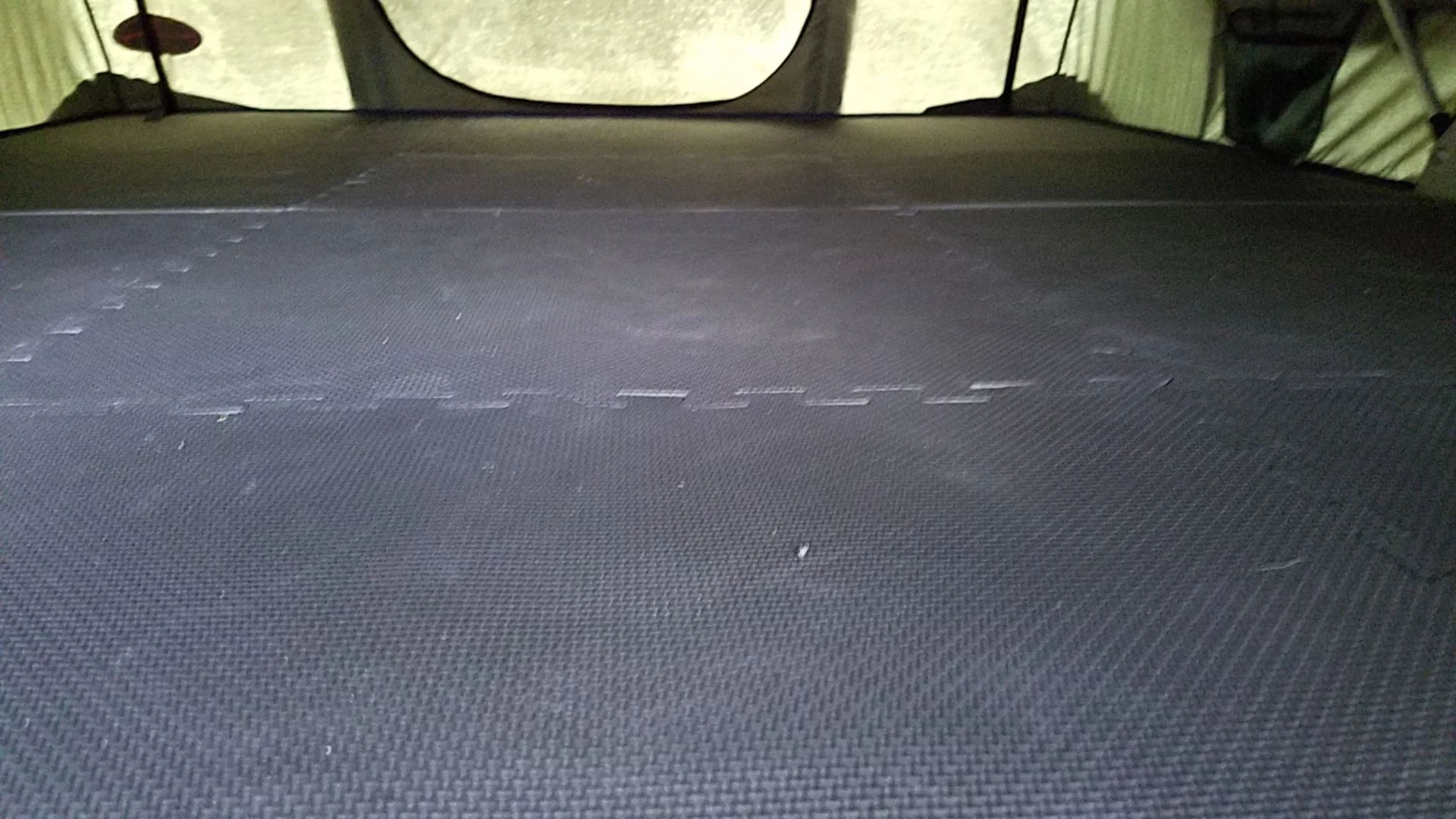

I installed the Anti-fatigue mats in the RTT for SAS #1. 4 nights in the lower 50's with rain and I had zero condensation when we packed up and closed the tent. The mat is close to 3/8" thick. I installed it with 2" wide thin double sided tape. The extra padding was welcome also.
Its worth a shot. Cost a whopping $25 and a couple hours time. Im happy with the results and the wife was comfortable after the upgrade.

After many years I am happy to report no issues and the comfort has stayed the same. It's basically the difference between being barefoot and having the cheap flip-flops on your feet. Just enough to cushion the pressure points.
As far as condensation it has done its job keeping condensation down due to insulation effect. That is all relevent to when, where and humidity while camping. It's been dry every time I close it up even after several days of afternoon rains or West Texas thunderstorms with 80mph winds.
