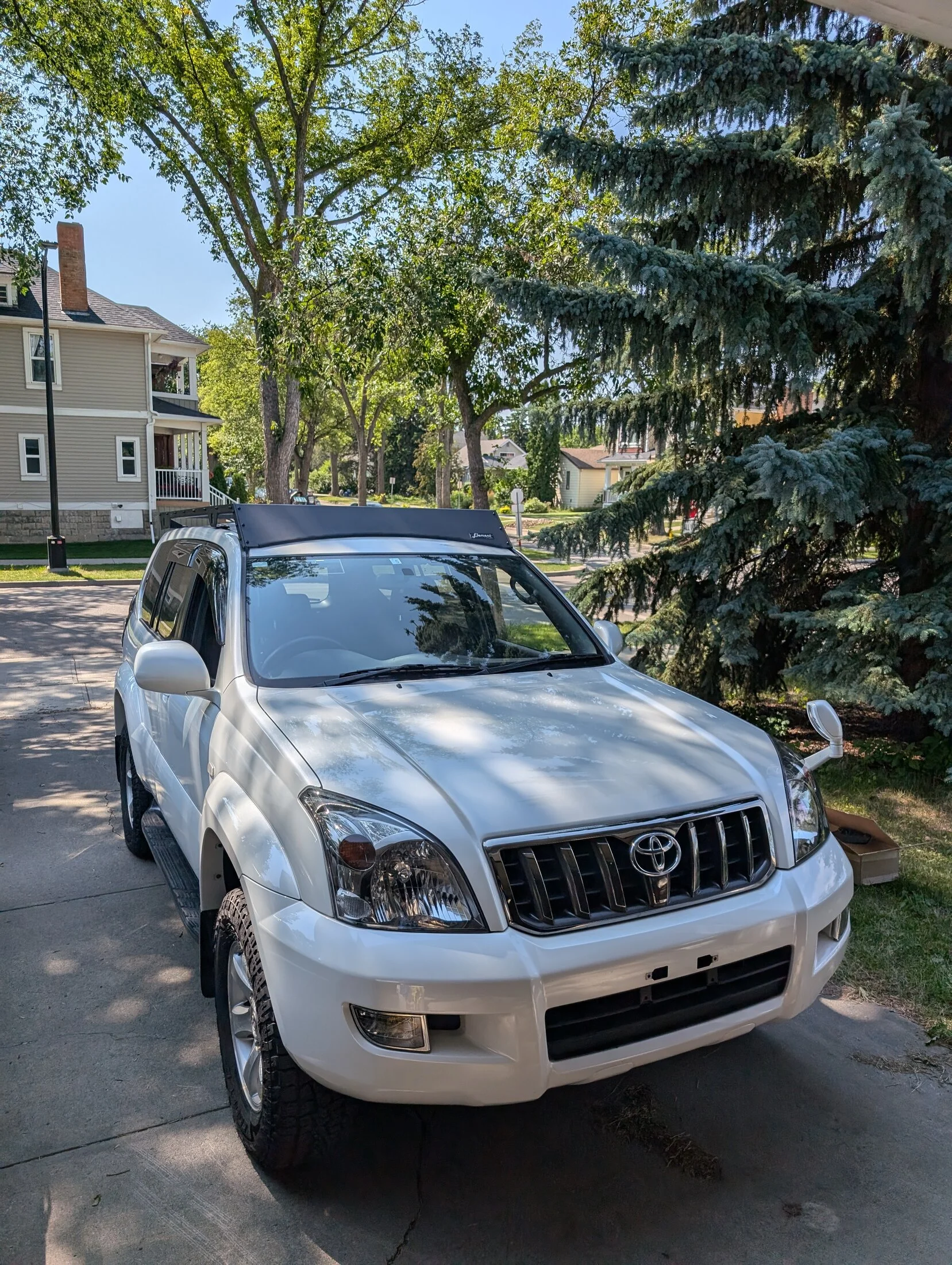

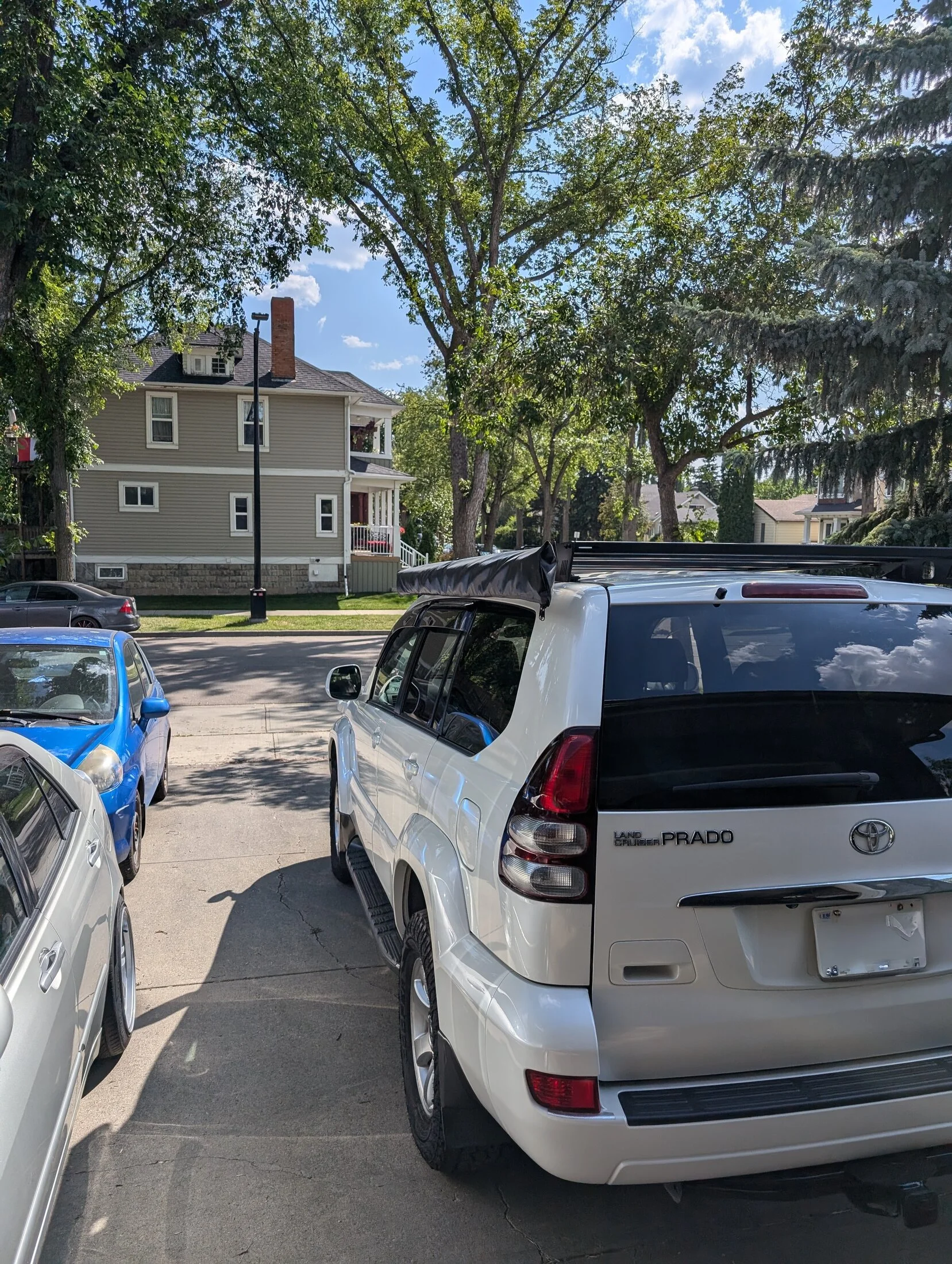

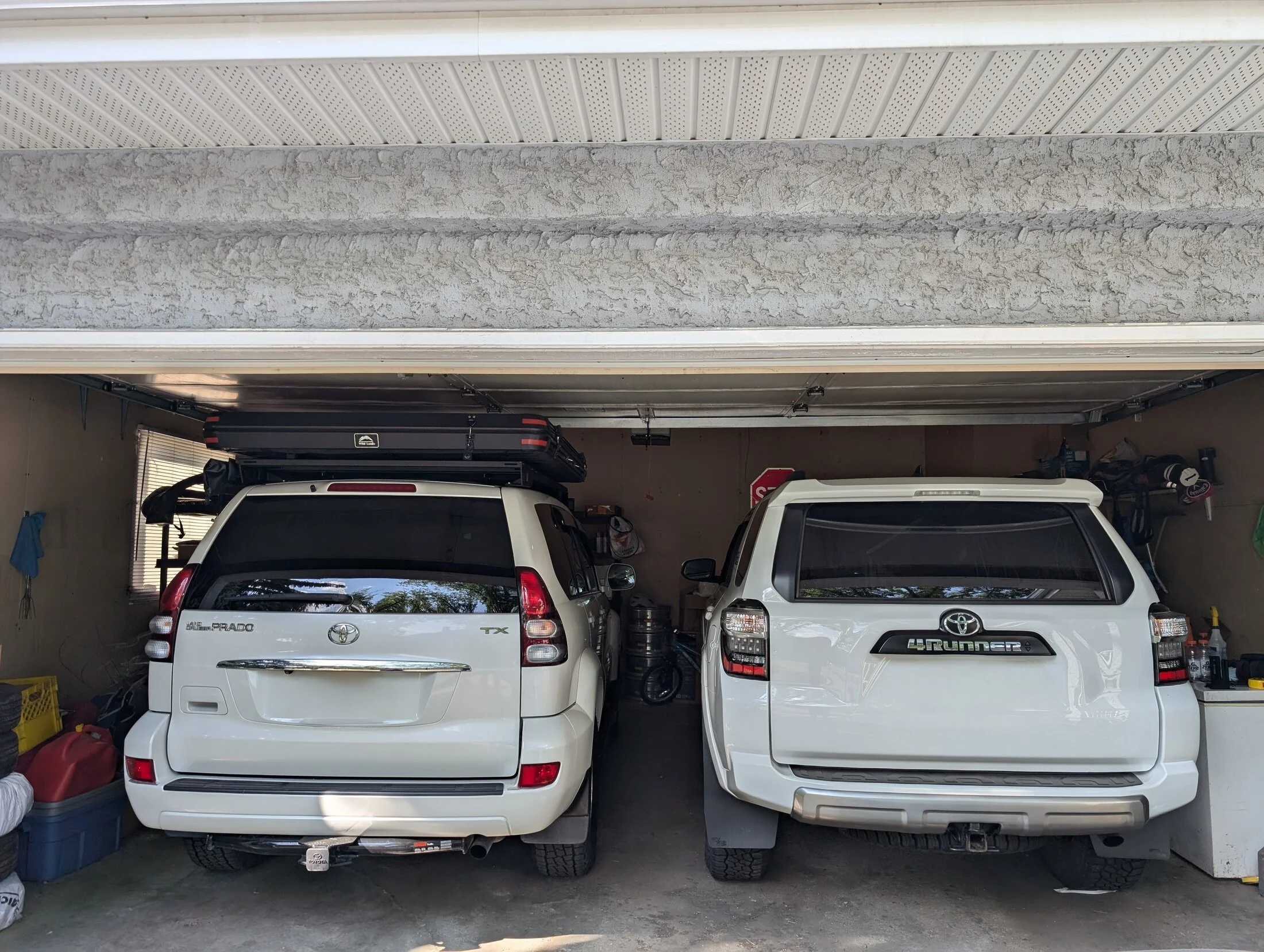

The last month has flown by, forgot to update this :doh:
I've installed all of the listed mods now. Just finished installing the roof rack, awning, RTT an hour ago. Maintenance is all done until shortly before snow flies and I'll do an alignment + fluid film.
Went camping once, shuttled some mountain bikes on rough fsr, close to 2000km of highway driving... This vehicle is awesome. My old vehicle was a 21 4Runner TRD Off Road and I honestly prefer driving the 120. The 4Runner is noticeably slower and has worse highway gear hunting/excessive downshifts. 120 uses less fuel as a result. The interior is nicer in the 4Runner, so many cupholders and storage areas. I really find the 120 lacking in that regard. Anyways, here are some pictures
