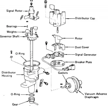

I can see springs, but there doesn't appear to be a place on the weights for them. IOWs a spring is connected to what would be the pins that hold the arms I'm talking about.

Guys I'm sorry about not knowing the proper name for the components. If anyone can post a detailed illustration of he components, I'll tell you what I see.

I think this is the one.
ok, THX ToyotaDon.
in the old distributor, the weights would move freely and rattle as I turned the dist by hand.
The springs are attached but seem to have no effect on the weights.
