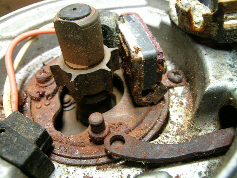

Pre ih8mud, Jim C , and desmog threads, this is what happens when you don't hook up the dizzy vent holes correctly. :hillbilly:

Or even if hooked up correctly but the firewall, in-cab filter is plugged. I went through 2 distributors in less than a year on a 3FE before I determined that the filter was plugged. A cheap fuel filter mounted high on the rear firewall as the fresh air source was the fix.

Use an aftermarket valve cover breather available at O'Reilly's or Autozone but mount it as high as you can on the firewall.
