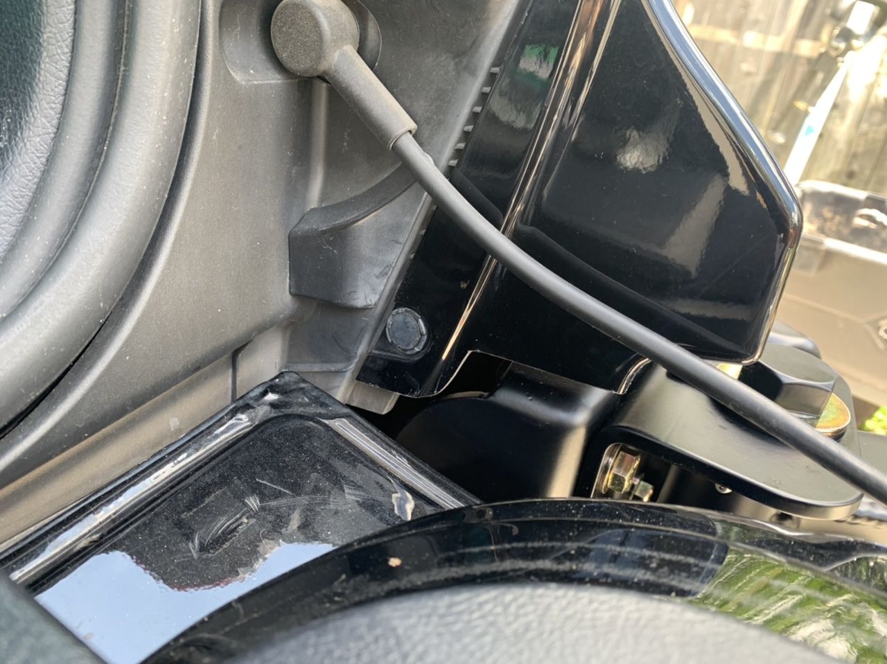

Yea, but I have a feeling it's going to be quite a bit of an angle. I'll tackle that soon.

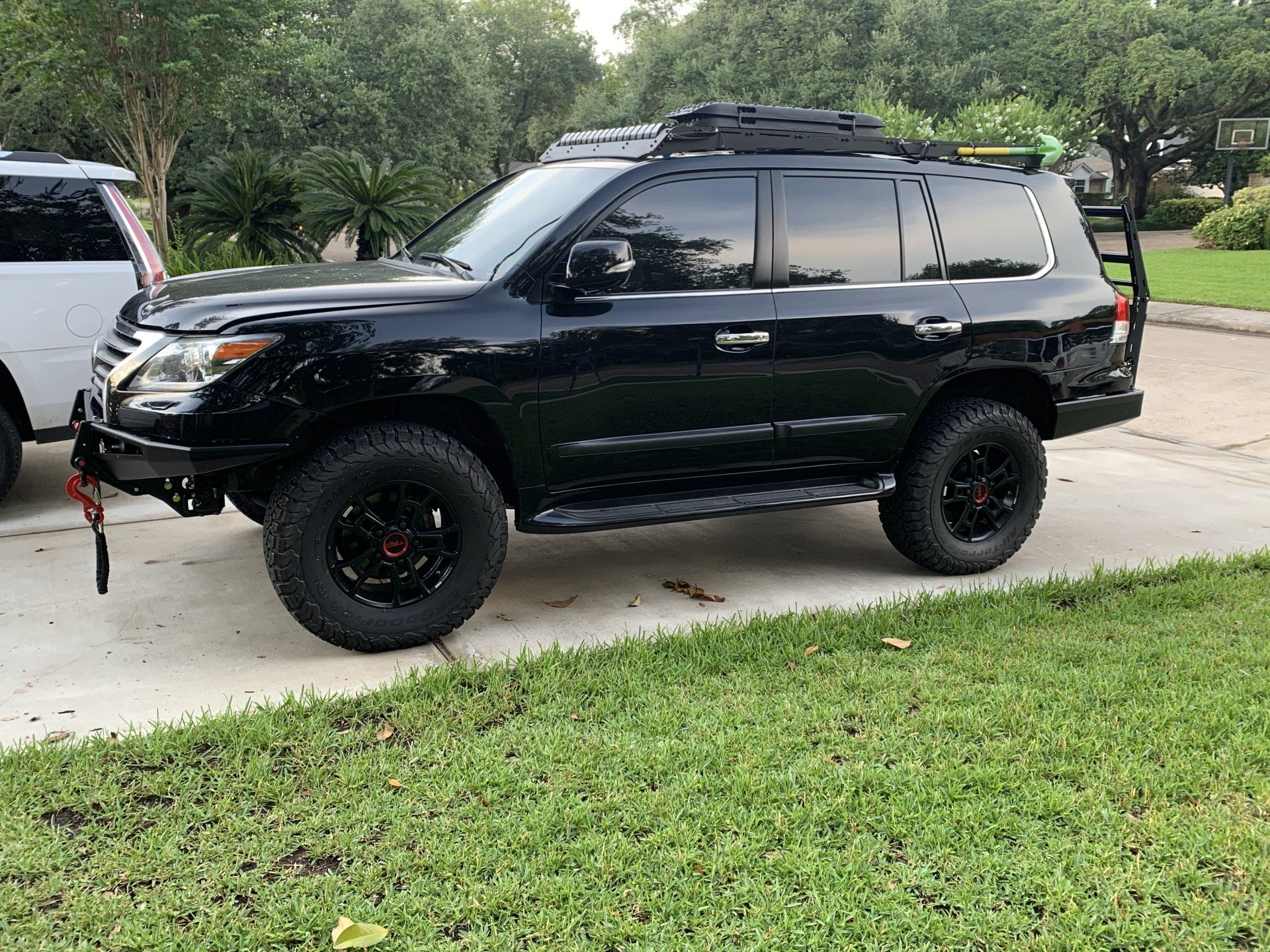

I was hoping the camera would land between my ladder rungs and not have to relocate, but alas, it's directly behind a riser....
Yeah the relo looks inevitable.

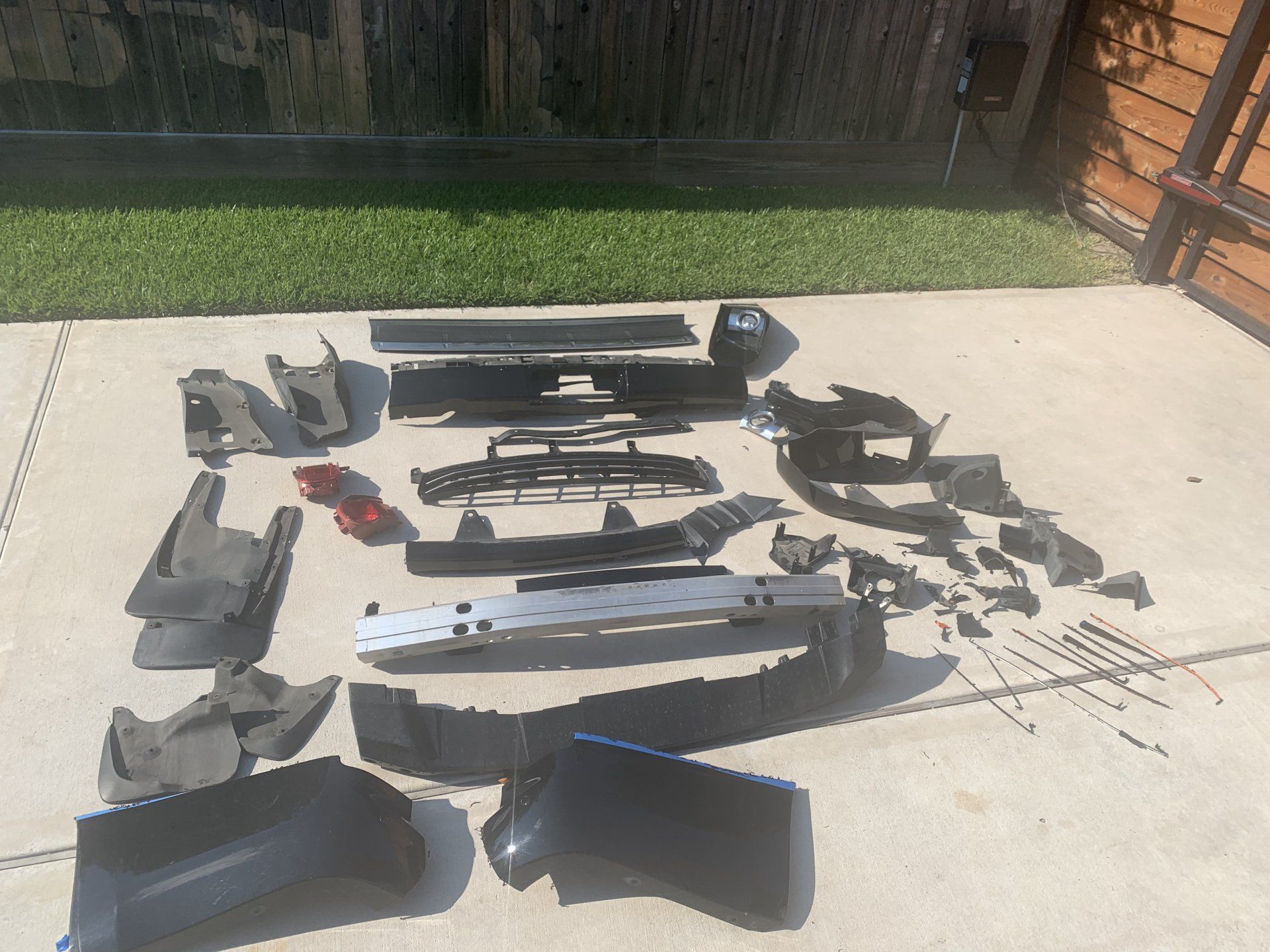

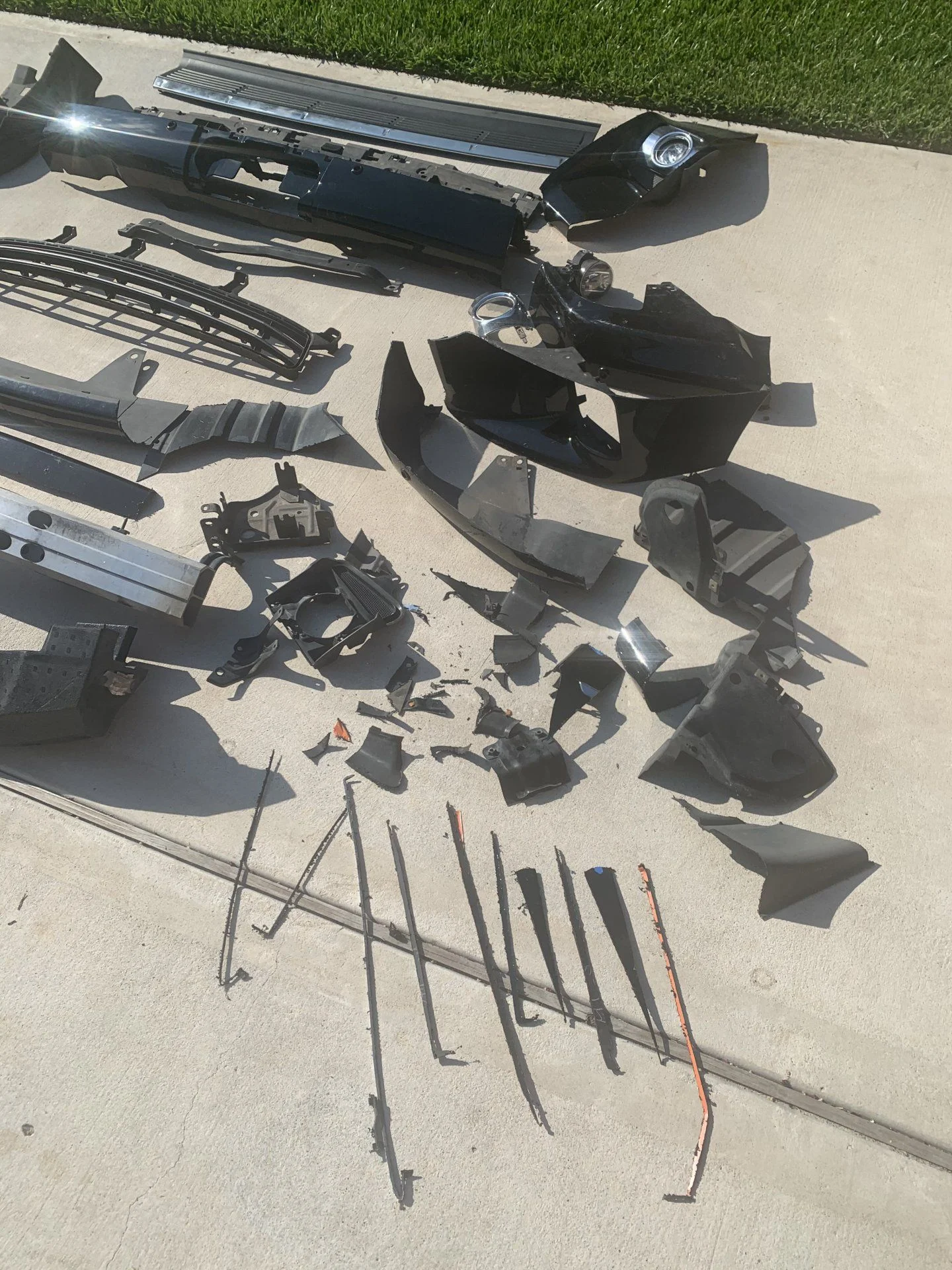

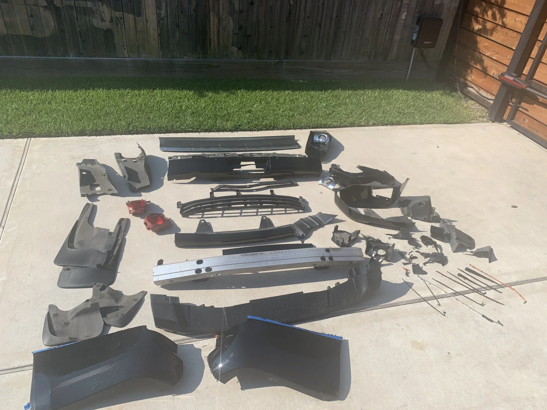

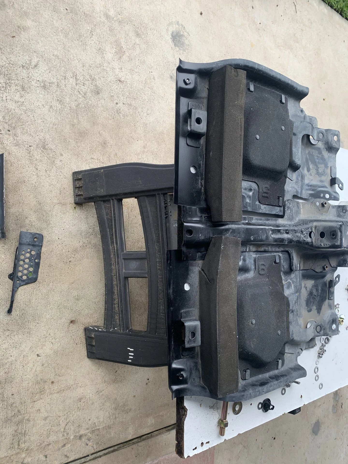

Here's all the scraps (except the resonator... not worthy of being called a scrap). Any of this worth keeping?
Also, if you're not using a $19 harbor freight oscillating tool with an upgraded $10 blade you're doing it wrong (check out some of the thin cuts). It's pretty much like butter... melting a bit as it cuts.
DEWALT Oscillating Tool Blade for Wood with Nails, Wide, Titanium (DWA4204)
Amazon product ASIN B00FMHPOVQ

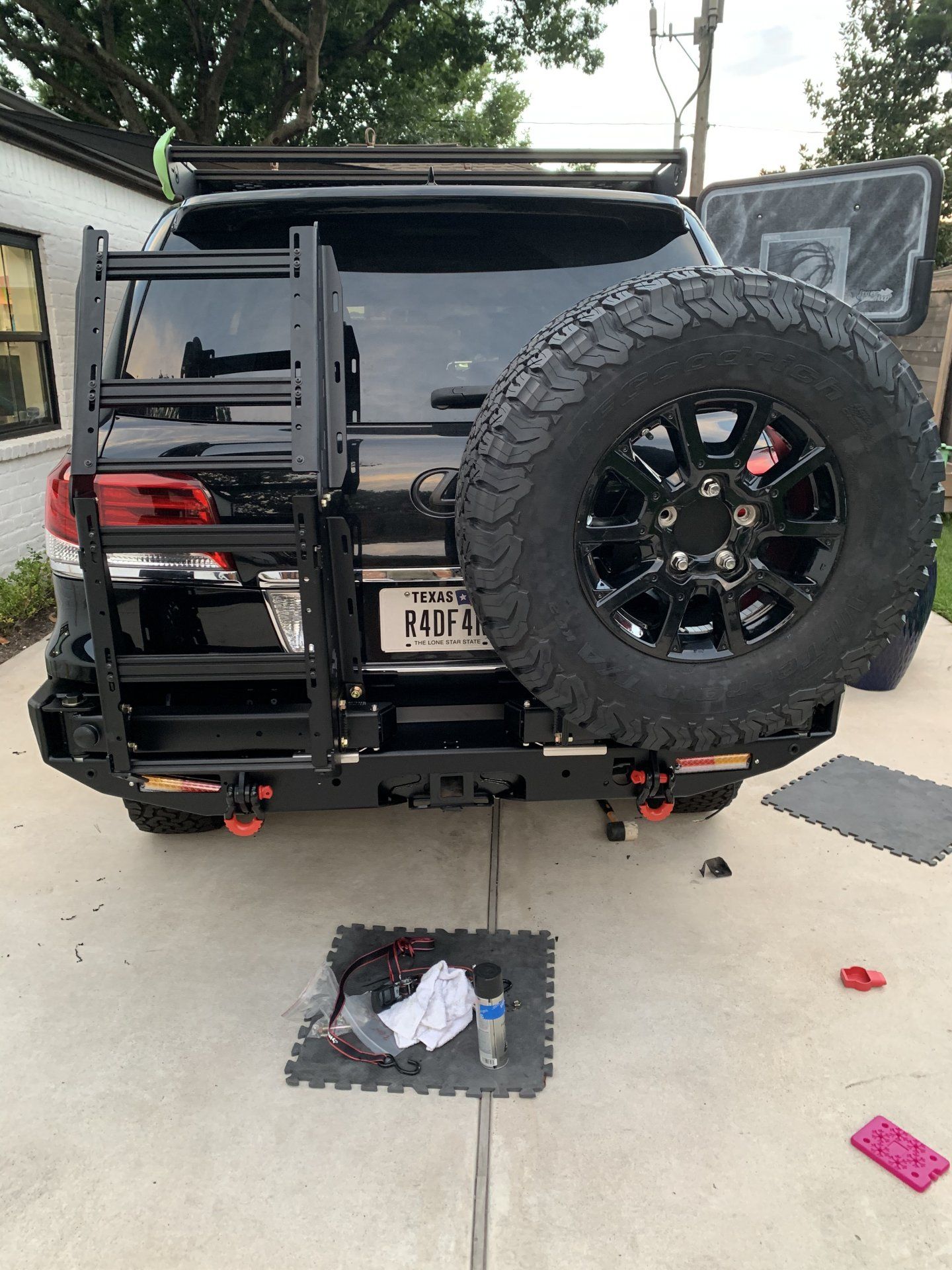

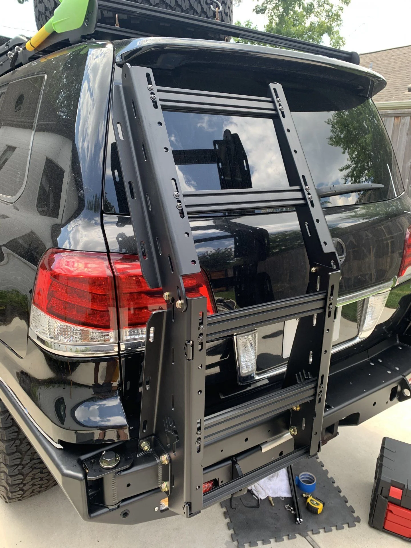

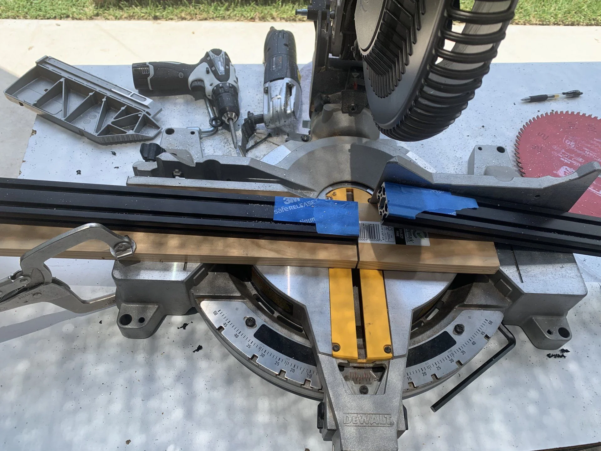

Ladder:
1) don't use your nice blades on aluminum!
2) round your corners to fit the bends

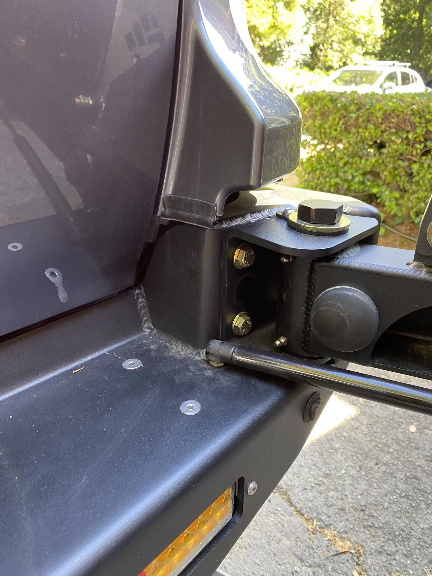

What is this? Dual shear rear swing arm pivots? Who does that?! :clap:
The metal origami mastery continues to impress.

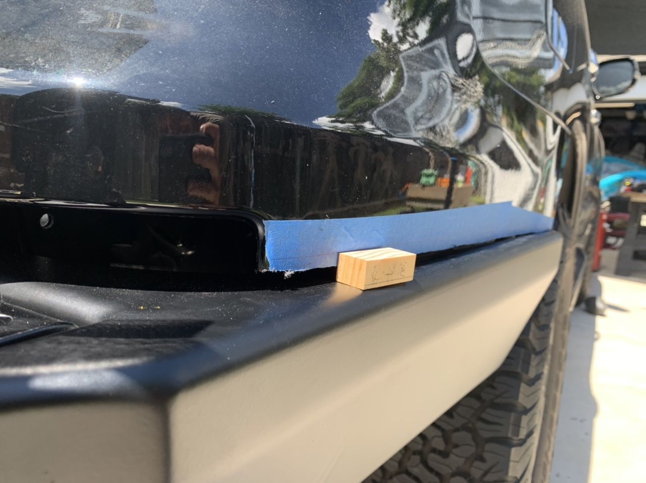

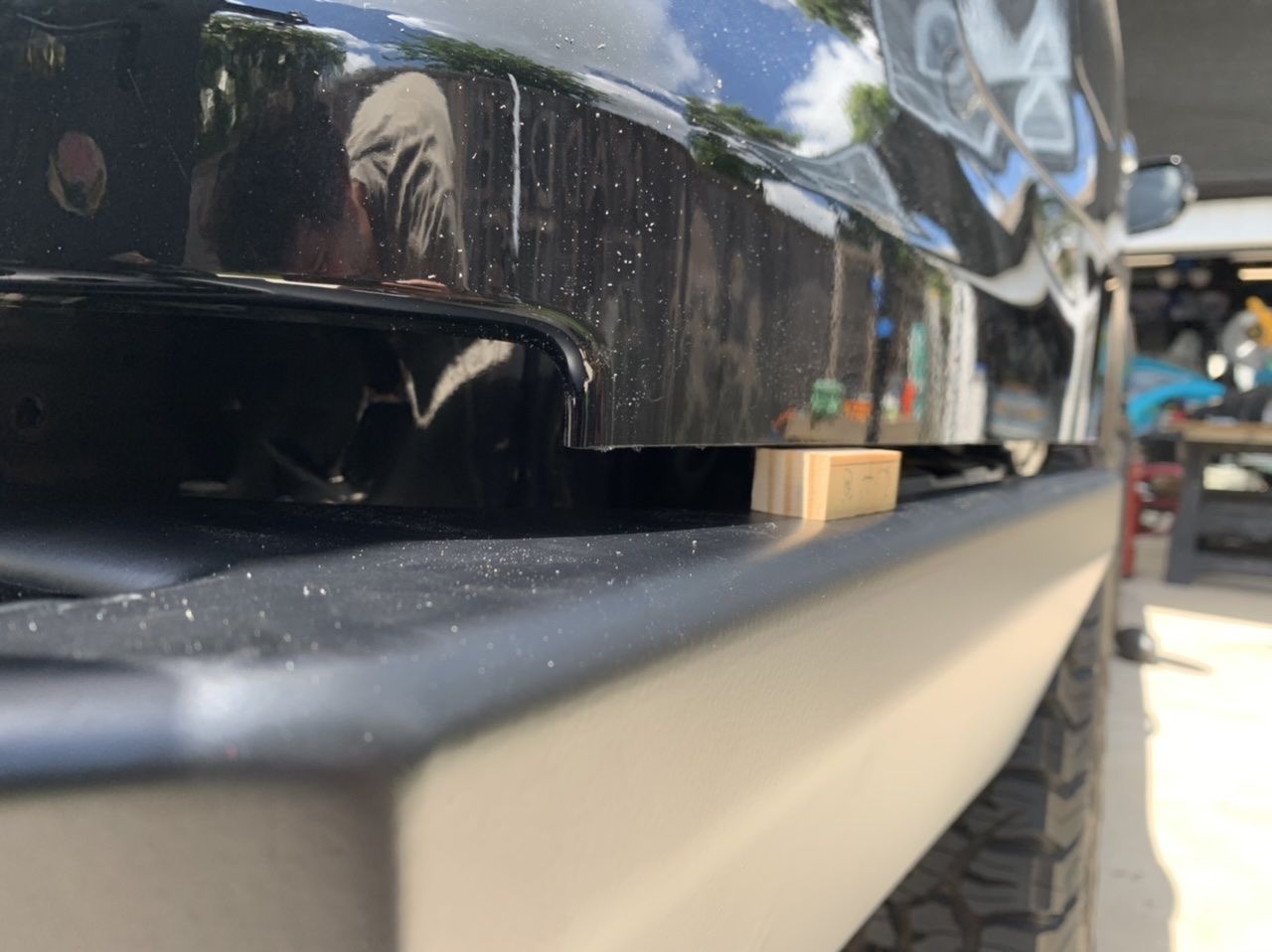

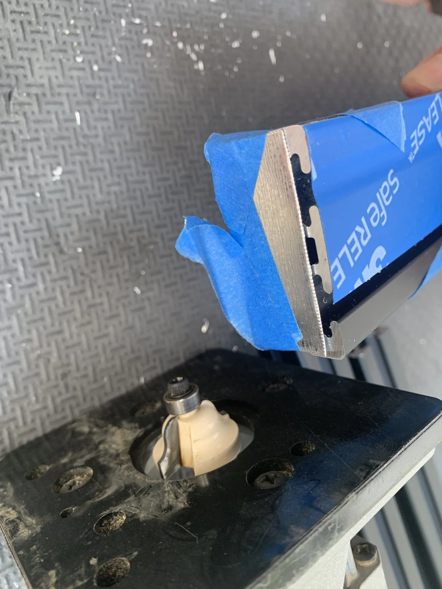

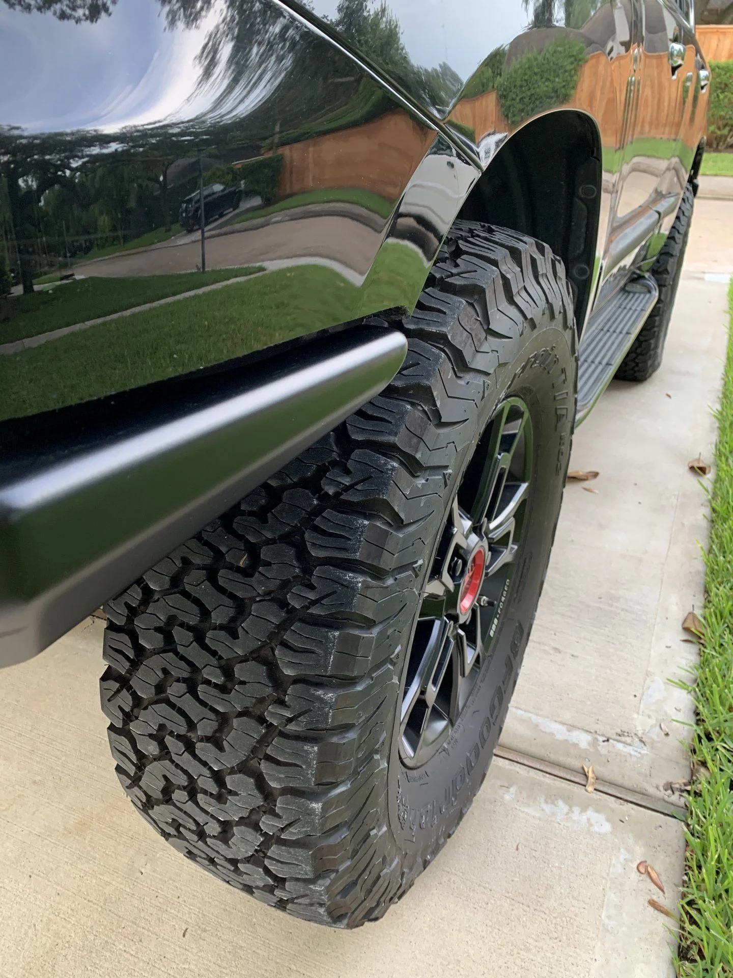

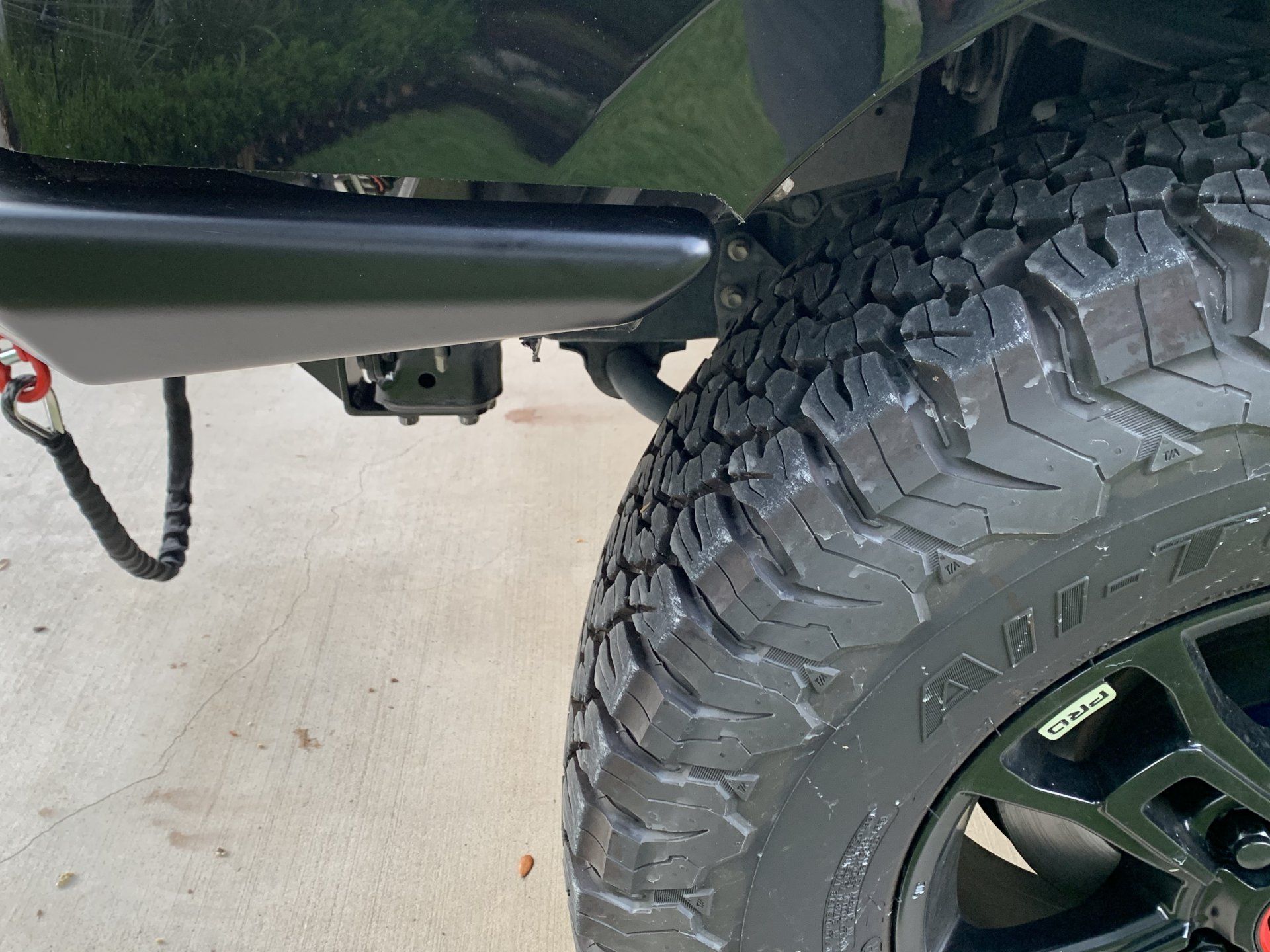

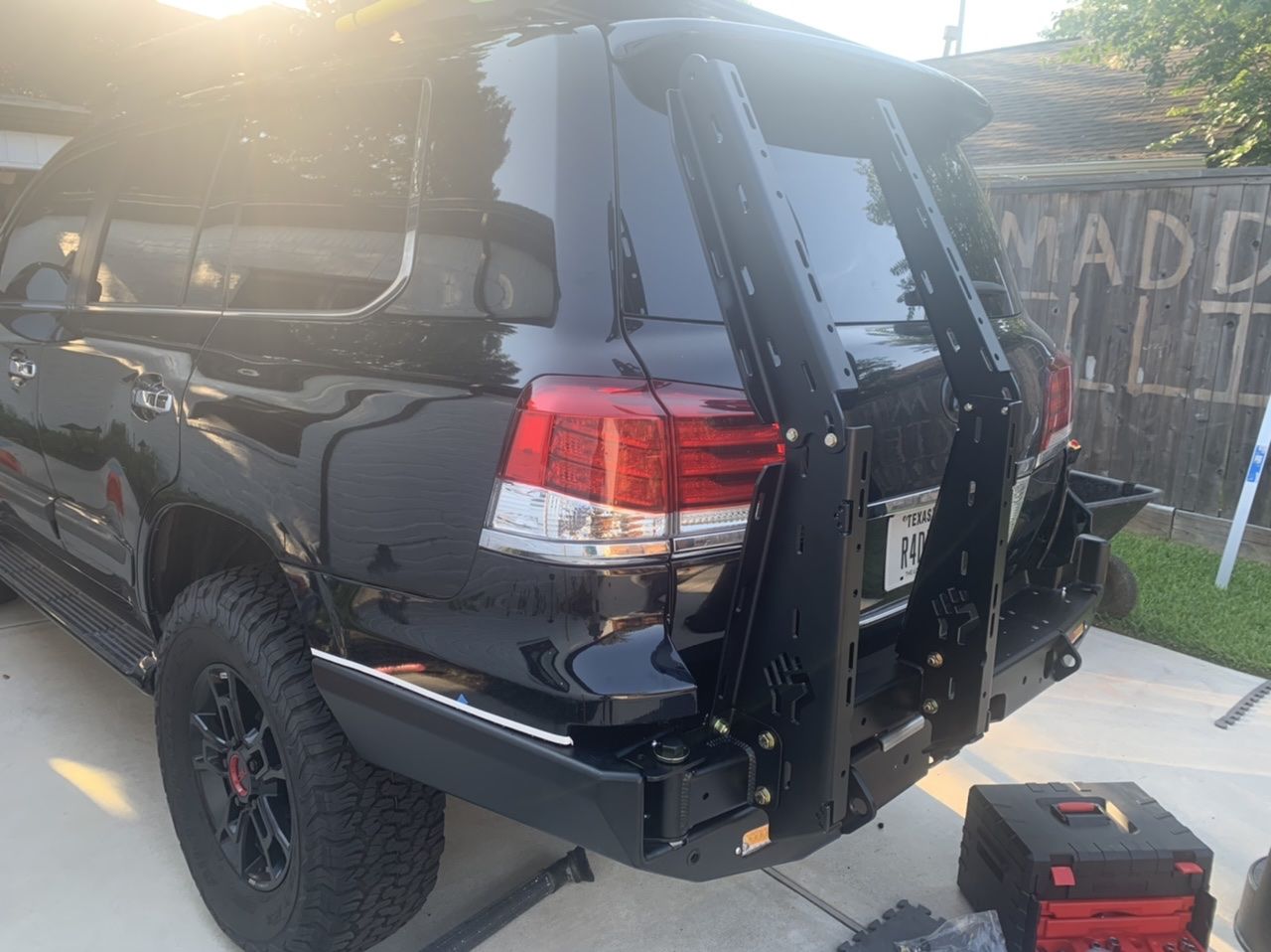

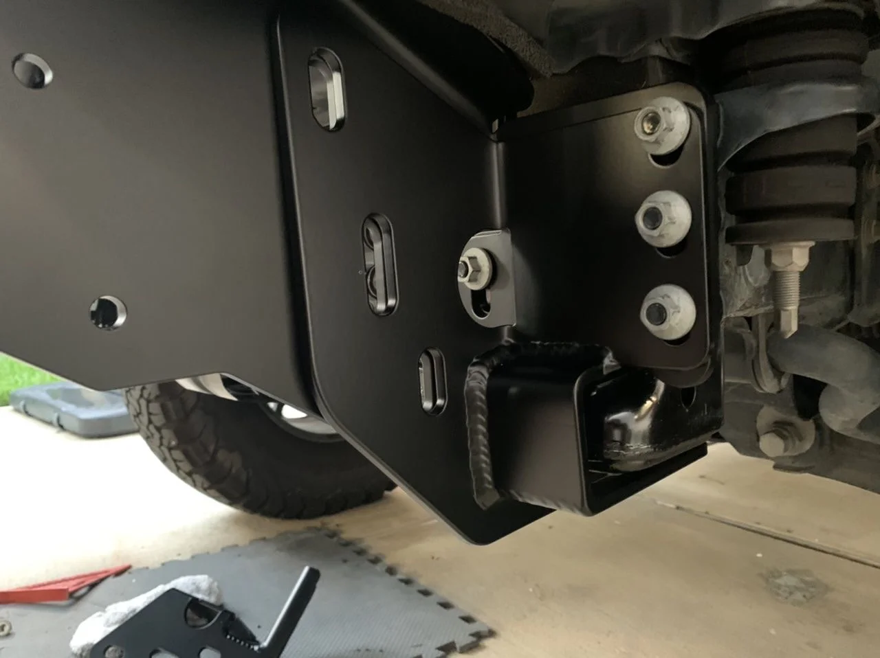

Final trim on the rear:
1) I used a 5/8" block to mark up from the bumper. (1/2" bulb trim plus 1/8" air gap)
2) light orbital sand to clean up the melted burrs.
Been avoiding this step, but shoutout to @grinchy for real world motivational support!

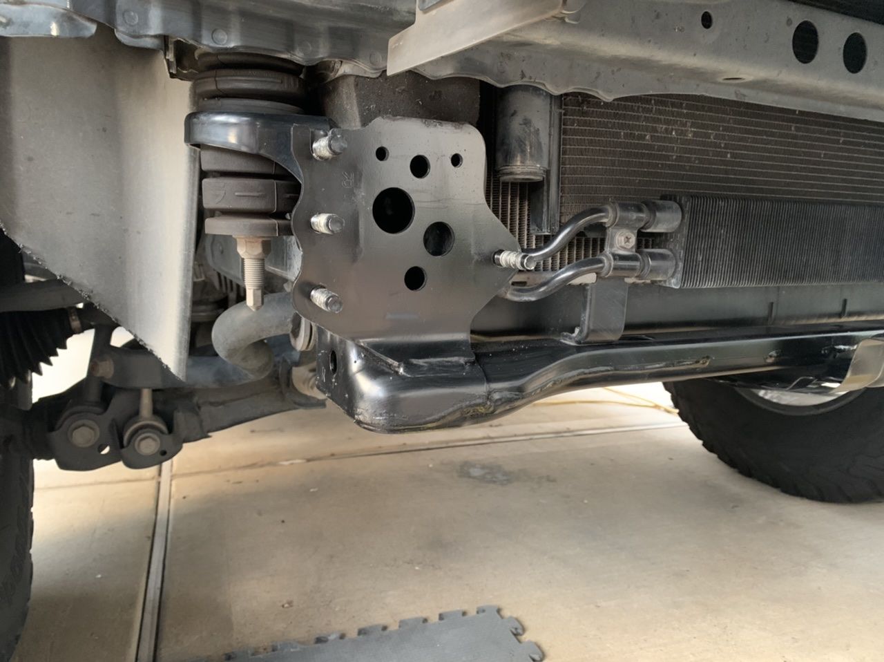

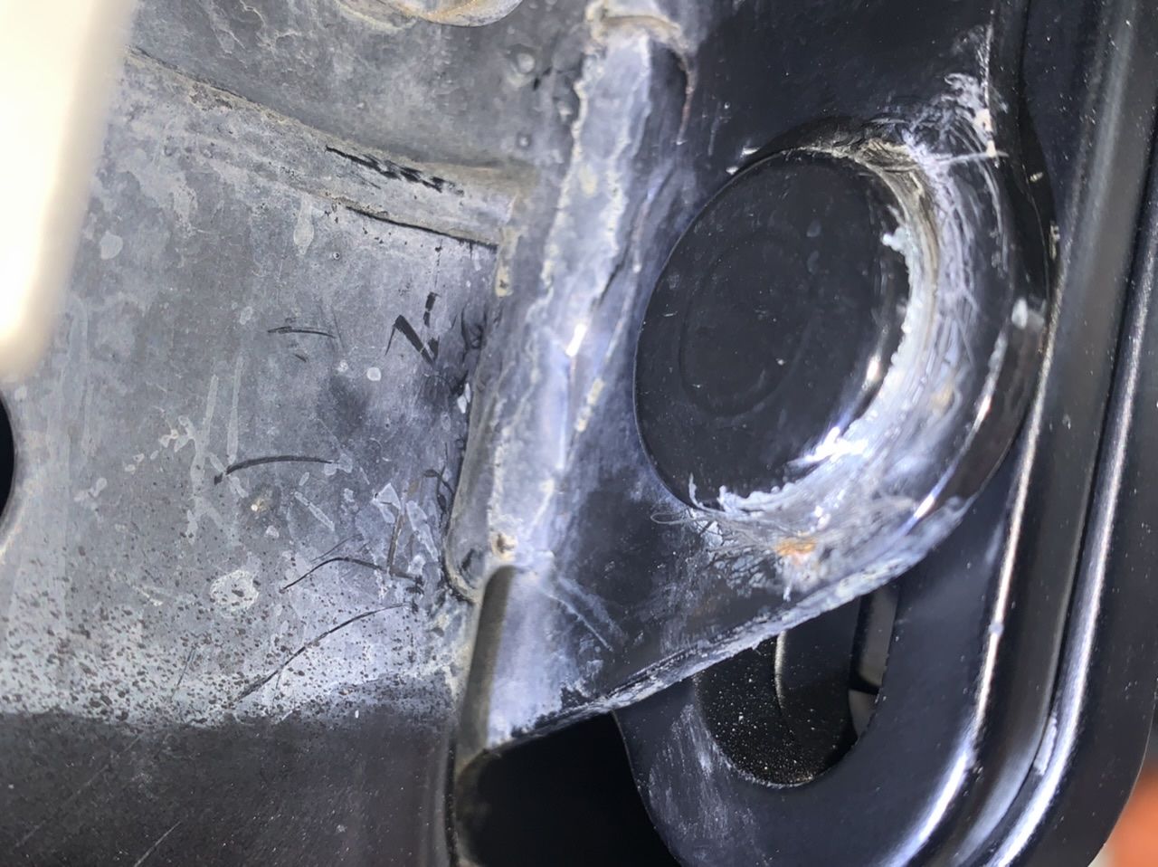

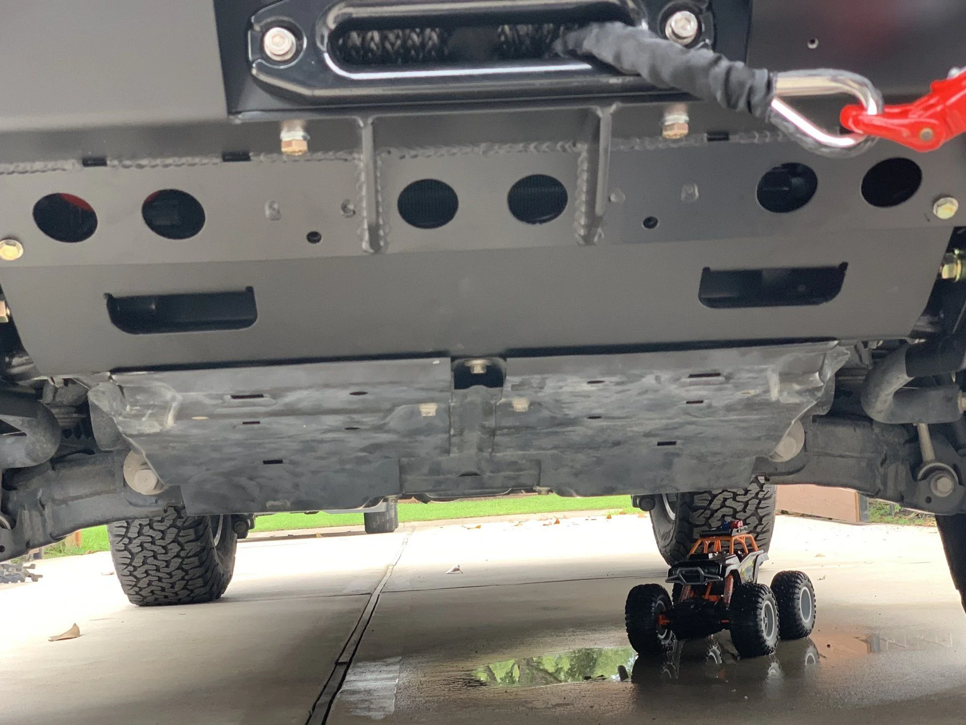

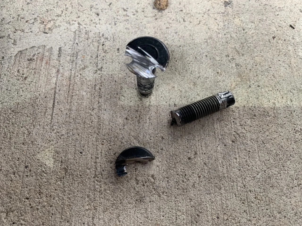

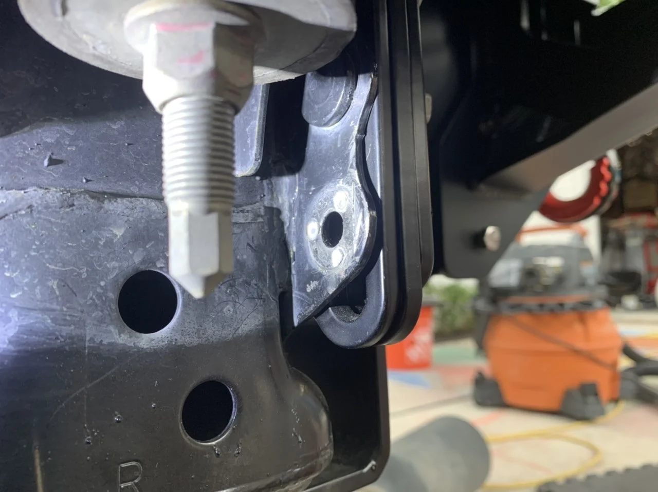

On the front crash bar mounting points, DO NOT use the factory nuts. Since the LX facia sticks out further than the LC, Dissent provides a 1/4" spacer to push everything forward. The stock nuts have a flange on them and there's not enough threads - make sure you use a simple washer/nut...
the studs are spot welded in 3 locations, so hammer won't work (in fact, it will bend the stock 1/8" back plate). I was able to grind from behind and then wiggle the last weld free.

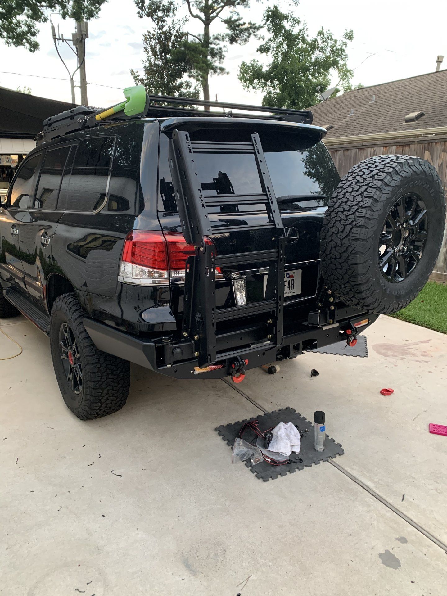

To-Do on the rear:
1) anti-seize all dem mounting bolts
2) wire up lights
3) install parking sensors
4) swap tire and ladder
5) relocate license plate
6) plasti-dip that shiny spare rim

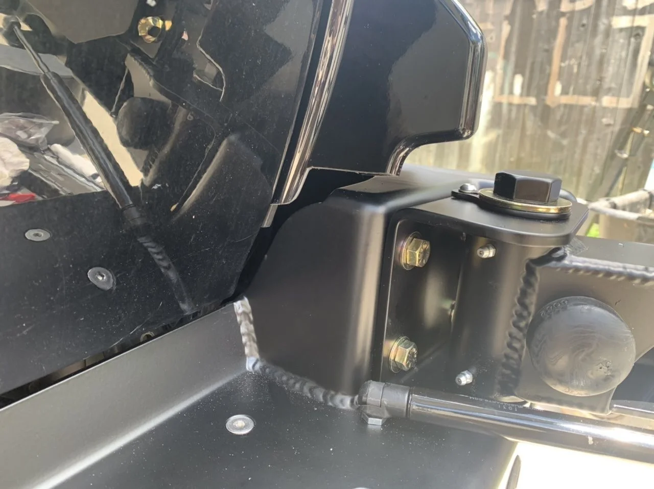

7) shorten tailgate support wires

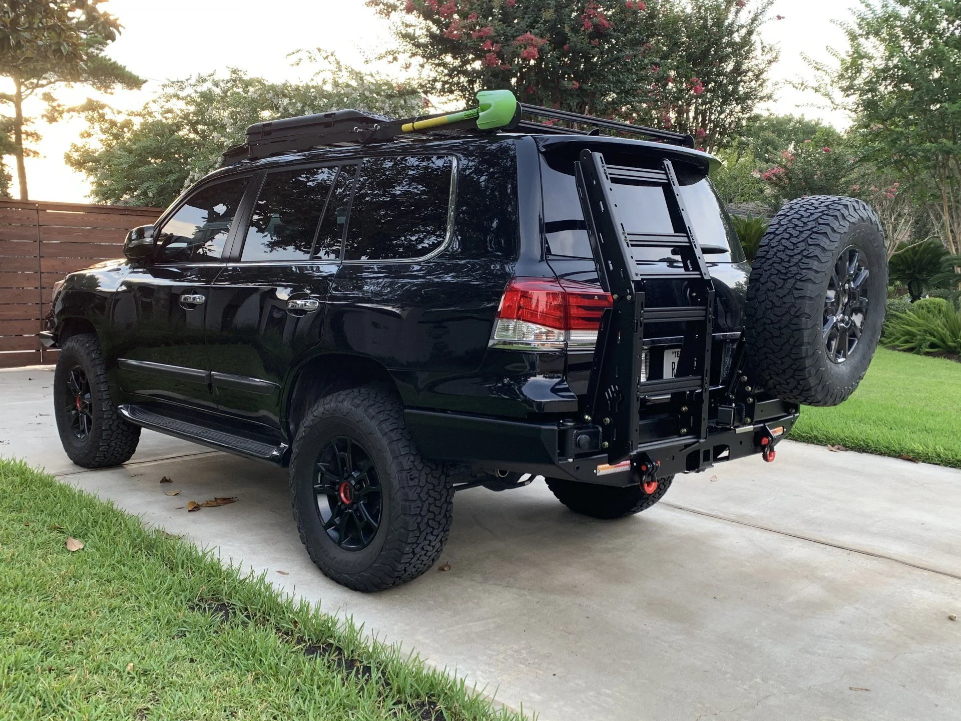

You’ve been busy!
The 80/20 ladder rungs tie in nicely with the 80/20 prinsu.
my opinion - don’t plastidip the 5th wheel. Buy another matching and rotate in - this kind of build deserves it.
thanks for all the time, pictures, insight you put into documenting this install
incredible
thanks! And I hear you..... I've been looking for another bbs, but can't bring myself to pay $600 for just one. Maybe I'll cover it up with a trasharoo until I find a deal

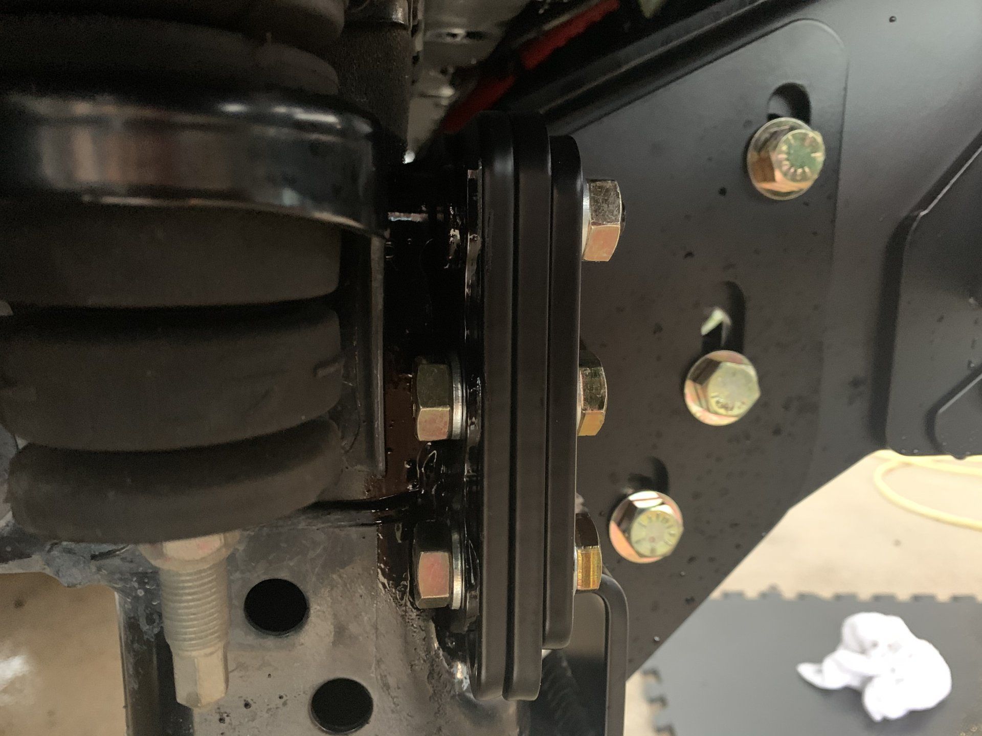

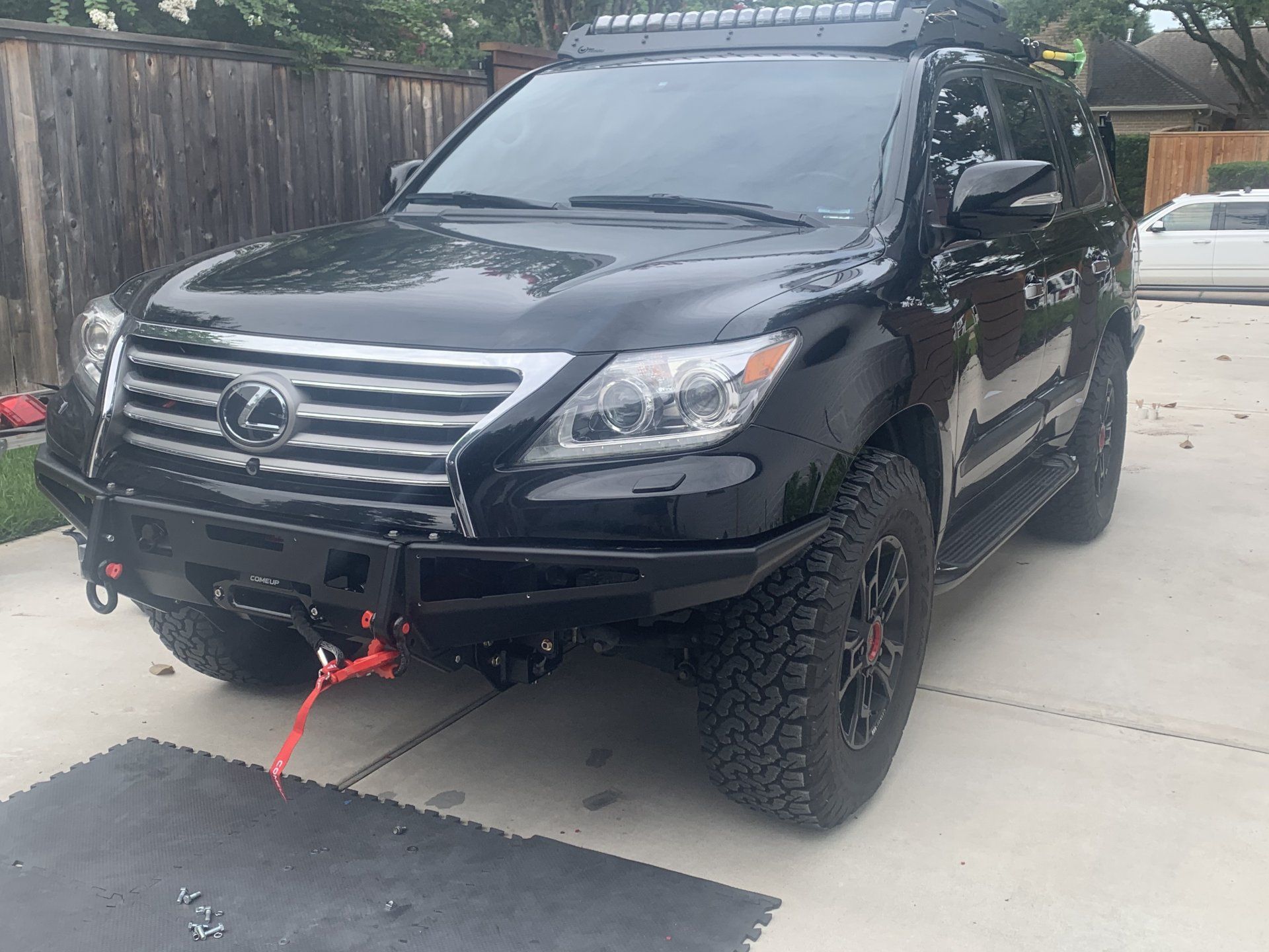

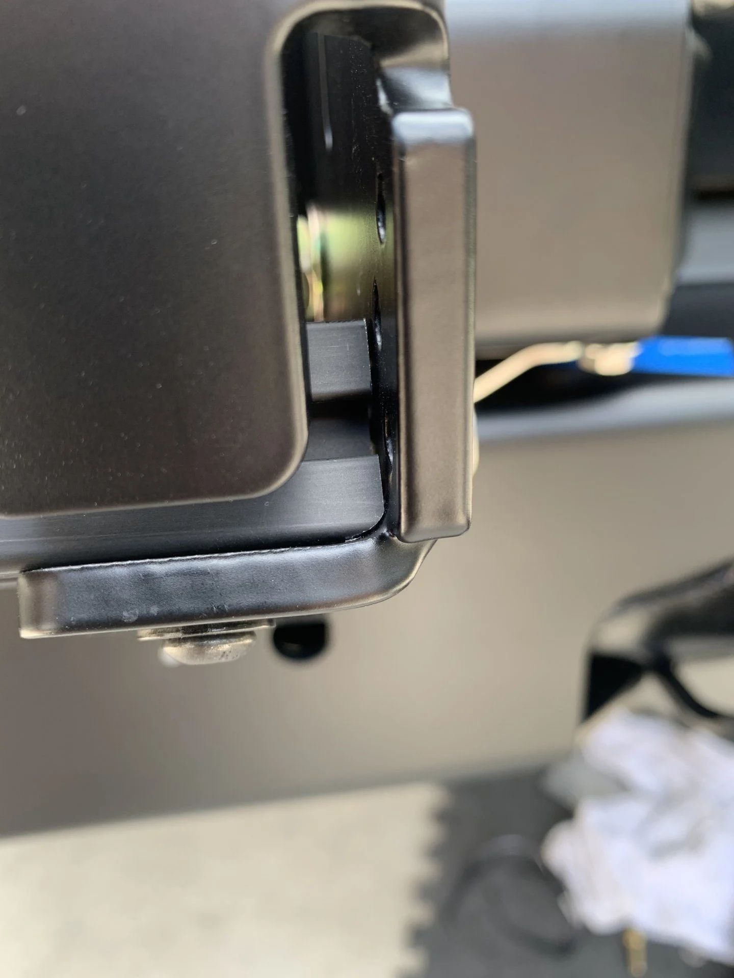

1) autozone had the right M10 bolts that I needed to finish up the front mounting.

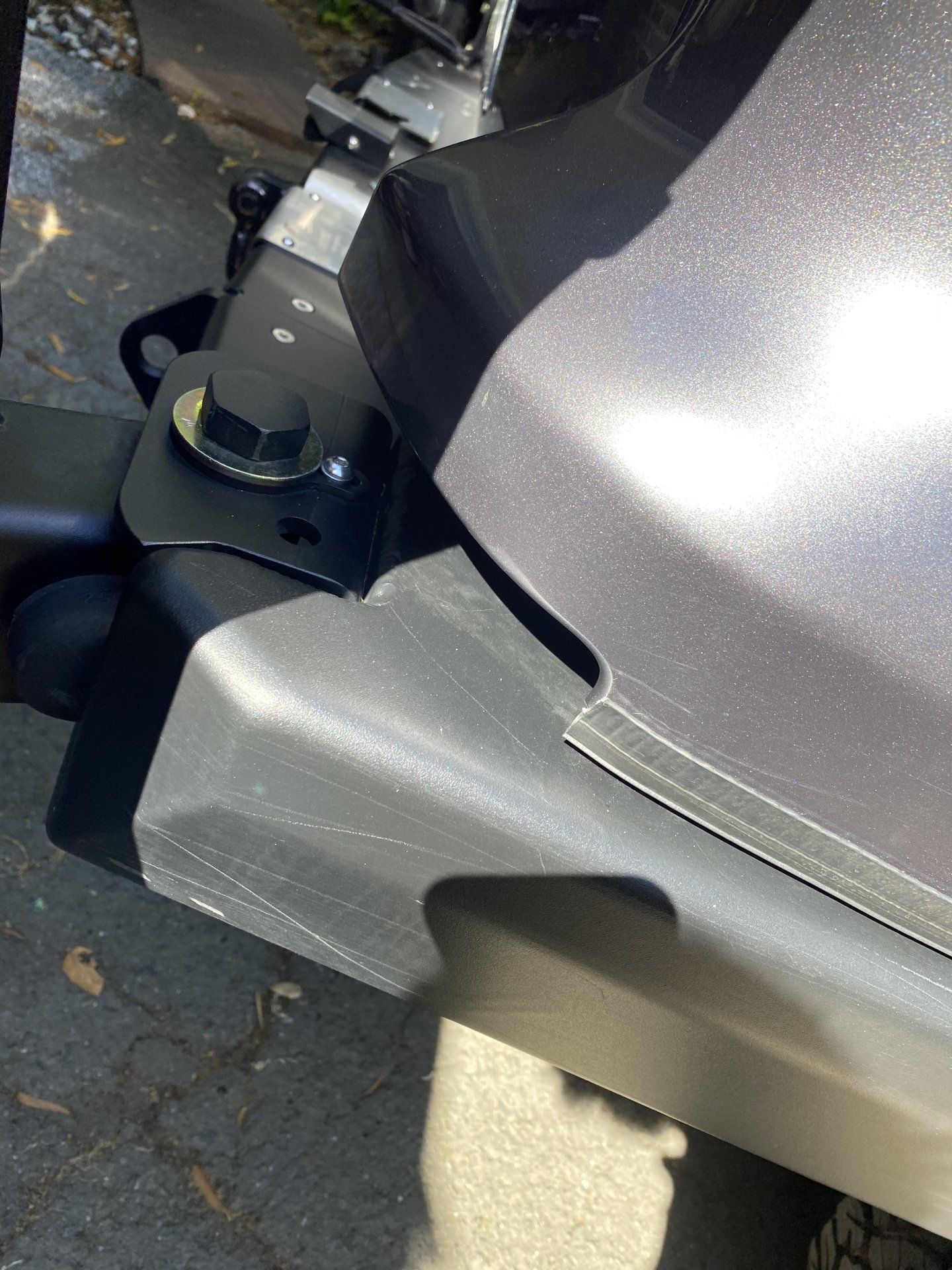

2) final trimmed the front and rear at 5/8" (1/2" bulb trim and 1/8" air gap to prevent rubbing), but I'm digging the no trim look for now. Seems like the black paint hides it well.
3) had to perform some surgery on the parking sensors to get a good fit. More on that soon.
Need to check every bolt before I go on a test ride....

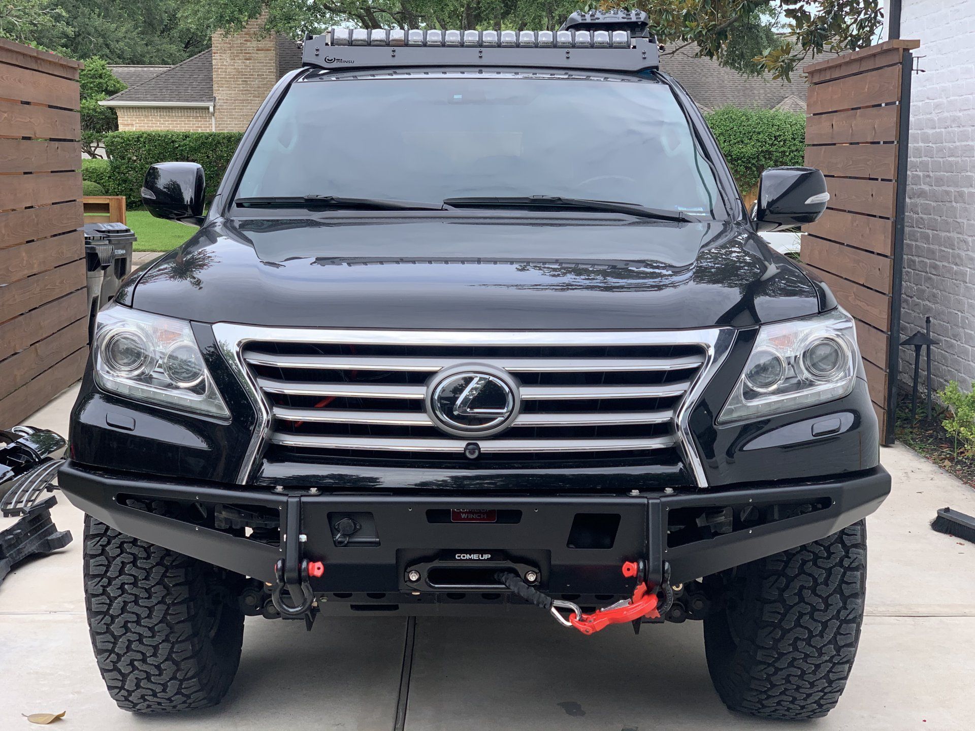

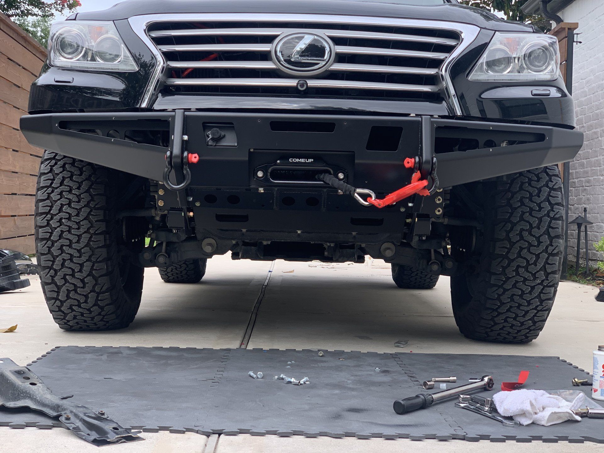

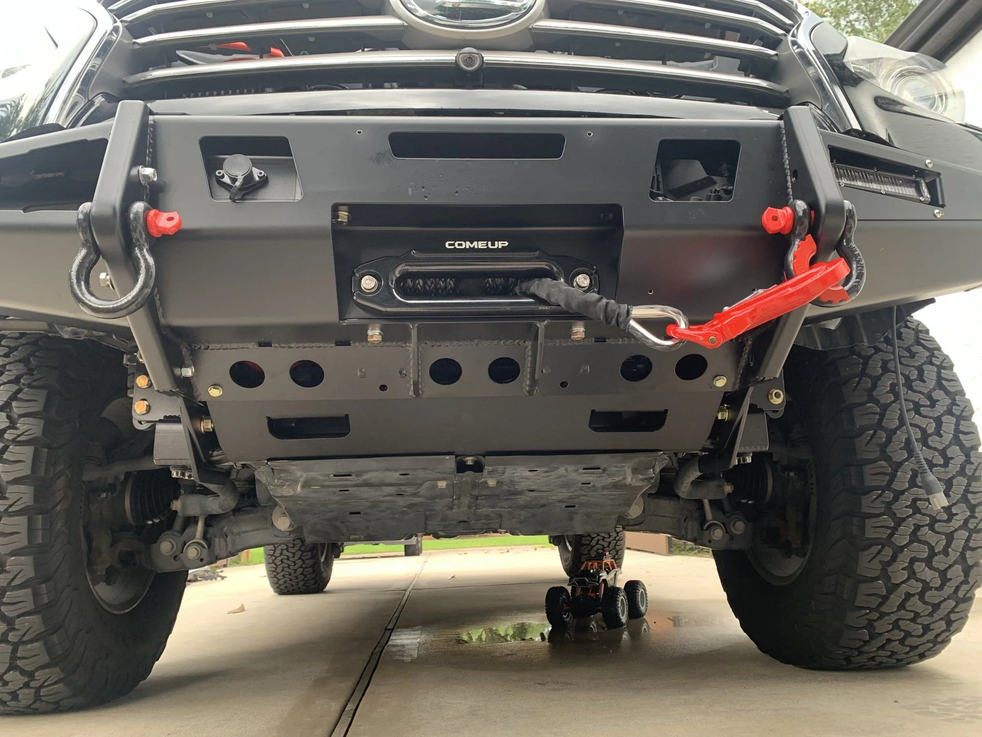

What, no full frontal?
Only because you asked nicely:

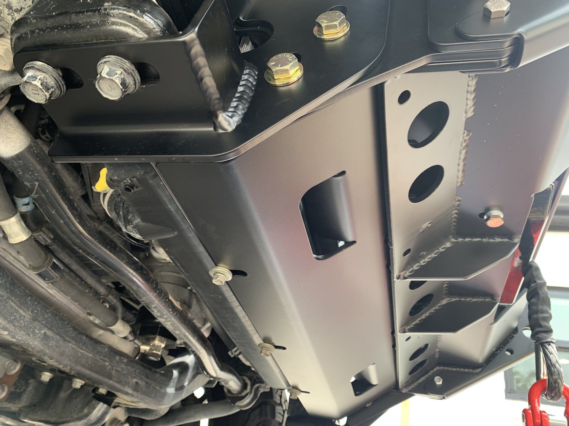

I greased up, glued up, and torqued up all the bolts today.

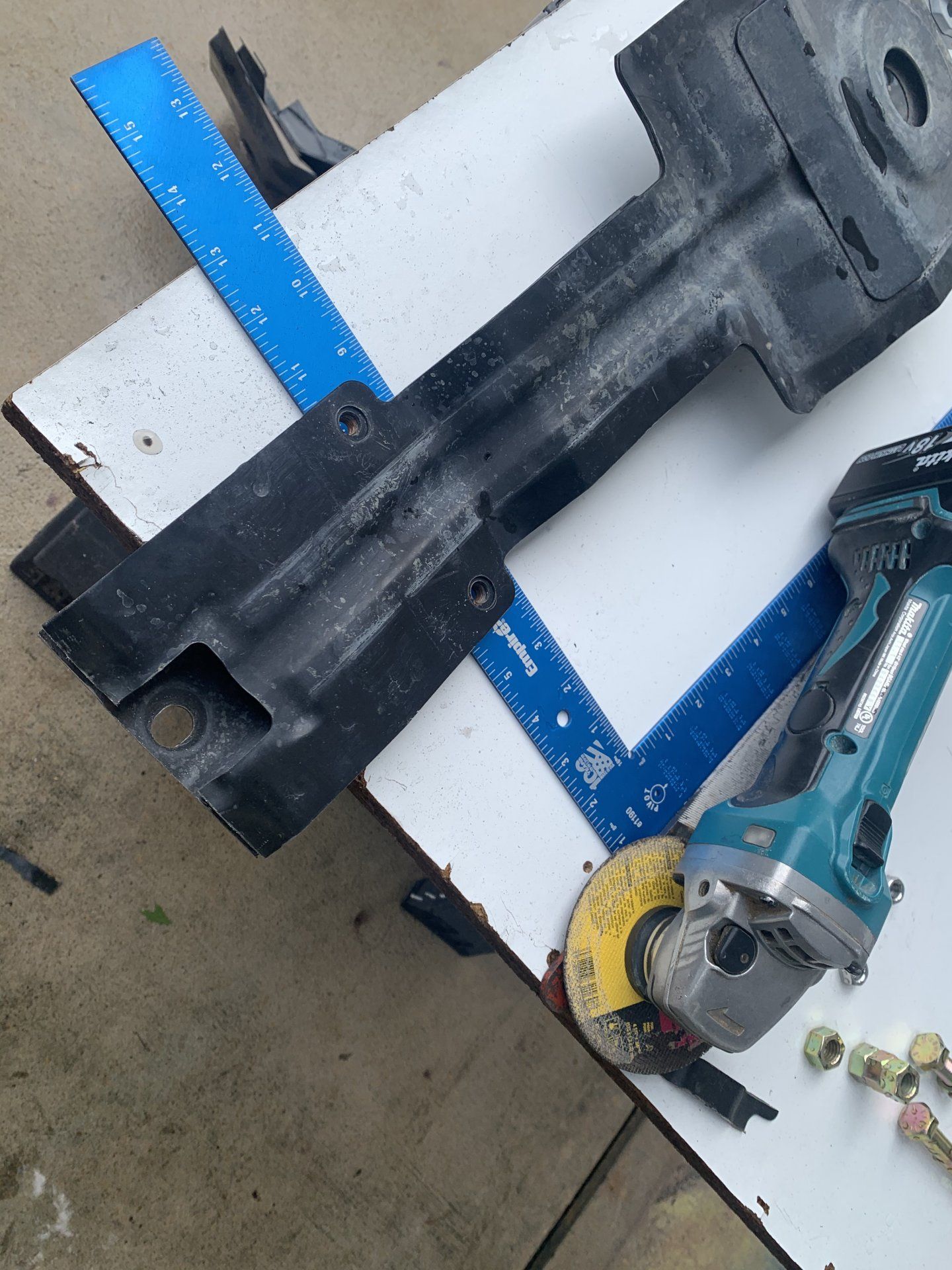

Also installed the lower radiator plate, and need to chop up the factory skids to make them fit.
Still working on the front parking sensors, so those are up next.

Step 434: chop up your factory skids until you can save up your money for the BEEF Dissent ones.
