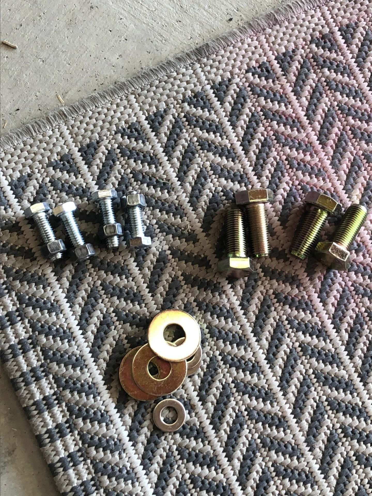

Had these left over. Did I miss something?
