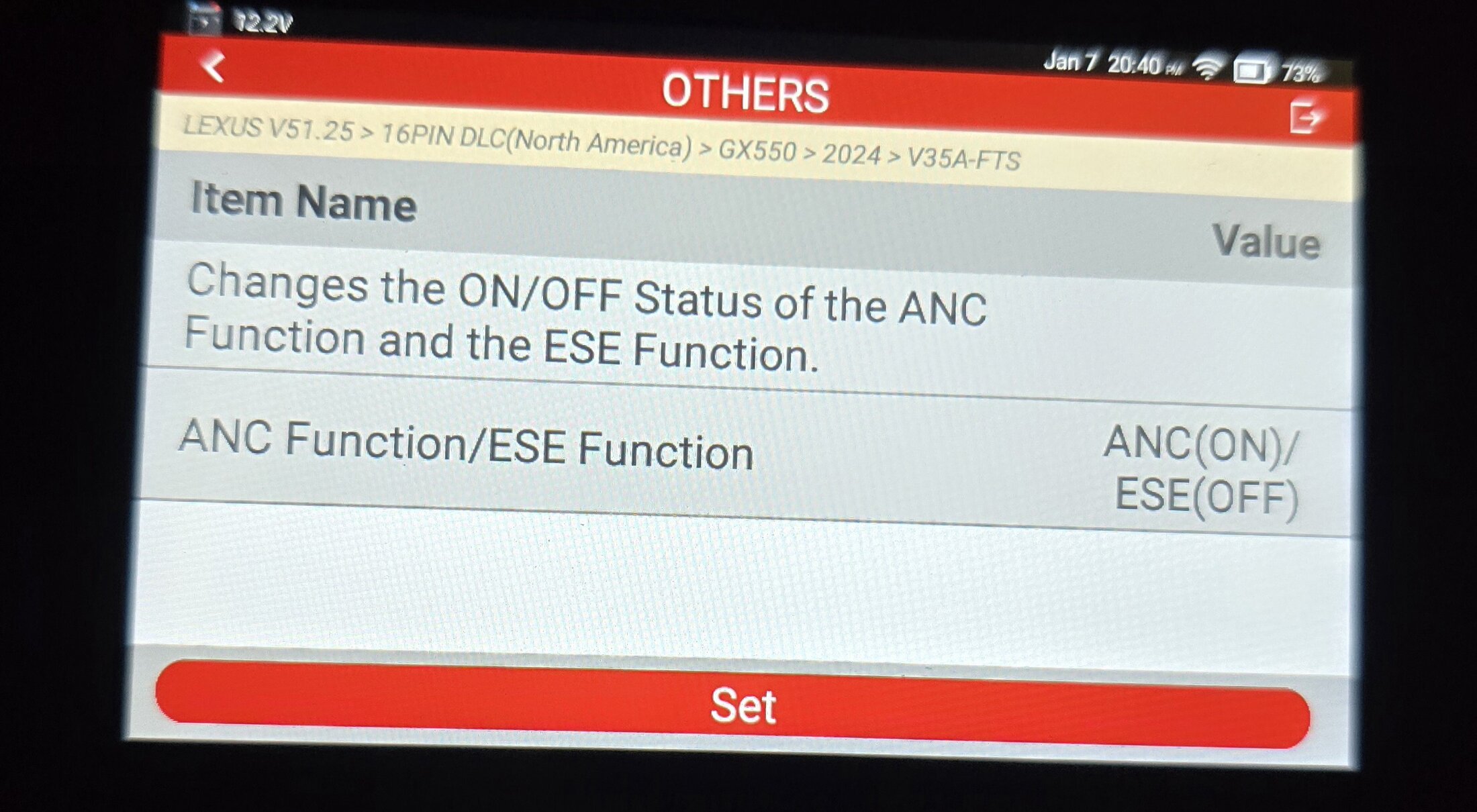

"ANC" (Active Noise Cancellation) reduces unwanted noise inside the car cabin by producing sound waves that neutralize existing sounds, while "ESE" (Engine Sound Enhancement) enhances and amplifies the engine's audio through the speakers.
@MikeVpdx503 also mentioned it in post 11.
Have you found that this tool can access the same functions as techstream?
