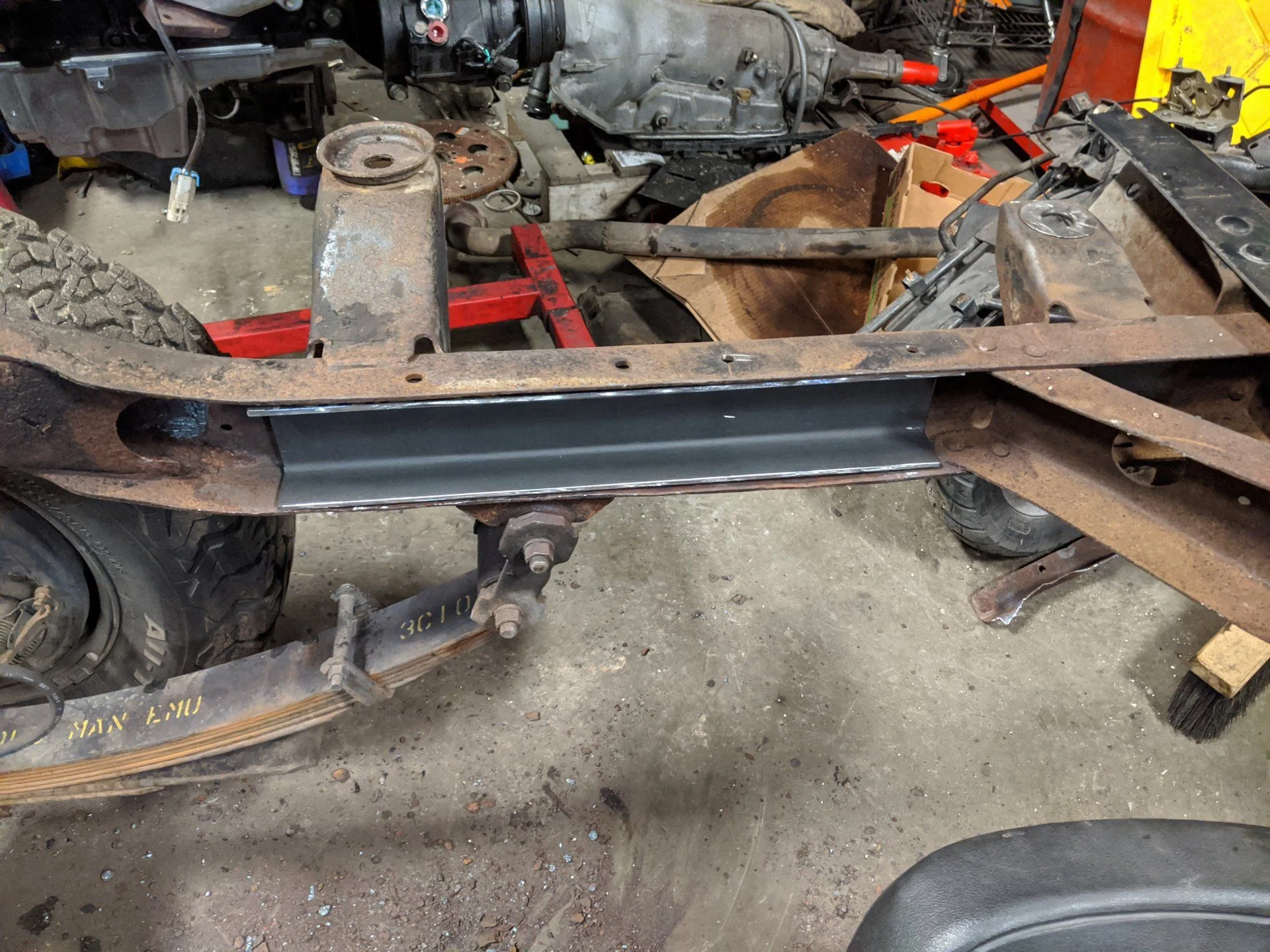

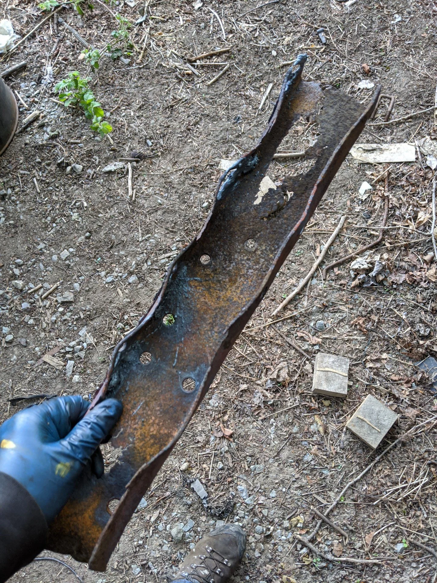

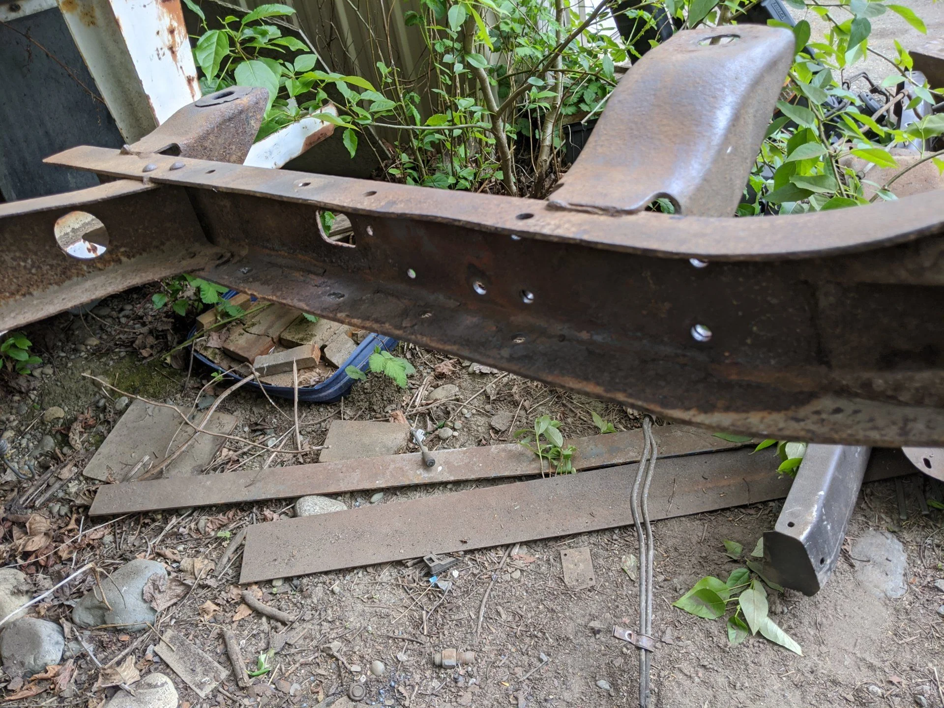

Had a day off work due to a cancelled trip and spent the day making more progress. What's more fun than removing the rear C-channels? Doing it a second time!
View attachment 2279286 View attachment 2279287

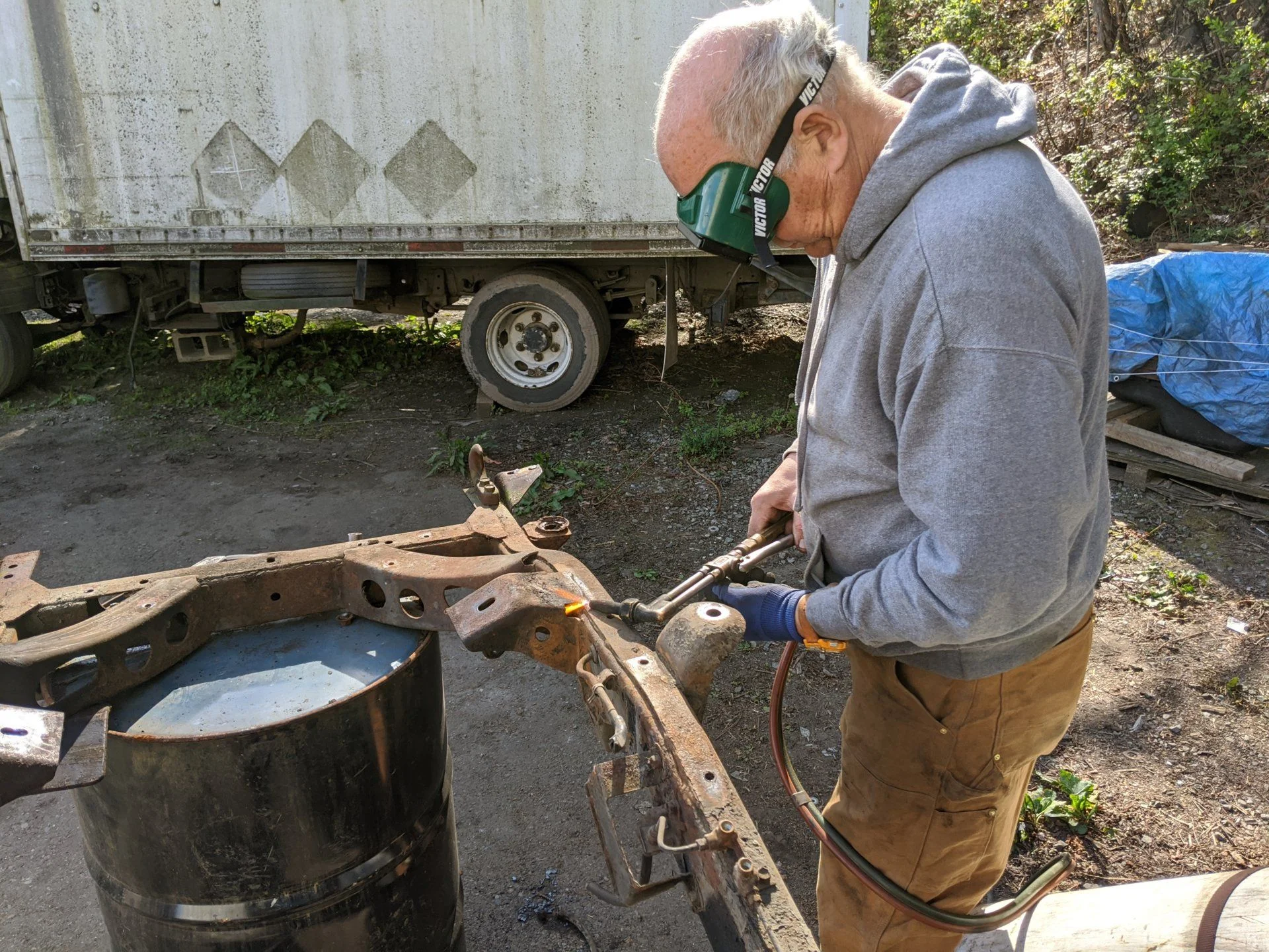

Had some help from my dad on the propane cutting torch to remove the stock motor mounts and help fit the late steering box on the early frame.

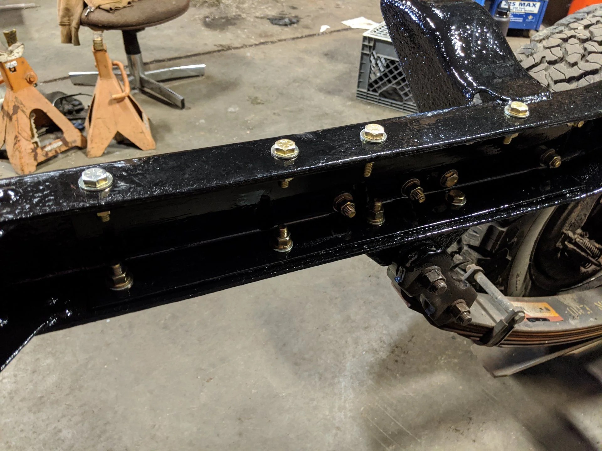

Next up is finishing up the rear channels with the replacement steel. I picked up a 20" piece of 3.5" square tube and cut it in half lengthwise with a grinder and a cutoff wheel. Clamped it into the rear channel and marked the holes with spray paint. Drilled the holes on a drill press. Ordered grade 8 hardware from McMaster Carr to bolt it together and just need to paint before putting everything back together.

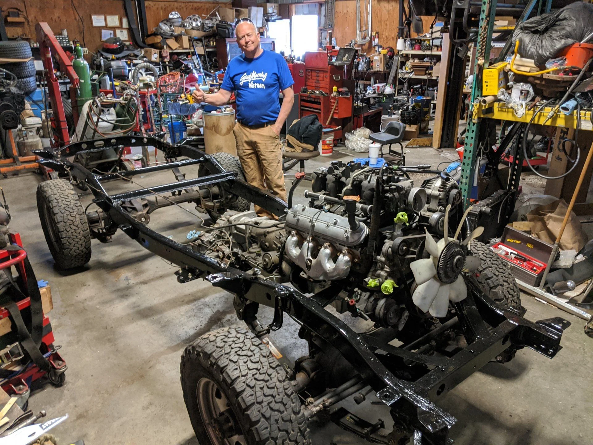

Got a little bit more work done today. Rear channels bolted in (was extremely satisfying putting all the bolts in) and engine/tranny/transfer all bolted in. Also spent a good amount of time chasing threads around the front of the frame and for mounting the fuel/brake lines.
Pops giving his approval

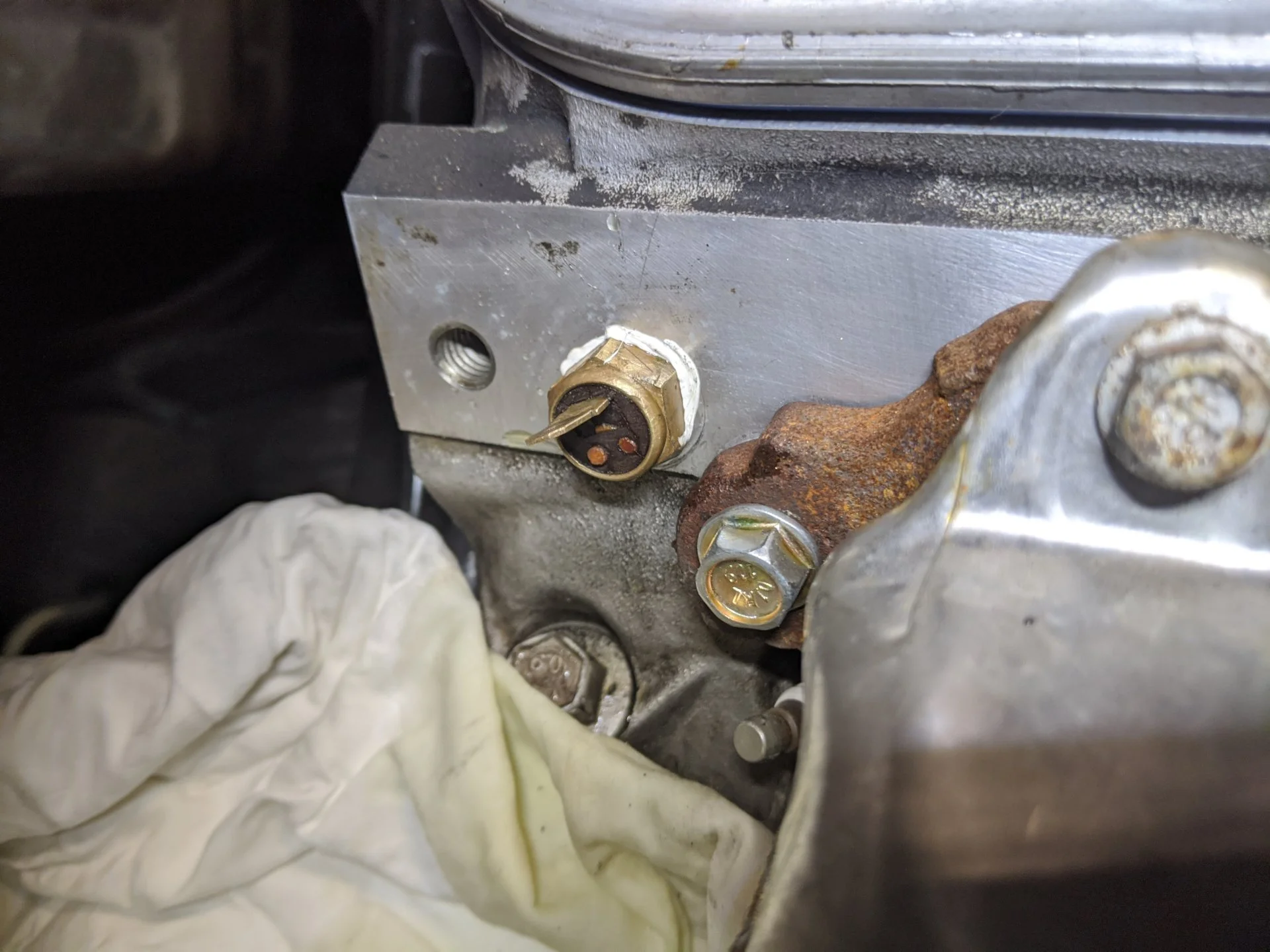

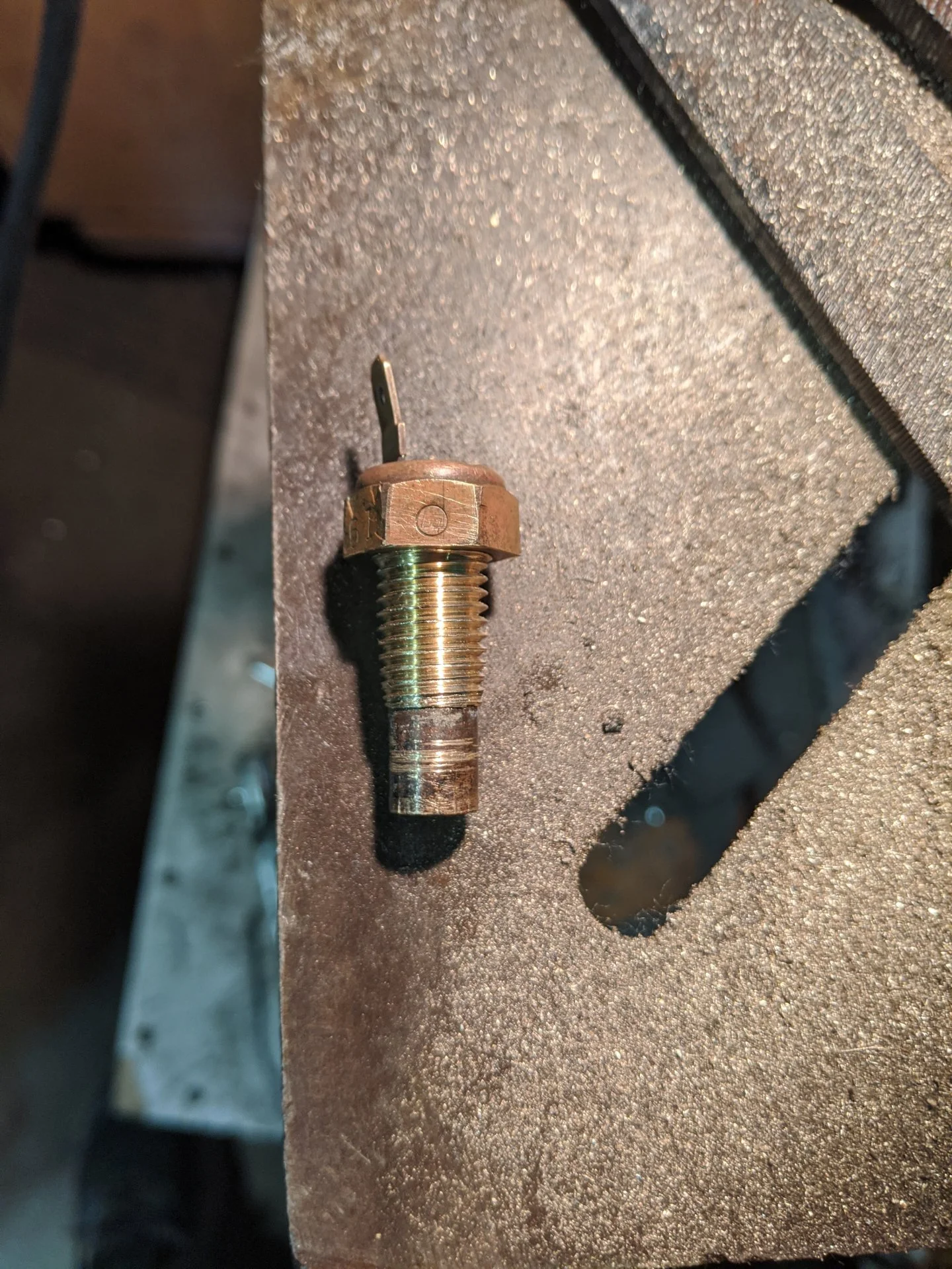

At this point the Dirty bird was very close to driving. Unfortunately my placement was a little off and I had to have new driveshafts made, rear a little shorter, front a little longer. While this was happening I also worked on getting my gauges working. I wanted to stick with stock gauges to keep the stealth look. I got an oil pressure adapter off of Amazon then turned down the stock temp sensor in a drill and re-threaded it to fit the LS heads. Can't remember the thread pitch but it made installation a breeze!
After driving the cruiser for a week or two the oil pressure sensor started leaking pretty back so I pulled it off and used jbweld as a thread sealer. Not sure where the issue exactly was between the adapters, but the jbweld solved the leak issue.

Would love more details on the temp sensor and the tach

Thanks @dbleon I appreciate it. The Temp Sensor trick I learned here on MUD, can't remember the thread but it's been done before. I know Torfab used to sell ones that were already machined with the threads for an LS, probably still do.
