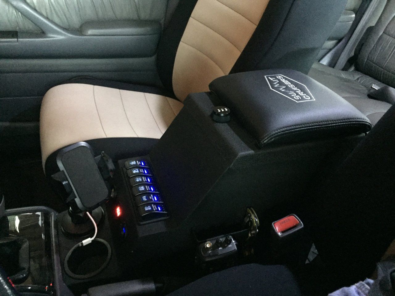

Out of curiosity, why would you want the same dimensions? I built mine to be much larger than the stock so I could gain more storage and a better arm rest.
Should be taller to function as a comfortable arm rest.
I thought the Tuffy 012 (or is it 013) that others installed looked good, and it was reported to be a good height. I don't trust them to be a lockbox, but I still think it's an improvement over stock.
Yeah the Tuffys look a little awkward. I built mine to match the height of the door panel arm rests or maybe slightly taller. I also took advantage of more of the space on the sides of the console, but left the e brake perfectly functional...not that it does much. I've been communicating with a fab shop that possesses all the CNC stuff I do not have access to, and I am planning to draw mine up in CAD with some slight revisions. I am mainly lookingto have replacement for mine to address a couple of things and add a couple things, and my dad is really wanting one for his 80 after experiencing mine. I wouldn't be opposed to producing more assuming I have time and the costs/time for each console work out. I'm in at least 100 hours on this console, but all of it was free hand cut with a plasma.
I'm not really liking the idea of rocker switches facing up. Too easy to accidentally flip one on. Looks good tho. I would rather have a jack on there for a cb and an external speaker built in for it.
