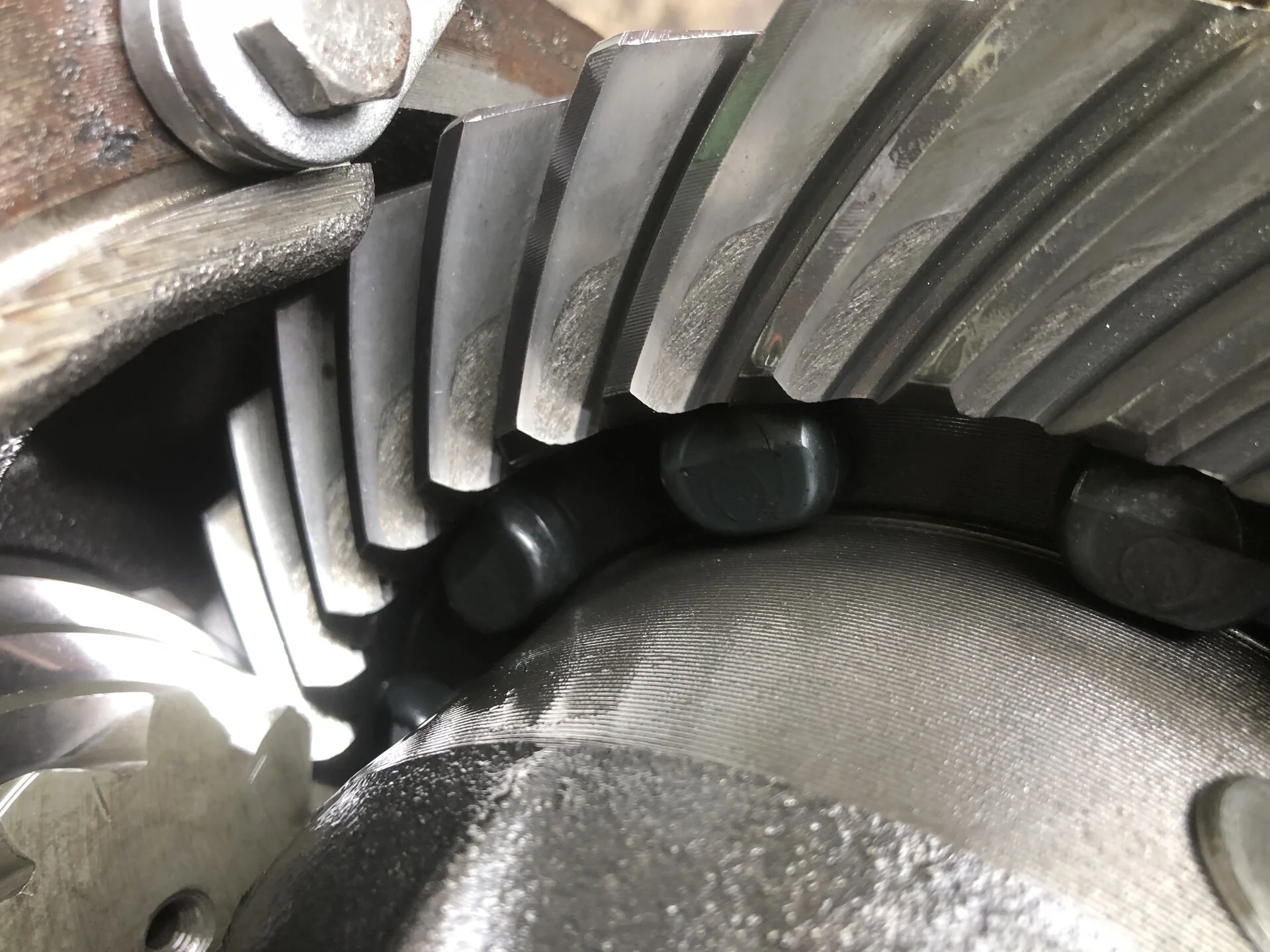

1986 hj75 troopy wreck. Beginning to approach differential study. What would cause these sorts of scars on the crown wheel please? The scars run most way round.
I think it needs at least a new crown and bearings, seal? I imagine pinions are replaced the same time as crowns, they seem to come together in kits?
The backlash measures ok, within spec. No idea how she ran. It is the front diff , it had very dirty oil with lots of fine metal so the oil was like grease. Neglected, the seal leaks too of course..Funnily enough it kind of feels ok as in snuggly turns, spiders don't wobble around too much, compared to other diffs I am looking at from layman's eyes.
Yes but, as far as adjustment went, why in that particular spot? It looks cactus for sure.
If it was adjusted correctly, one would expect wear grooves on the lower outer edge, kind of figuring with gravity and metal fines.
Unless it was too tight , so forcing and grinding the pinion upon the inner crown teeth..

That's cavitation damage.
Well I had to google that cryptic explanation. Looks like cavitation damage. I wonder if the breather was blocked, gas vapours built and swirled around blasting the crown in that particular spot...Must have been noisy when being driven at speed.

loks like evidence from a hard/heavy load pulled
strange thing though is it is not all the way around and does have the same appearance as cavitation. Bit like forensic mechanics , assessing stuff from a wreck, how the hell did this happen?! Most of it is sheer neglect and abuse.
FWIW might run a pattern on the teeth with the yellow stuff to see if it matches that worn spot, my guess is it will be a bit different cause under heavy loads the ring/pinion deflect and the contact changes, check pattern if its good, polish those up and run it.

Cavitation is when small bubbles form in a fluid and explode under pressure. The result appears to be really deep shot peening.
It's generally the result of fluid breakdown, not air entrainment.
I seriously doubt you can develop a good enough pattern to miss the chewed up areas. If they were half as long...maybe. But they're not.
Go ahead and play with it, though. It'd be interesting to see what you come up with.

Actually in different light the scars do go right way around.
