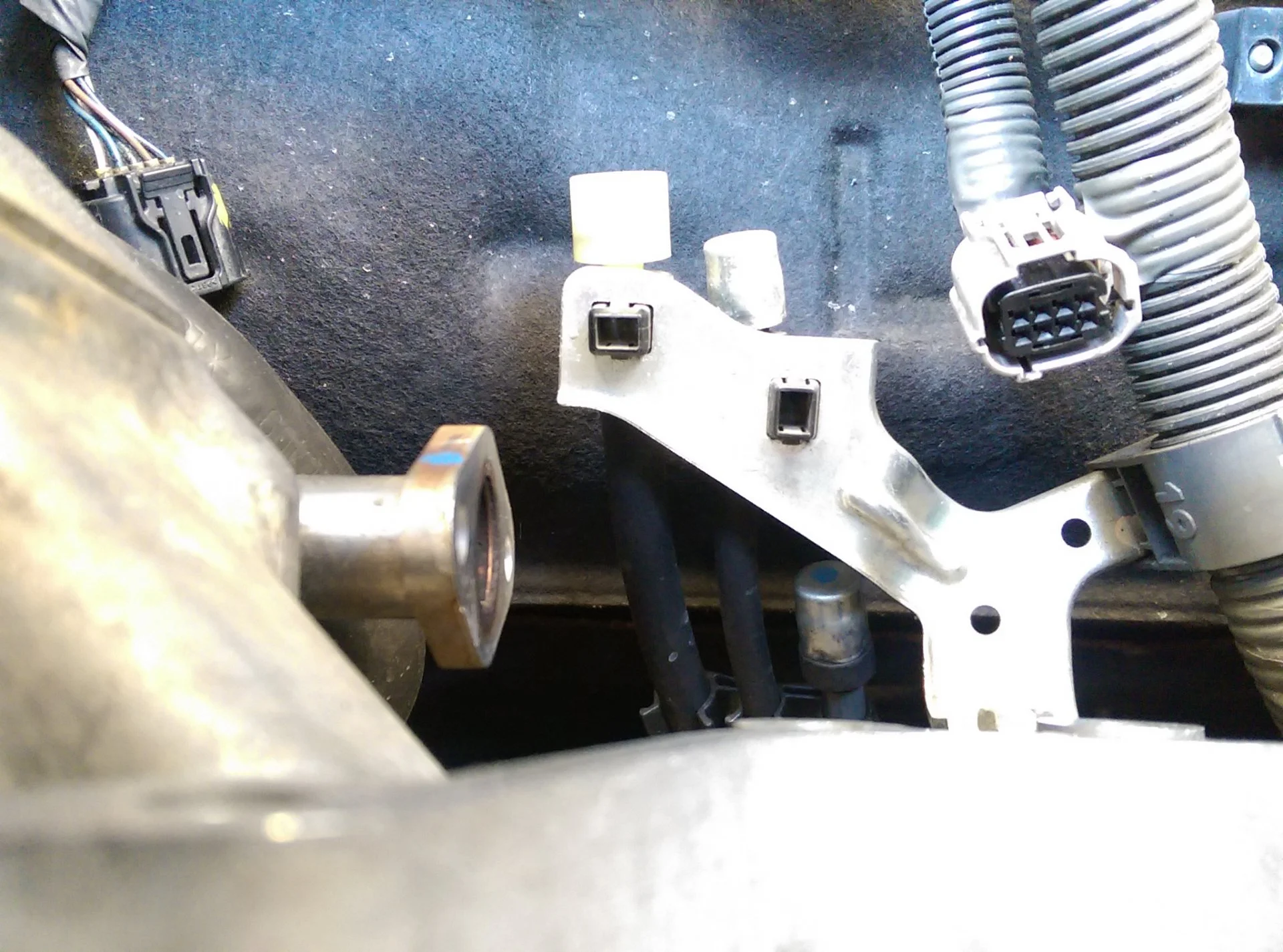

Anyone got a picture of these on a US spec gas 200? I can not for the life of me find the trans/transfer breathers. My exhaust pipe and manifold is in place and I don't want to remove the heat shield just to find them but is that the only way to get access to them? If I drop my skids will I be able to get to them?
My transmission was replaced in 2018 and now I'm wondering if maybe they could have forgot the breathers?

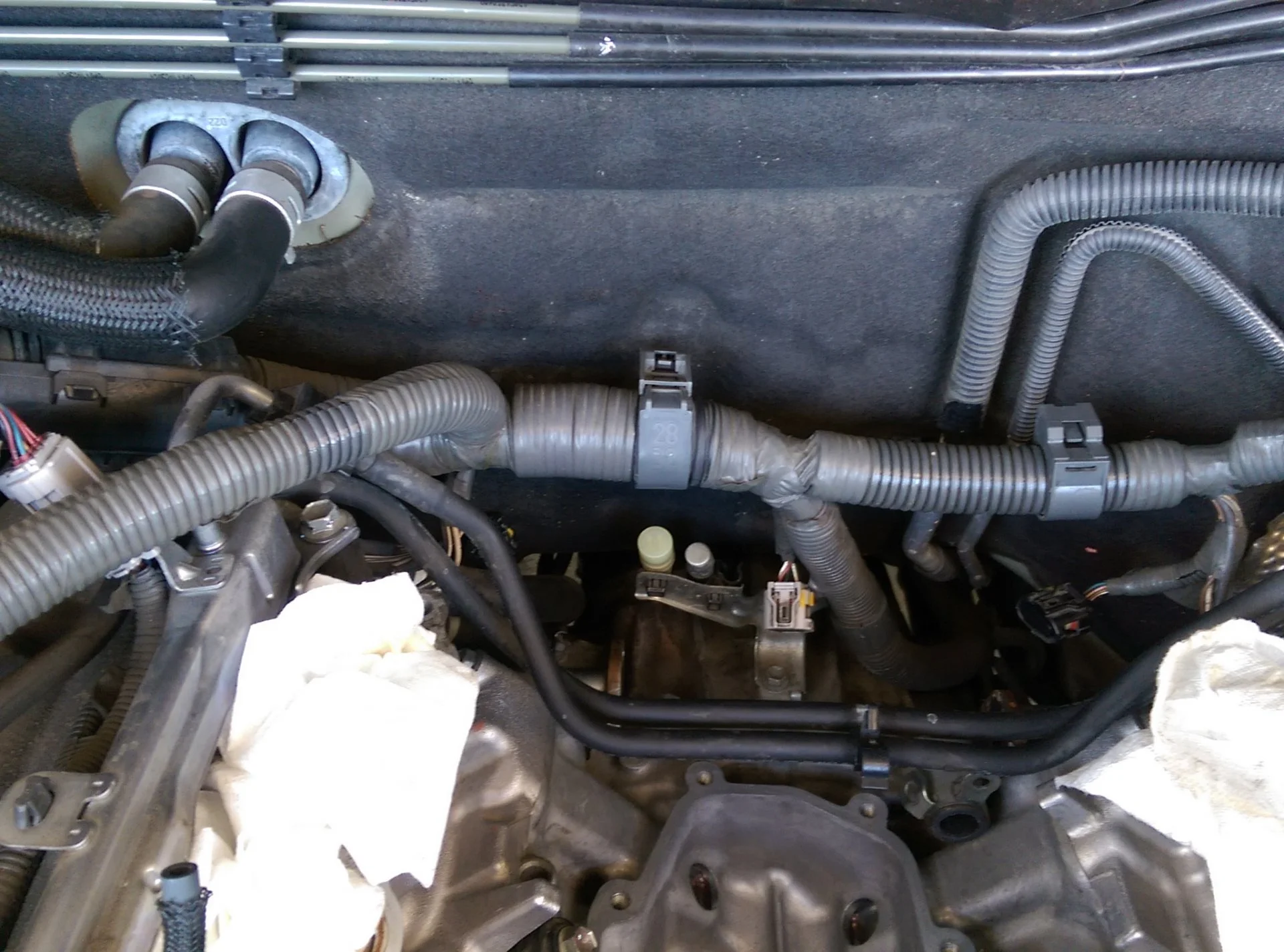

That picture looks pretty much the same as my US petrol as well. 3 (I think 3) tubes coming up the firewall behind the engine, on the left of the transmission.
Hmm. I see these tubes but I thought they were brake lines.
Are you saying the breathers are up in the engine bay on the fire wall?
Well, after at my actual truck, I don’t see any way to get to them from the top without removing the intake manifold. I also don’t think you can get to these breathers from the side without removing exhaust pipe.

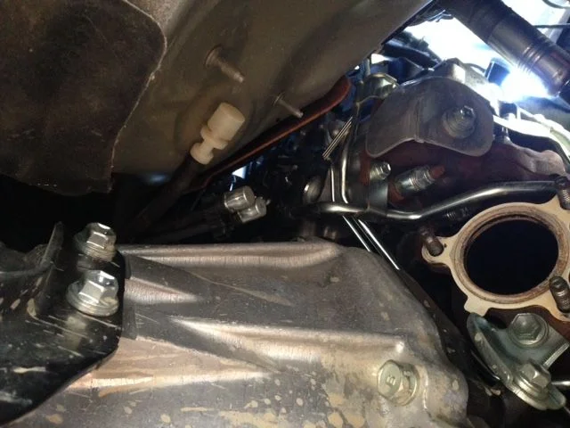

Had the 200 up on a lift and was an able to at least put my eyes on the tranny and transfer breathers. I do not see any possible way to access them without removing the intake and go in from the top. You might also be able to get there with the exhaust manifold and starter out. Unfortunately, I didn’t think about this when I did the starter.
After seeing where they actually are though I’m not that worried anymore about extending them. They are higher than the shock towers and about at the valve cover gasket level. You’d have to be in water higher than the top of the wheel well and I’m not willing to do that regardless of the breather location.
Also I bought a set of the breather valves because I thought I might want to replace them if extended them. The diff breathers are one way check valves. They only let air out. While it doesn’t hurt to extend them it shouldn’t really matter as they shouldn’t suck any water in. If you raise them AND use the ARB style filter instead of the OEM check valves, that might be better than stock as the ARB filter will allow air to be sucked in preventing the diffs from being at vacuum as you cool them during a water crossing.
