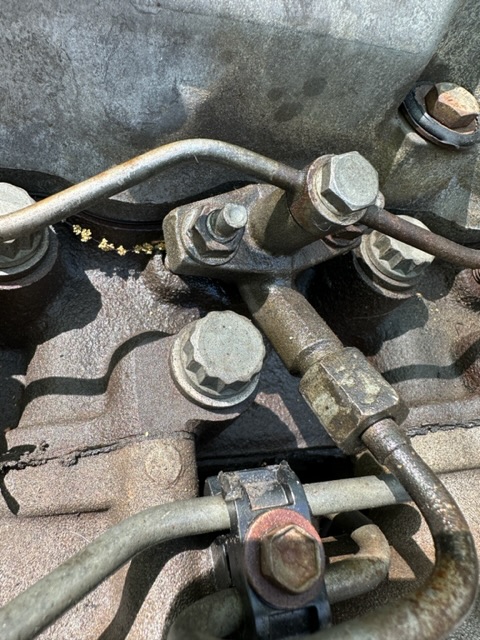

Funny but my new friend @mudgudgeon said the same thing… on the other hand, I have spent 7 weeks acquiring the necessary gaskets and seals to do the job along with the springs, nozzles etc. I do have injector #2 that has a light weeping around the cylinder head… I’m thinking that if I need to remove the leakage rail and some other pieces, it’s just a series of 6 other nuts to remove all the injectors and put them under a test.
if I go that far, I should pull them apart and clean them accordingly to the voice in my head. I have had successes and failures in that kind of thinking though.

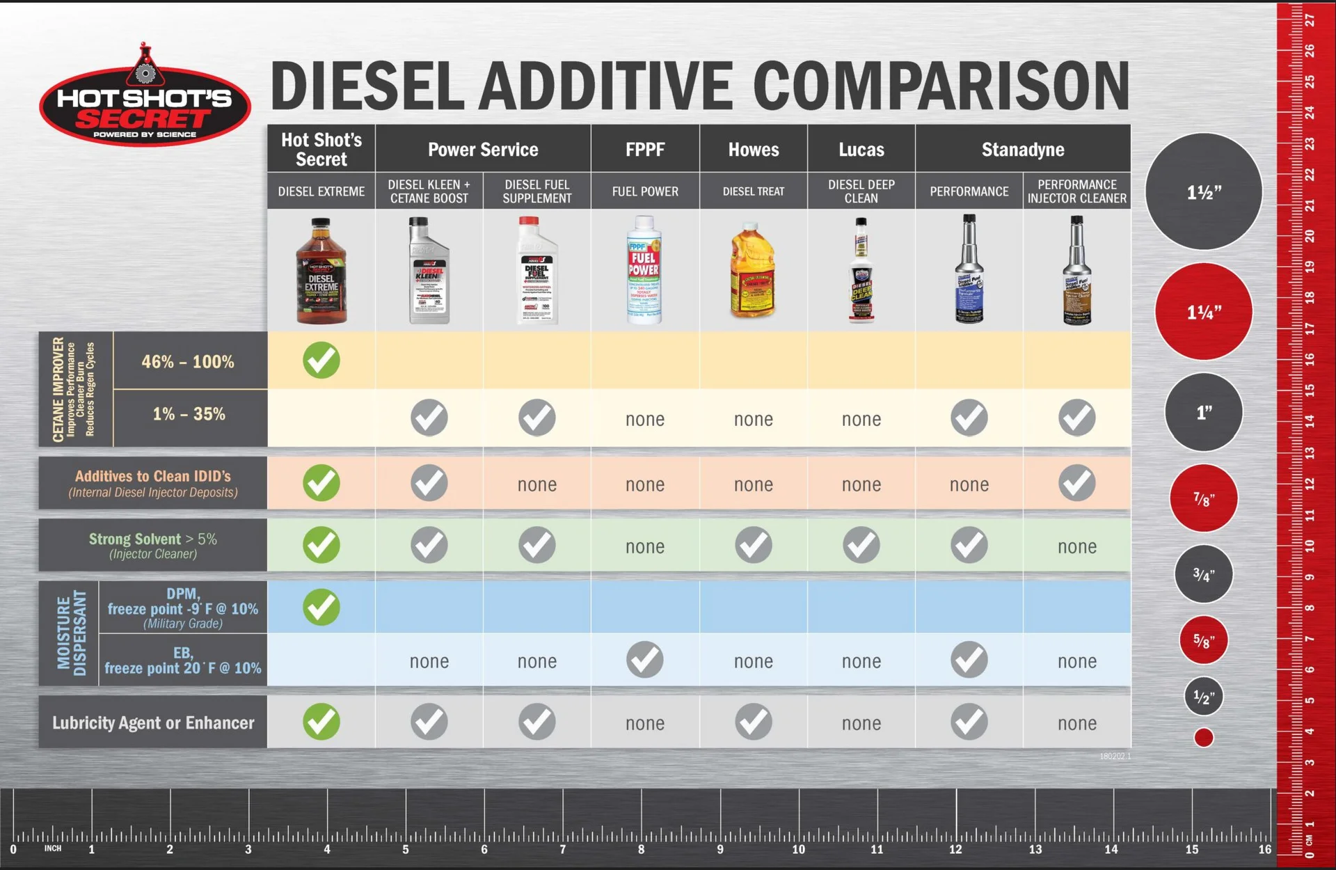

but when hotshots have big claims "Hotshot's says bring your oil head to head against "Black Diamond Outlaw Oil" it has me wondering.
I was on Amsoil 15W-40 Marine and now I'm trying out Hotshots black diamond 15W-40 with Sticktion eliminator.
I really wish there was a head-to-head test project farm style.
its interesting there not afraid to post there competitors diesel Kleen looks pretty good to
