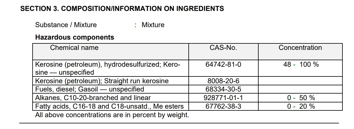

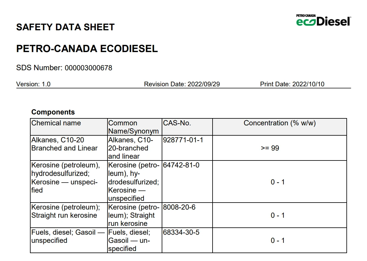

I'm not quite sure what's so special about Petro-Canada diesel looks like there are 2 kinds of diesel at Petro-Canada.
winter diesel aka Diesel no.1 seems to just have a higher concentration of Kerosine. but the ratio can change across Canada.
Regular Diesel and Eco Diesel
SDS sheet here
Regular Diesel
Eco-Diesel
I found this about winter diesel looks like the ratio can change across Canada.

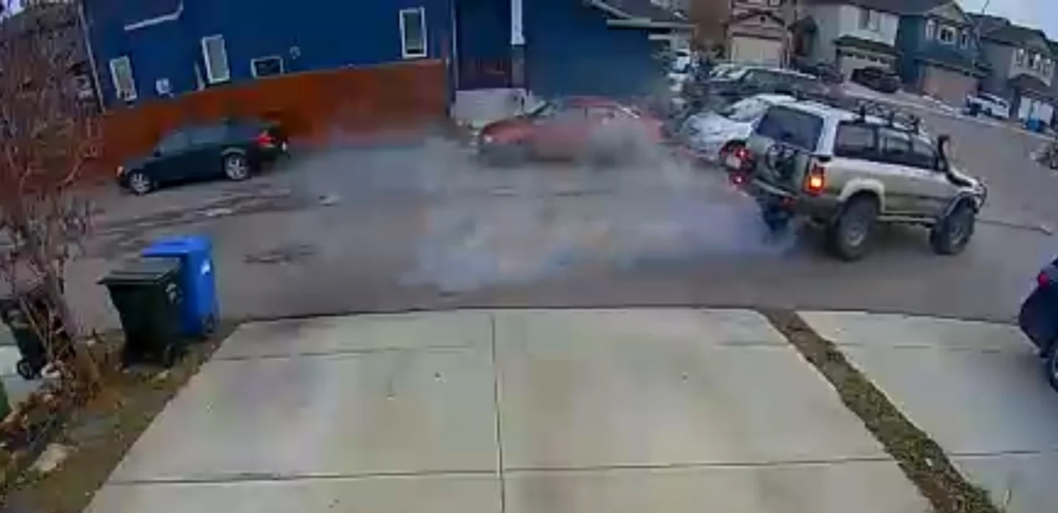

I think I have an intermittent air leak or clogged injectors but here is a before and after of running a double dose of Hot Shot's Secret Diesel Extreme in my fuel tank.
I think it should buy me time until I can save some money for an injector rebuild pump calibration and seal
It’s hard to believe in additives. But I know Hot Shot's Secret Diesel Extreme is one of the strongest next to BG244
as you can see really smoking just idle in out of the driveway.
after an hour of driving:
