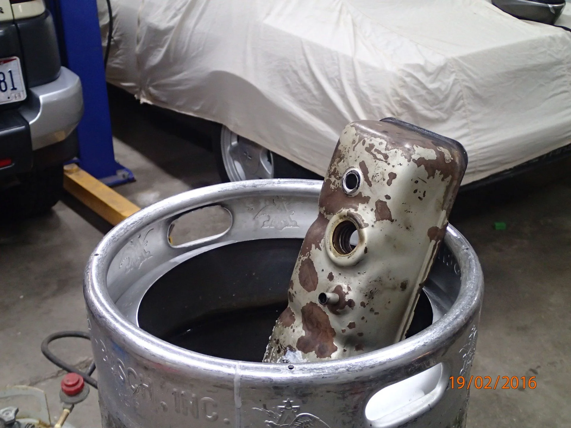

Sodium Hydroxide (Lye) is one of the few things that will dissolve carbon. I don't think you're problem is crusty carbon - but Lye will dissolve anything organic including the sludge in your tank (and your skin BTW.) On my 3FE the EGR paths in the valve cover were 100% blocked with carbon. A hot tank in Lye fixed it up.
