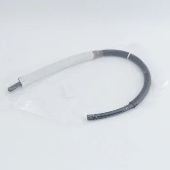

1@ - 7725960340 HOSE, FUEL HZJ7# this one maybe direct replacement for 7725960140
2@ - 9046716022 CLAMP OR CLIP(FOR WATER BY-PASS HOSE NO.6)
