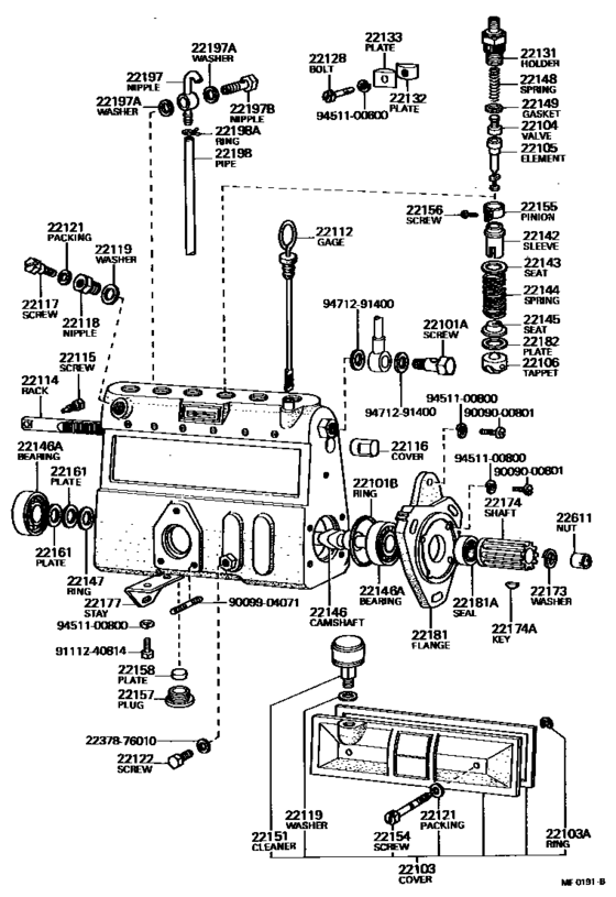

For interest, any photos of this pump? Especially the dipstick, and the drain plug you're referring to.
Sweet.. found the dipstick on a 1972 HJ45 parts diagram.. Has this vehicle got a stop cable instead of an ignition/EDIC shutdown?
