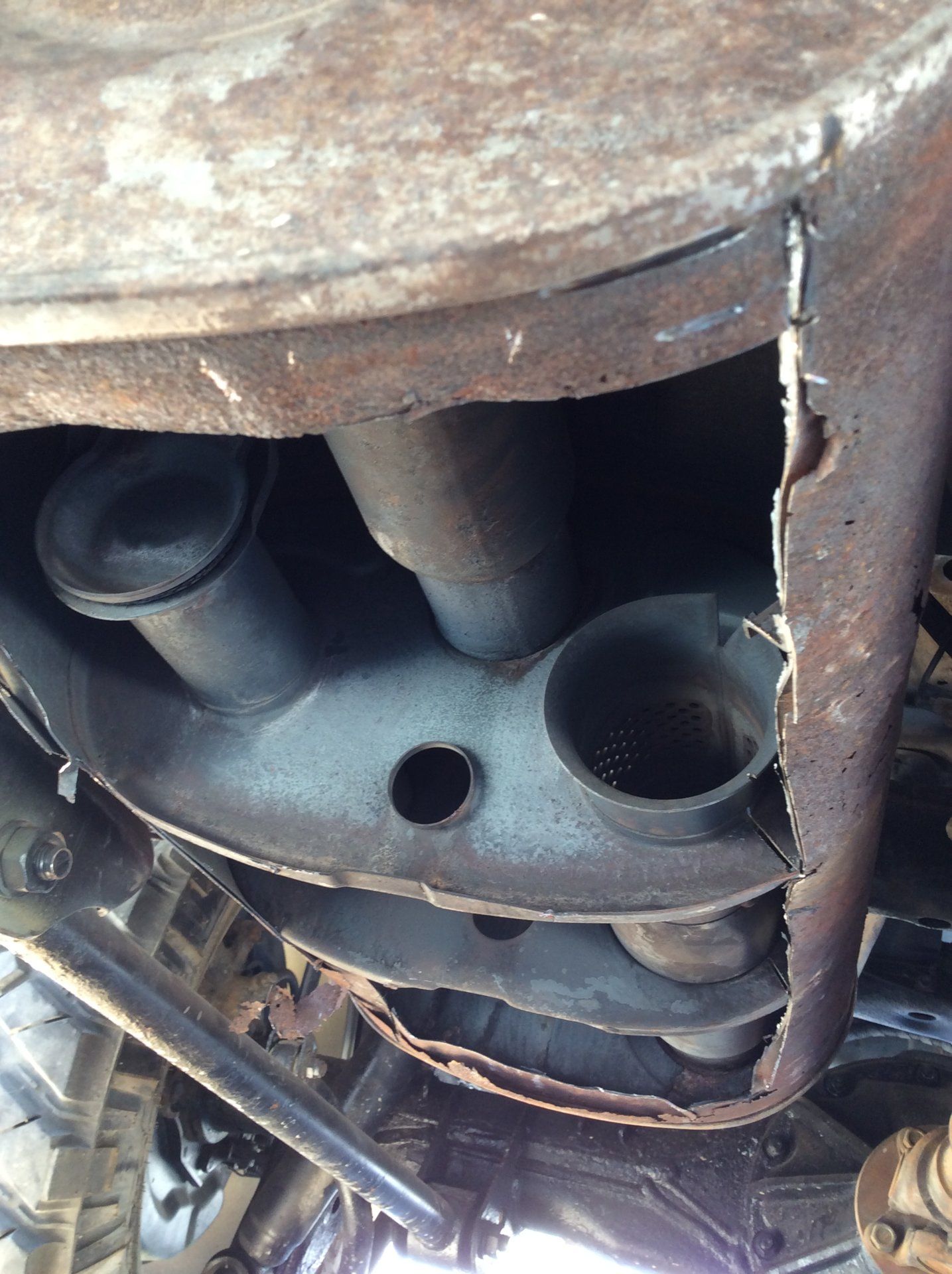

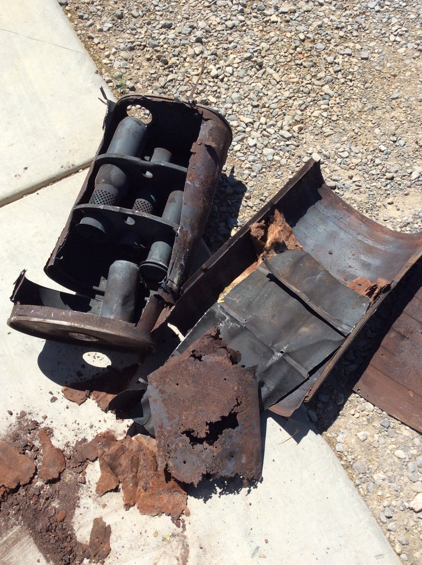

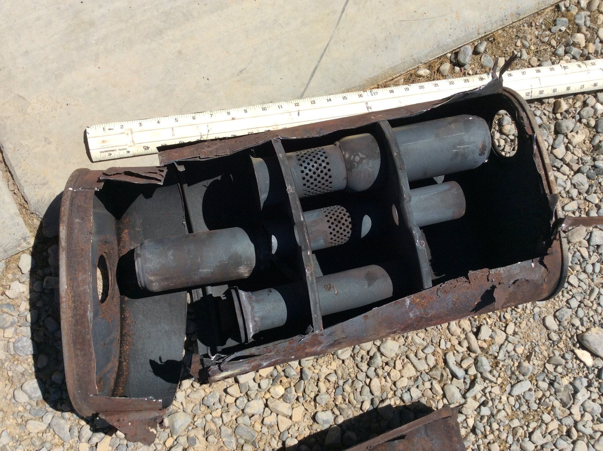

I decided yesterday since our LC isn’t a soccer mom vehicle anymore , i’m cutting off that stupid resonator and letting the engine breathe and getting back some horse power and gas mileage. I weighted it, the thing is almost 20 pounds. I haven’t ordered up the delete pipe yet. I’ll do it next week but for "grins and giggles" I started it up, I wanted to hear how it sounded with no resonator and muffler. I was honestly disappointed . I expected birds to fly out of the trees, all the dogs in the neighborhood to start barking, But our Ford excursion after I straight piped it was twice as loud as the 100 is....... it’s interesting how Toyota made this resonator .It’s wrapped in some kind of material, I don’t know if it’s a insulating material for sound or heat ,then there’s another metal housing or shell around it. The outer shell is where all the rust on the ground came from.

But on topic, the mufflers in the 2nd generation Lexus GS (and probably others) also work on that Helmholtz cancellation chamber design.

Thanks for the pics of the dissection. Always wondered what made my $500 oem replacement so heavy and pricey.

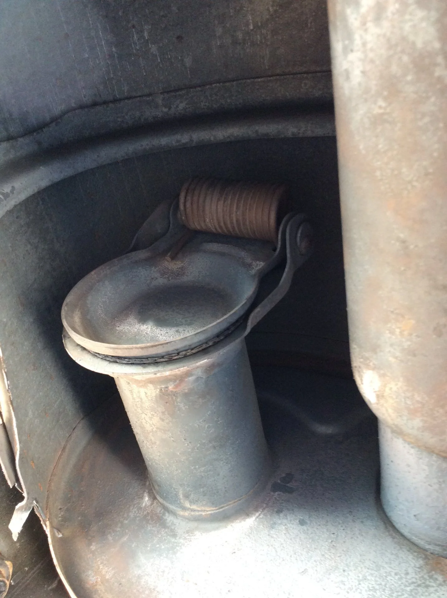

Very interesting! I love the one way self closing water intrusion valve! I had no idea that was in there and it's something I'm sure none of the aftermarket designs include. That alone makes the crazy oem price almost worth it. Because of that I will definetly consider going oem at next replacement.

Where does this valve let water out? Exhaust is full of water
I think it is to reduce or prevent water from flowing IN thru the tailpipe to the engine in case of an engine stall during a water crossing.

Not for water intrusion. Ads back-pressure at low RPM for improved torque curve. Then opens to let the engine exhaust better at higher RPM.
I assume it doesn't improve performance at low RPM and is solely for maximum noise baffling?
How does more back pressure increase torque?

I've thought about doing a mod to have that flap valve be open all the time. Anybody else thought about that?
