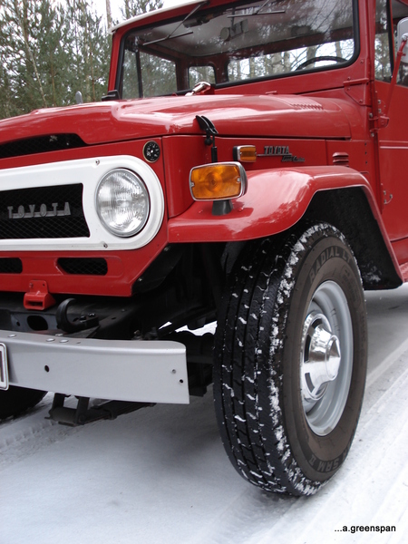

Ok- got it figured out. No safety bead. My tires will be be aired down but not too low. I'm going to run it. I'm not to worried about the bead coming off at low speed. I was more concerned about road use. Peter's link was a good help:
Wheel tech - Tubeless tires & Safety rims
This guy has put his wheels to the test with standard rims and had no issues. My 72 BMW 2002 is built like a rally car and I have put those wheels through all kinds of stuff with no issues- even on r coumpond tires. I drive my bj44 like a baby on the streets and specifically going around corners just to preserve tire wear so I think I'll be fine.

Sorry guys- I'd sooner buy another set of tires just to use these.
I found 2 sources that say the "K" designation simply refers to the height of the lip. The K is .77 inches. My tires match this height just fine. Just a little enamel on the insides where they are rusty spots and the tires will go on. As well as the hub caps.....
No humps but hey....

I just heard back from STA. Their tires are designed for J profile flanged wheels. However there is not problem what so ever running them on K profile.

Thanks Pete,
love my trucks too. ;)
Decision was that these rims were developed for running tubes.
Don`t know if there is any advantage with the tubes in them.
Tyre pressure I run on the tube tyres is 2,5 Atü on all wheels.
