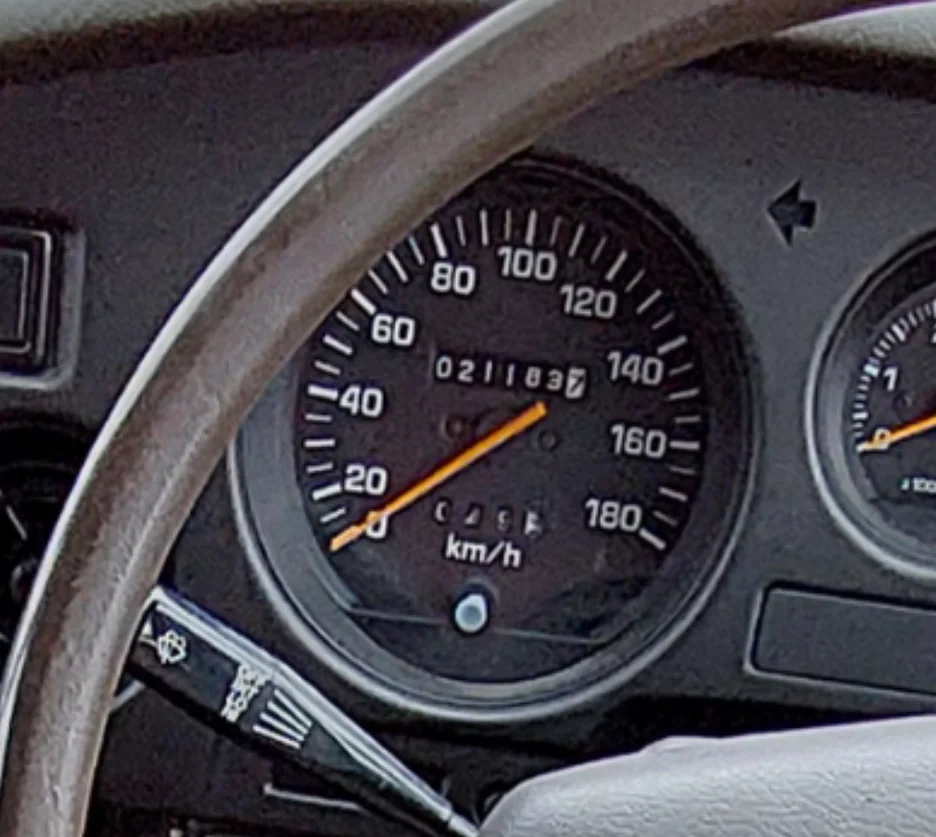

Doubled it's lifetime miles in less than a year of ownership.
It's been to Texas, Oklahoma, Kansas, Missouri, Illinois, Indiana, Michigan, Ohio and Kentucky.

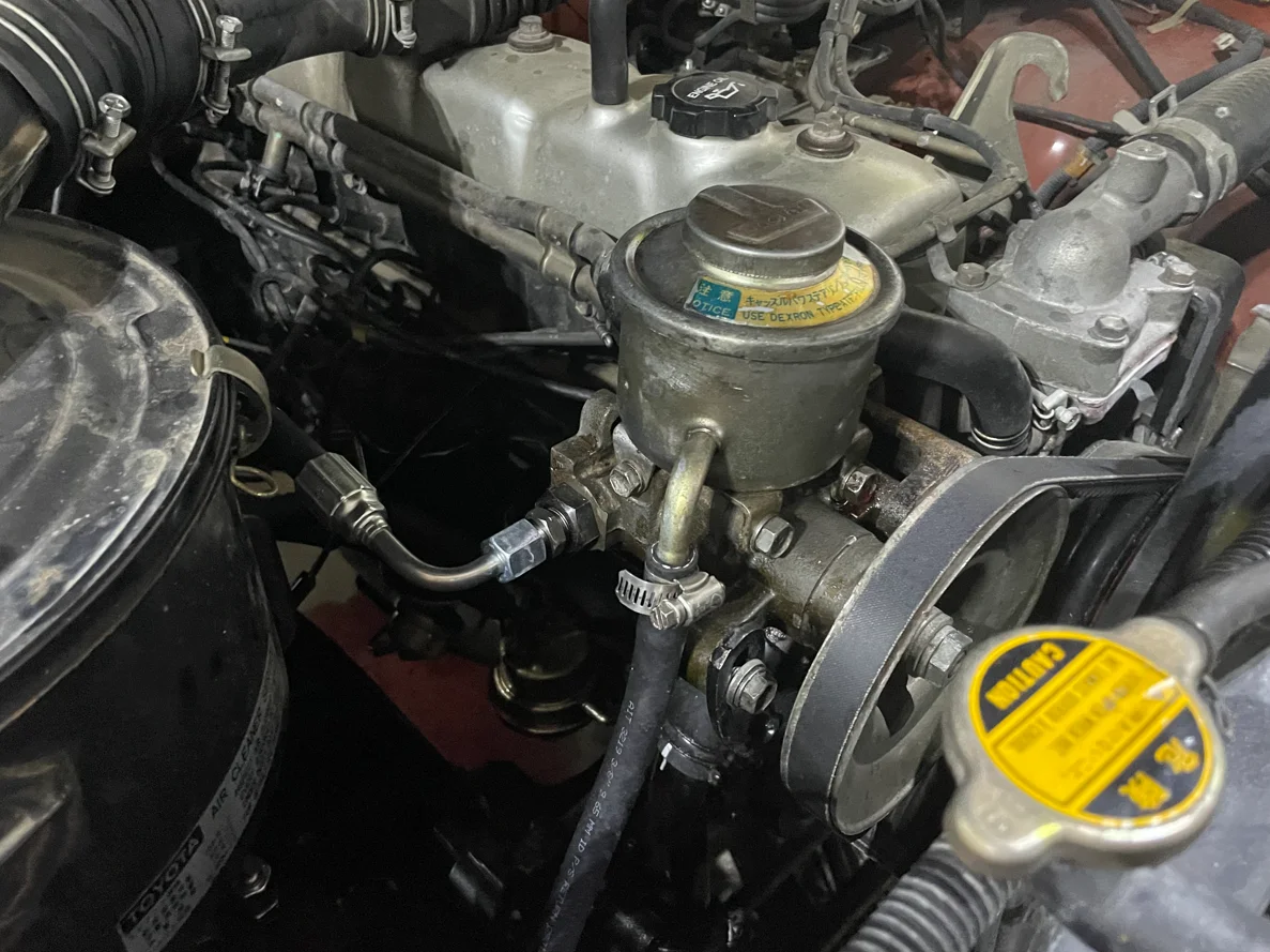

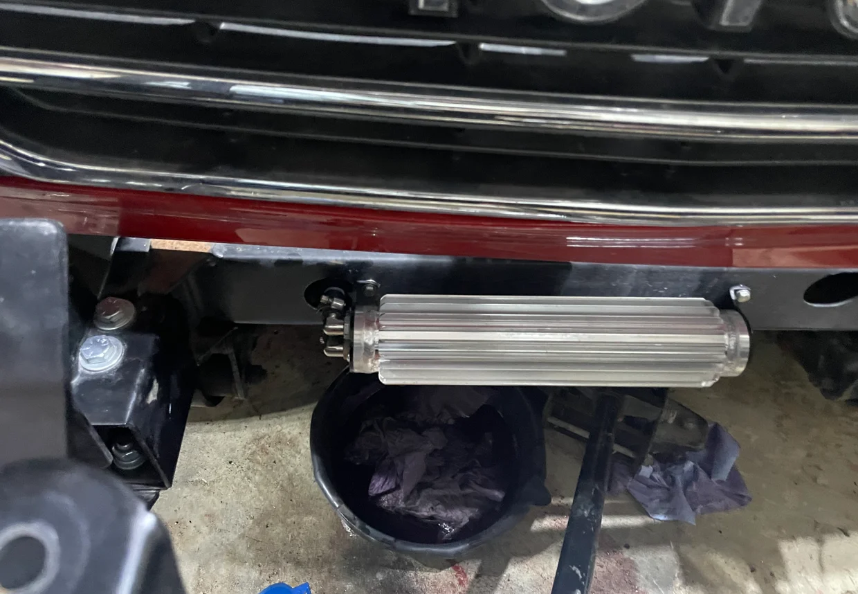

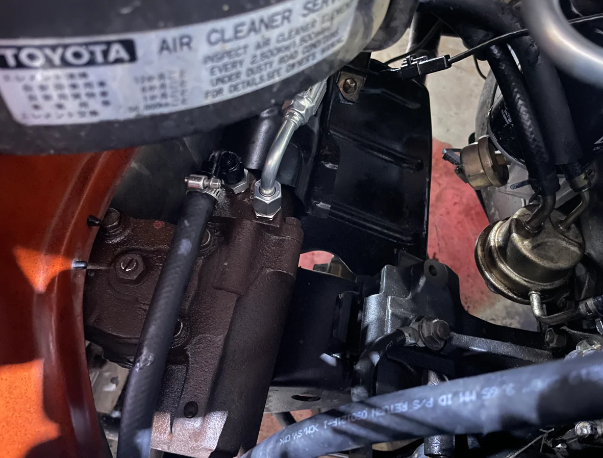

Over the last year I've sourced a factory FJ62 power steering pump, a RHD HJ61 power steering box (Thanks Jimmy @CenTXFJ60), Derale steering cooler and some custom hoses to add power steering to the Fire Truck.
The truck was fully functional on-road with the manual steering box, but off-road it was really hard to run through some obstacles. I can't wait to test it out with the new steering setup.

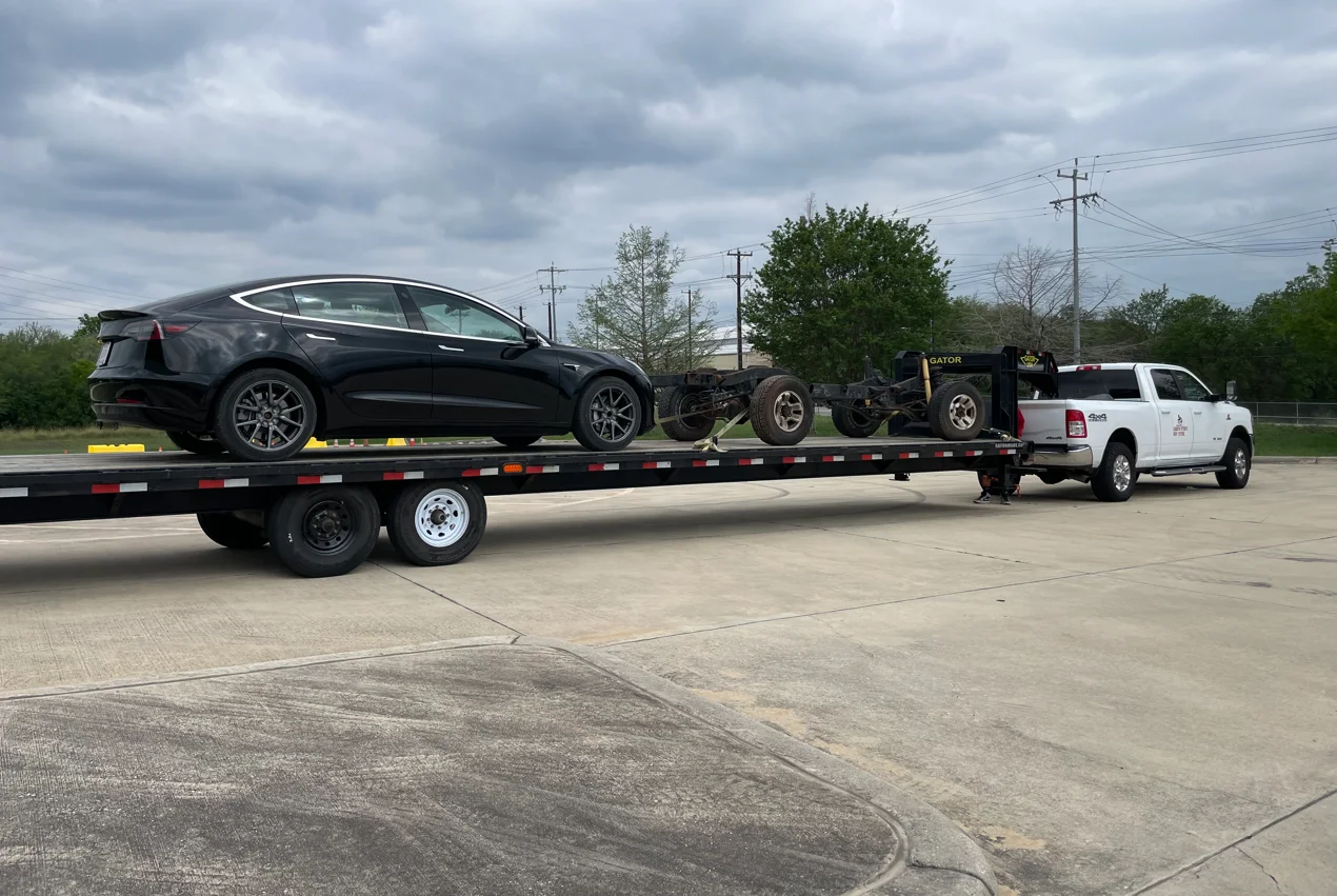

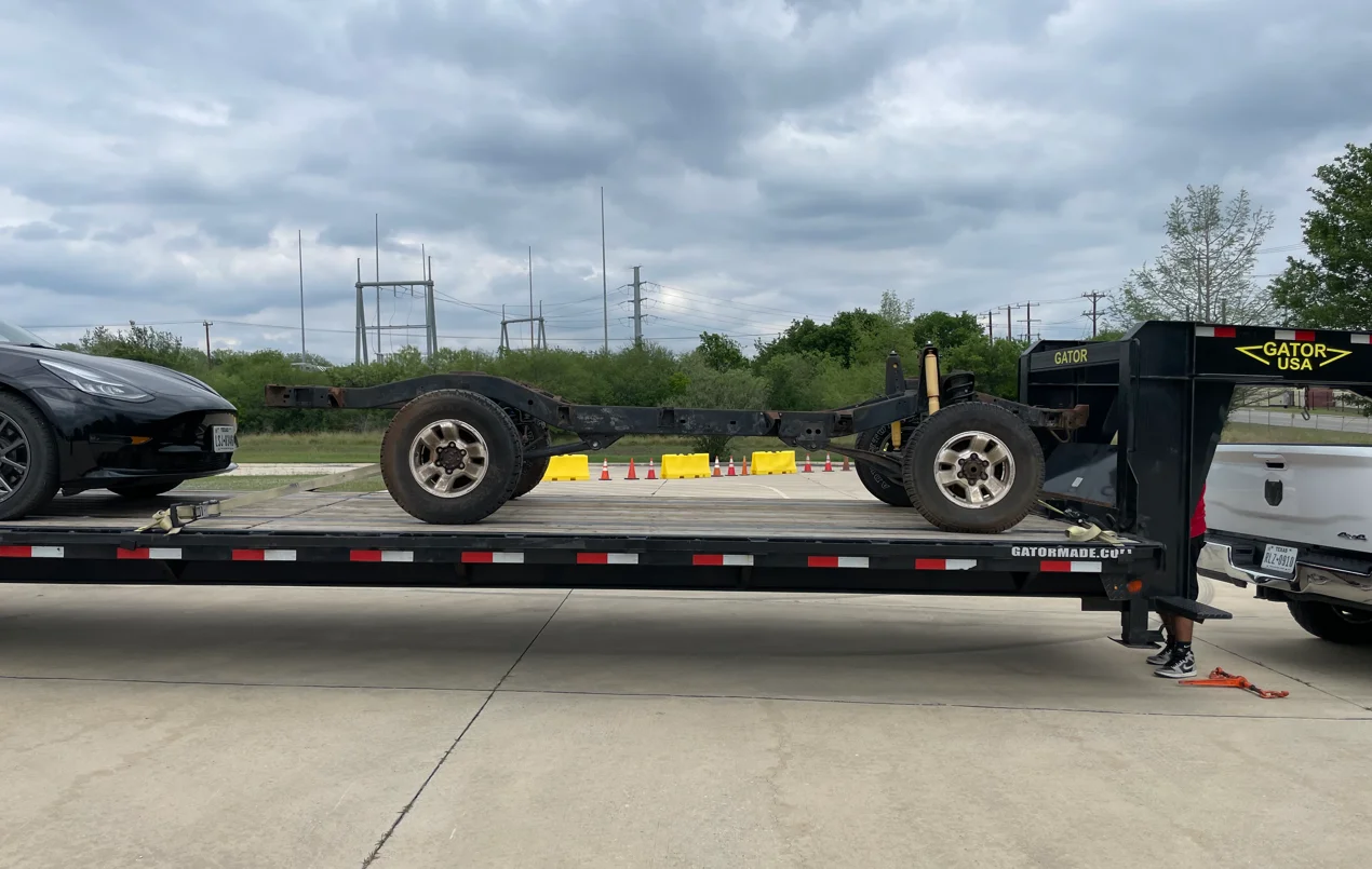

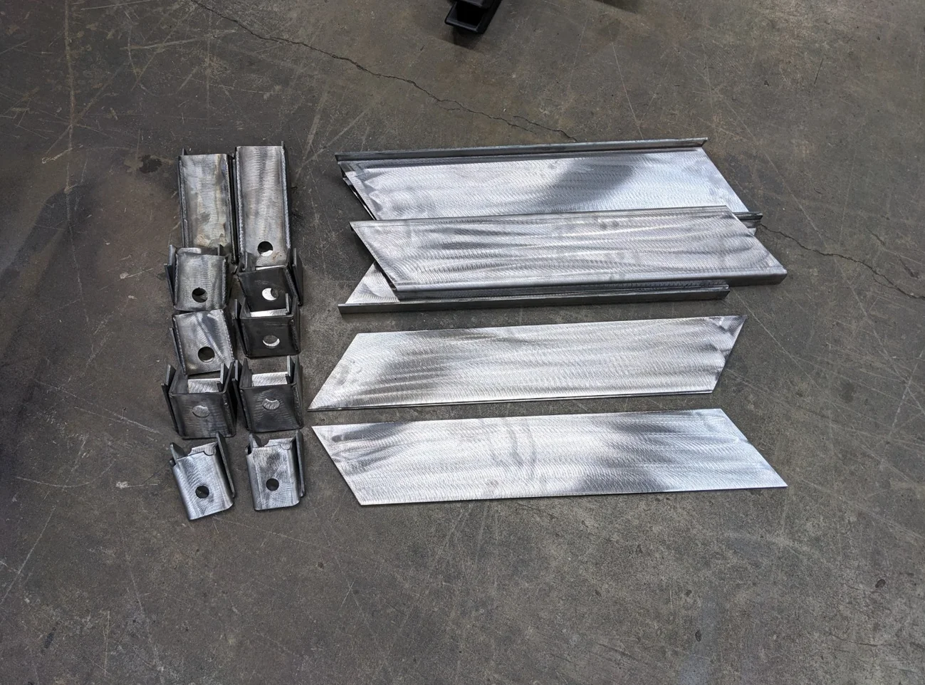

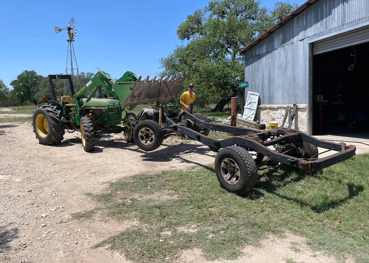

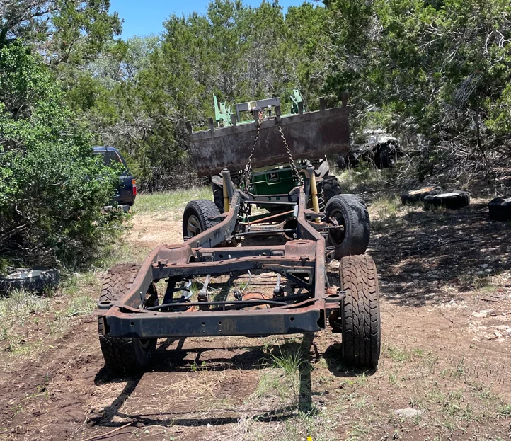

From the first time I visited Jimmy's @CenTXFJ60 Barn for a beverage and Cruiser talk, I had my eye on this RHD 80-Chassis sitting in the back 40. I recently convinced him to let it go, and it's on a truck headed to Michigan as we speak. I also secured some 60 to 80 body mounts, and a set of 20" Ute stretch plates from @TRAIL TAILOR .
Detour is officially getting an additional 25" of wheelbase, Coils, etc... I made a deal for a locked front 80 axle from @RocketCityCrzrs, and an open full float rear (for now), however the housings are setup for lockers. It will also be getting a longer Ute tray and probably a headboard. Power is likely coming from the stock 3F for now, but that may shift to an LS as the build develops.
The chassis will be a slow build, and I have lots planned for the truck before we make the switch!
