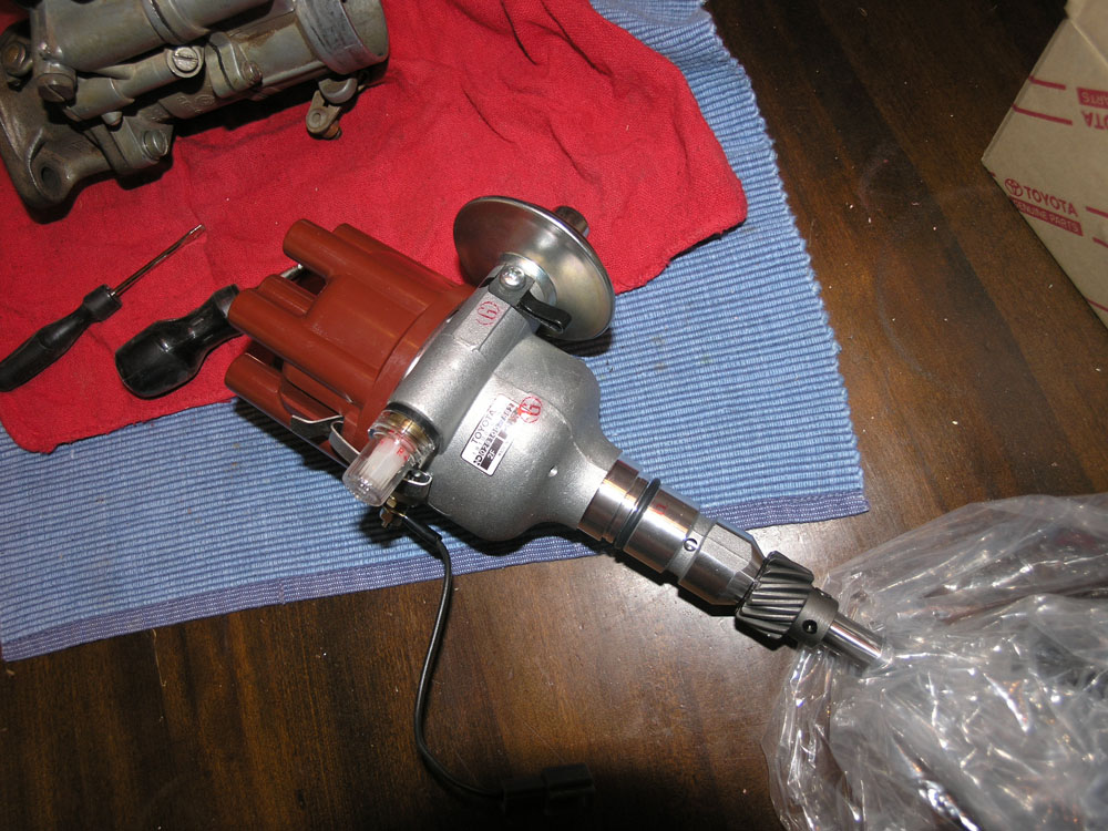

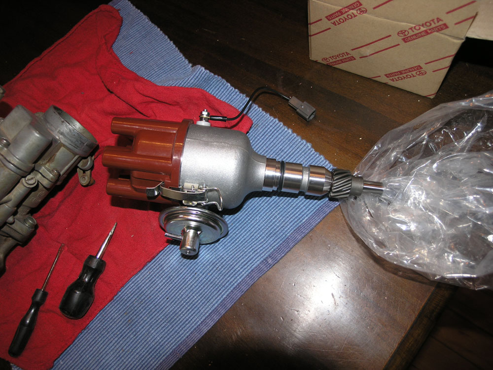

Found this OEM dist that is said to fit my 1964...
says 2f on the label though... thoughts?
That's the distributor I have.
I got a new timing gear to go on my new cam. I suppose you'll have to see how yours looks.
