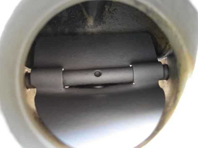

so if I Pull the 2 exhuast bolts and shine a flash light up there is should look like the image below ( which means in the full "hot" position correct?

Correct, all direct exhaust flowing through pipe. Mine was stuck and as the repair parts do not exist, I got the valve working and hooked a spring to keep it fixed. As it gets very cold here in the winter I can remove the spring/operate the valve if needed. Bottom line if you can't move it by hand it's a problem.

I believe destin he is asking if the high riser was frozen before the rebuild. Not the valves in the head. The extra heat on the intake might explain the warped carburator.
yeah when i first bought it it was frzen in the cold position.
i then freed it up and placed it in the hot position :)
Very likely what warped the carb originally.
But that is all old news :D
However i had the intake exhaust remachined at PER, and i am questioning whether or not they pinned it in cold or warm.
And my question is whether or not that could have blown the head gasket :D
