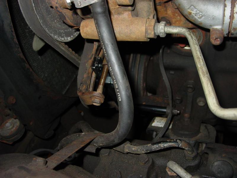

Here's where the pulley goes.
And a pic of sorta what it looks like installed. Best I could find on the harddrive today.
