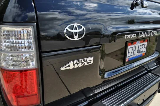

Depo LED Tail Lights
Kind of dirty....
How is the brightness? There an amber or red signal?
The only part of the light that comes as an LED is the brake lights and they are slightly brighter than stock as to not blind anyone braking behind you.
The turn signals are regular amber bulbs with no difference in brightness but you can buy LED bulbs for this.
I replaced the reverse with CREE LEDs to improve visability when driving the trails at night
Here is a comparison on those vs stock
