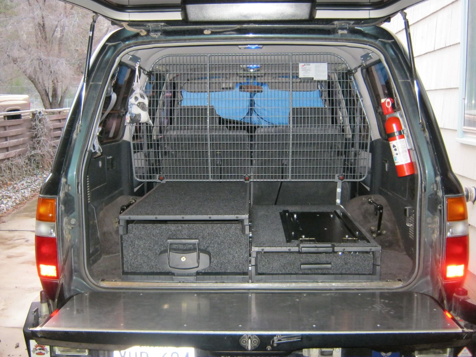

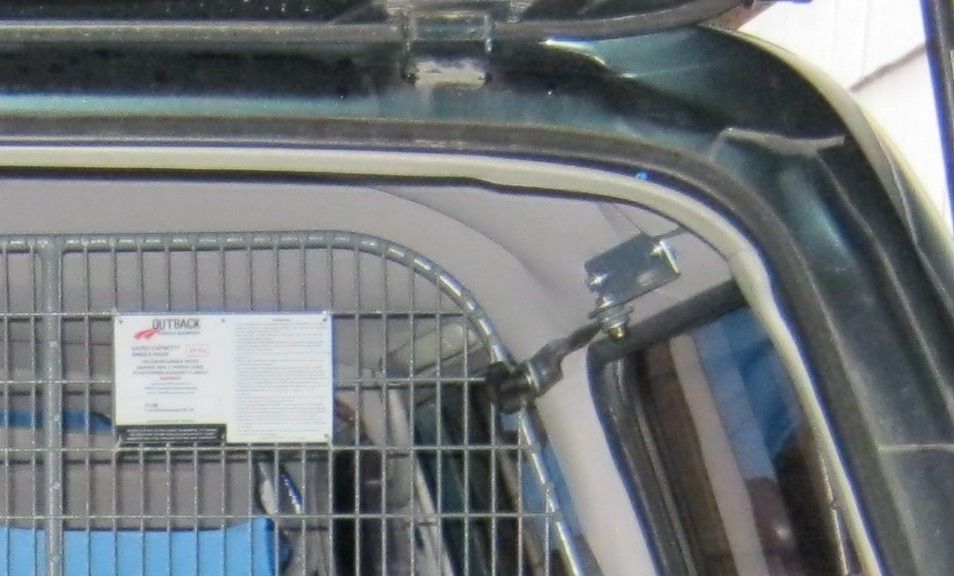

Been wanting a Delta VS ceiling storage rack since it came out, but had other priorities and now that it is shipped and soon to be here, I read through this thread to check it out more closely, since I already have an Outback cargo screen and drawer system. Yeah, research should've been done 1st, I'll admit, but quick analysis when ordered looked like there'd be no problems. Looking at pics in this thread and pics that I took during install, the rack should fit nicely behind Outback cargo screen. The upper screen brackets were a concern, since they also attach to 3rd row handle mounts, but the transition looks to be doable. Also, I'll move my inverter, which is now mounted to the Outback cargo screen, to the inside of the Delta VS passenger side widow panel (which is also ordered) and that will allow the cargo screen to be removed occasionally when needed. This will also be replacing a homemade storage shelf that I mounted to the back of the cargo screen. Removing this shelf will also allow the cargo screen to be removed since the Delta VS storage shelf is mounted to the ceiling, not the screen.
Existing upper cargo screen mount:

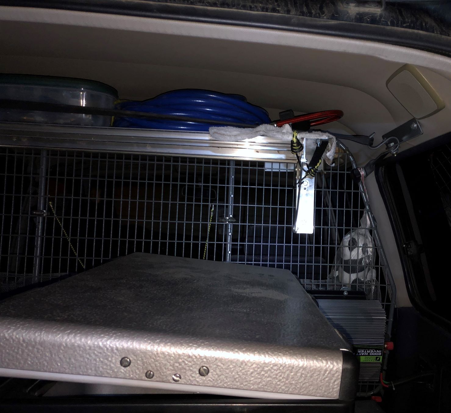

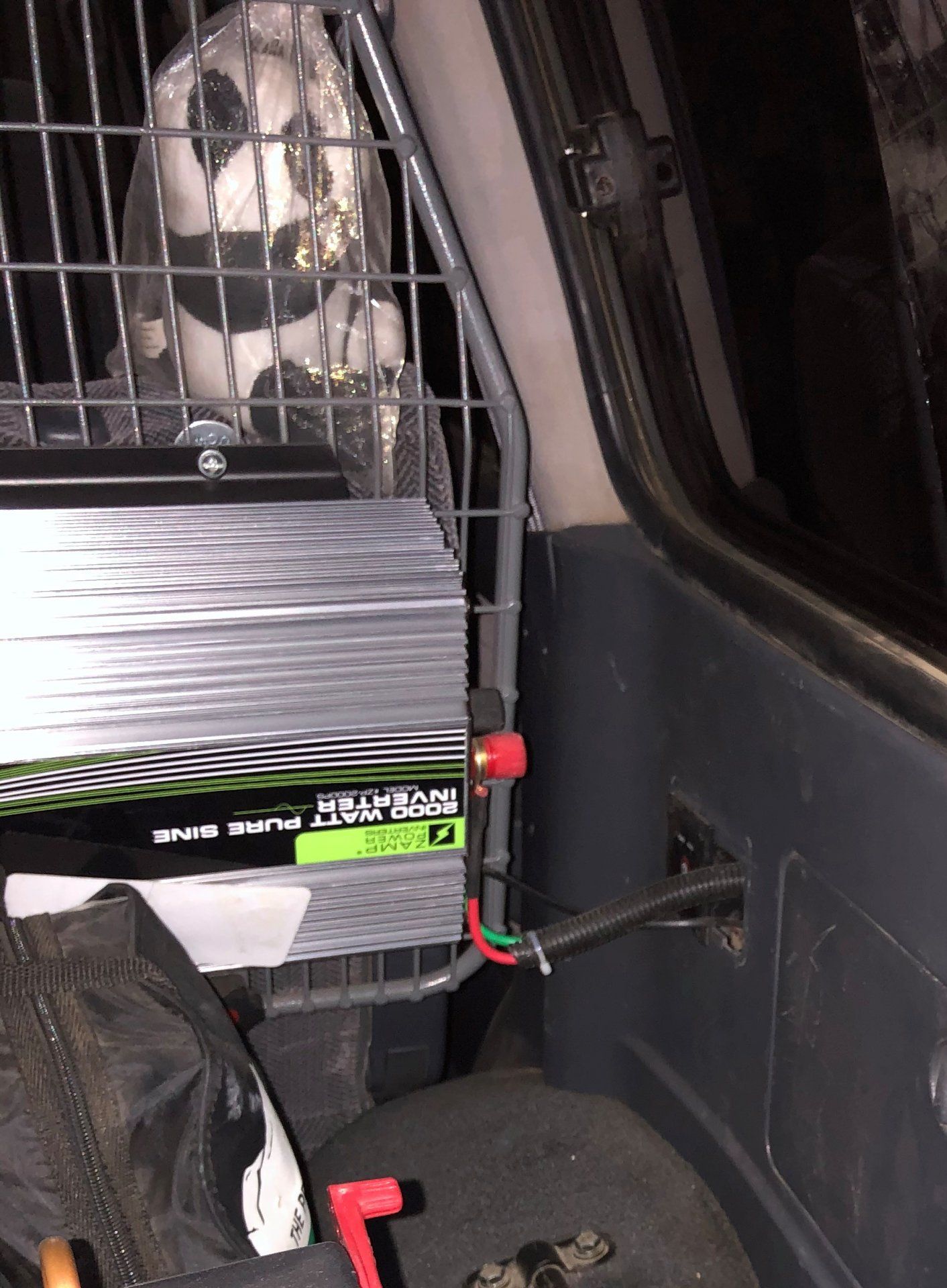

Inverter mounted to rear of cargo screen, lower passenger side:
Full rear view of Outback cargo screen after install 8 yrs ago:
Front side:

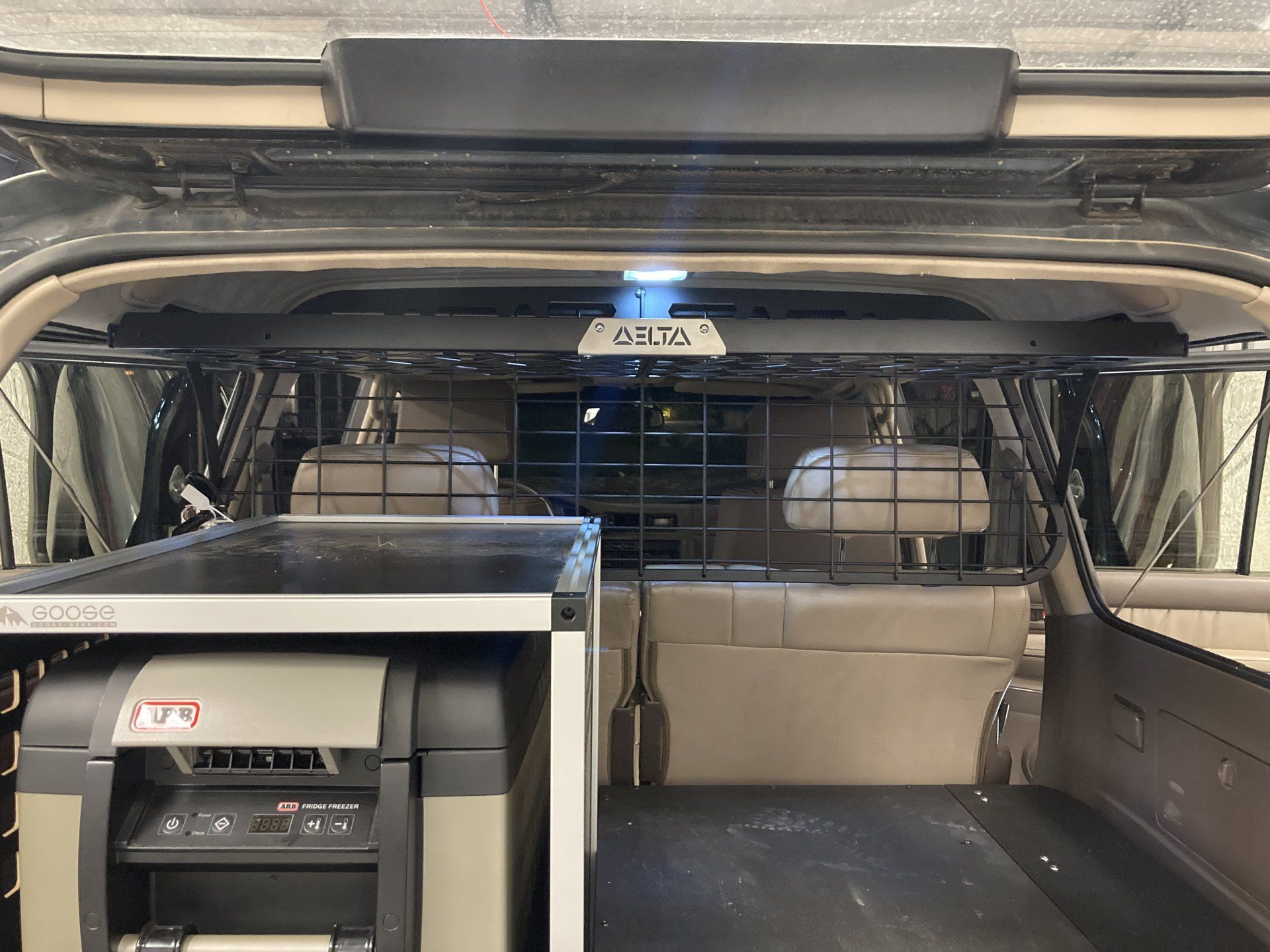

@Dirty Koala Good news - the DVS Ceiling Storage Rack will work with our Outback cargo screen. The bottom 3 mounts stay the same (duh - obviously), however the top 2, one on each side - the bracket that originally ties to the 3rd row handle needs to be removed and I'm still working on a way to secure the cargo barrier to the DVS rack. I took a few quick pics to show the fit:
The Outback cargo barrier fits nicely up against front of DVS rack by wedging the top mounting tabs underneath:
Also good news for owners with the older headliner - it fits fine:

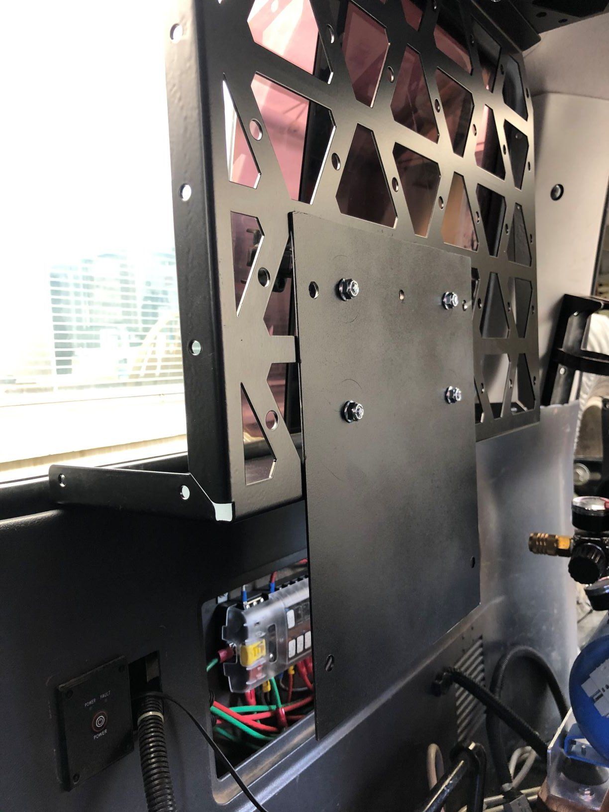

I also installed the right or passenger side window panel before I decide how to secure top of cargo barrier. Also am mounting my inverter to the window panel so more pics to follow when this project is complete.

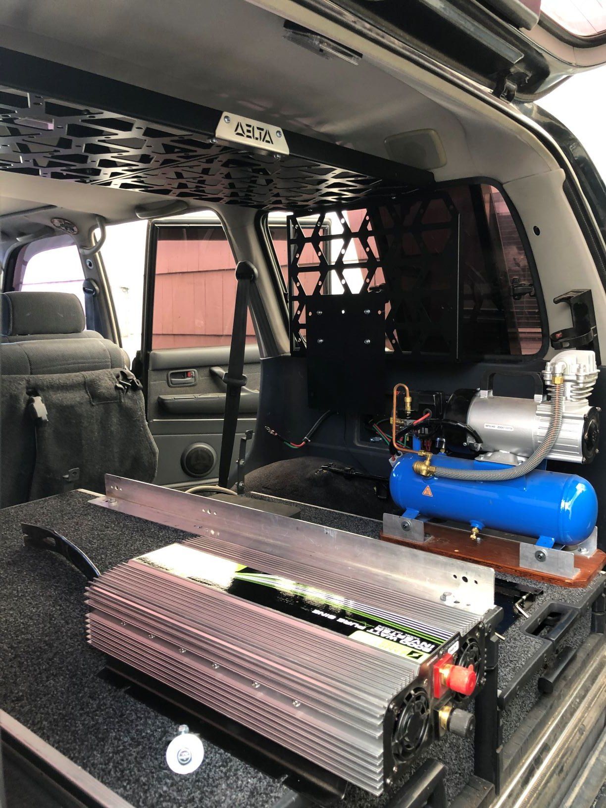

Fabbed up a plate to mount inverter to the window panel. I like the location better than mounted to the cargo barrier. I'll now be able to remove the cargo barrier easily if desired. For now, the top of the cargo barrier is secured to the DVS ceiling rack with 4 heavy duty wire ties. I plan to secure it with modifed brackets eventually.

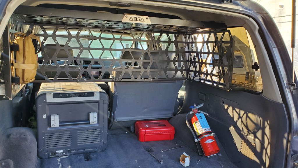

Plate mounted to window panel:
Finished install - ready to load fridge and gear:

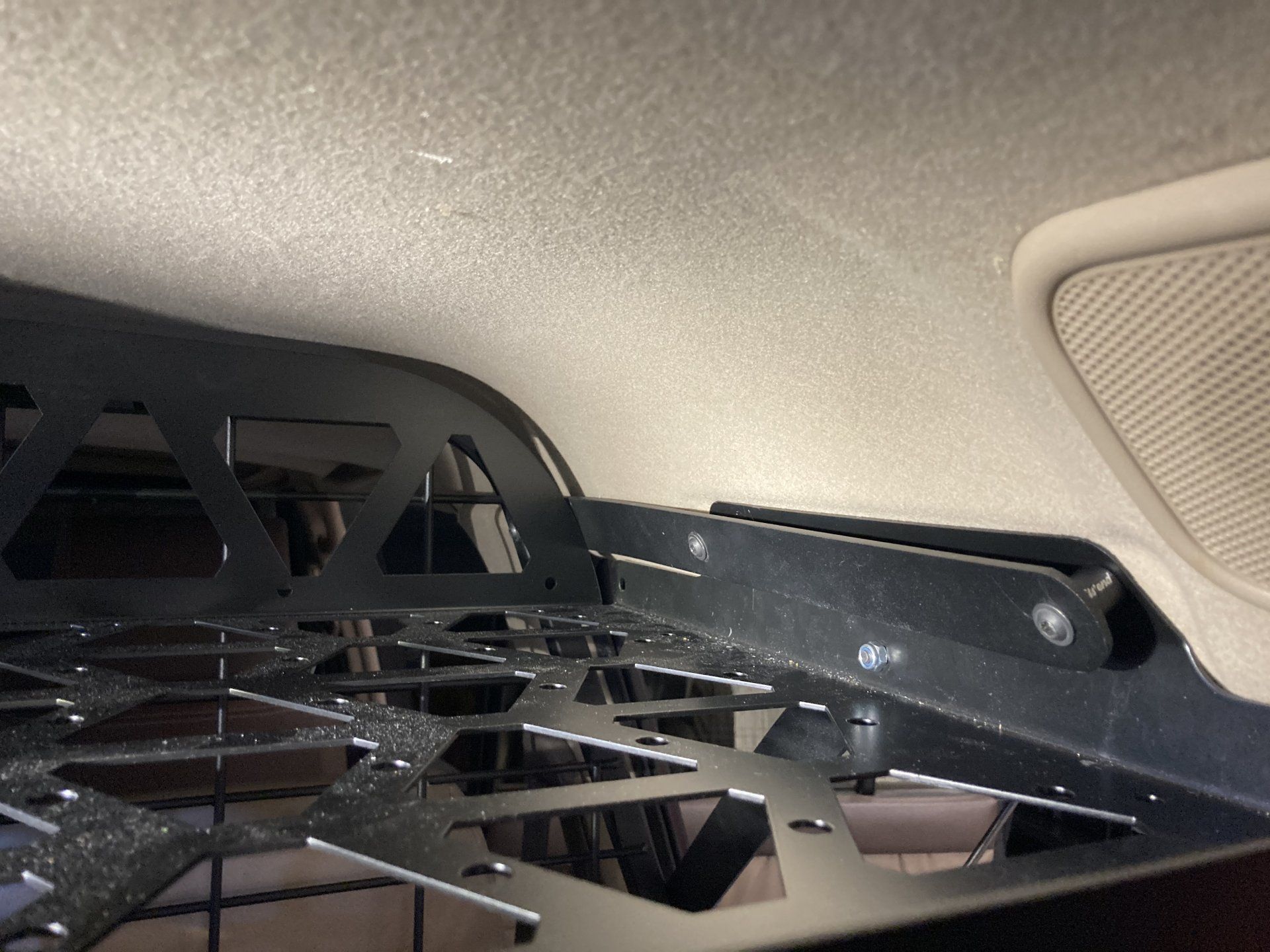

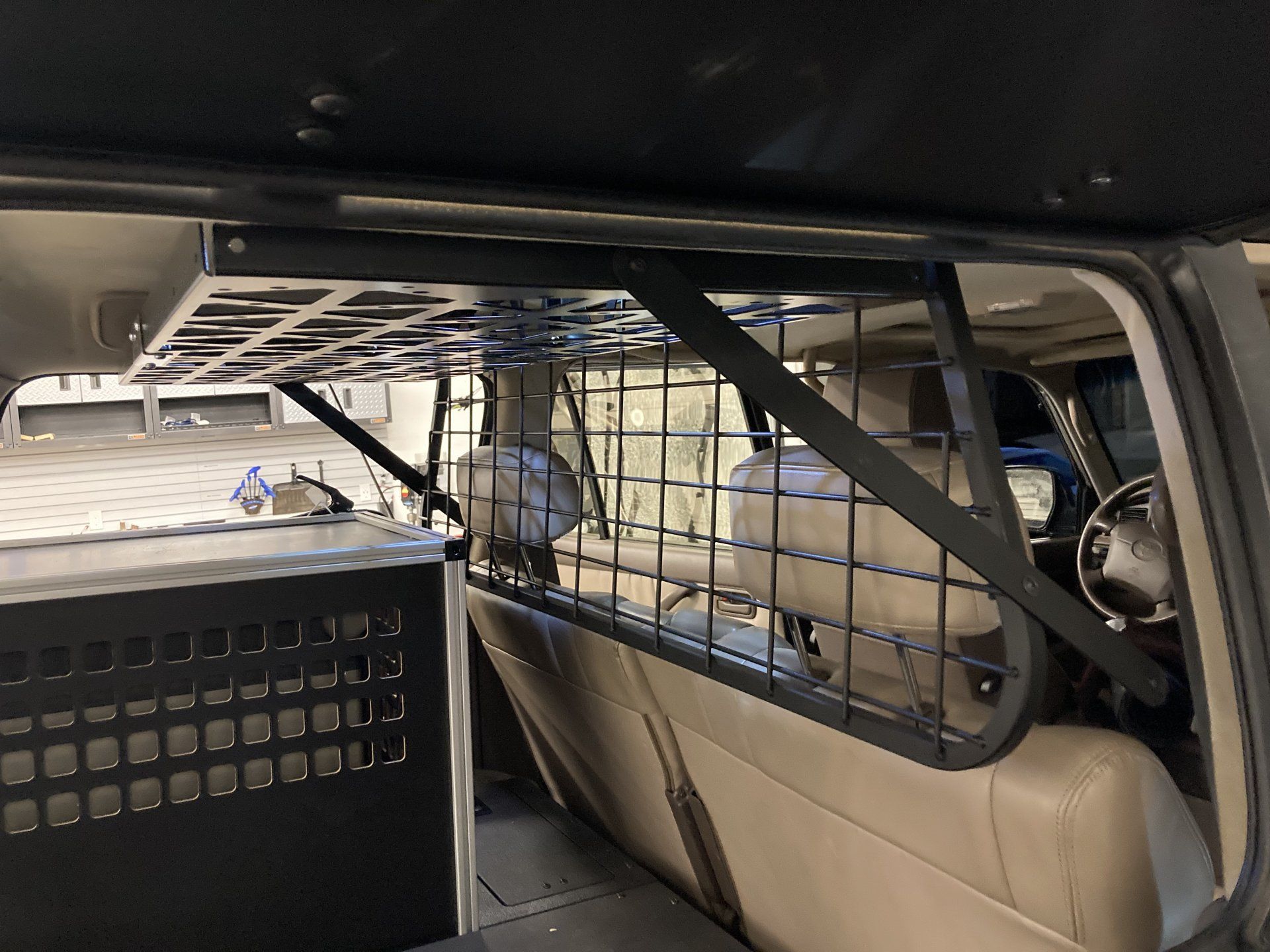

Finished installing my ceiling storage shelf tonight. I have the Speski cargo barrier installed also. They are compatible with each other with the exception of one modification to the lower Speski mounting strut. It is a bit of a pain to mount the shelf with the upper Speski strut and the spacers. Definitely took two people to do that, with the shelf sitting on top of boxes and wood to hold it level in place. There is some distortion and twisting of the Speski struts and I will need to trim the length of the lower struts now that the install is done and I can mark the length.
I think the combo would install better if I shaved 1/8" off each of the spacers that the Speski rack uses. But, the struts flexed fine when the bolts were tightened and the combo is rock solid once every thing is tightened down.
There is a convenient hole in the Delta shelf that I used for the lower Speski strut. Did not even have to drill a new one..
