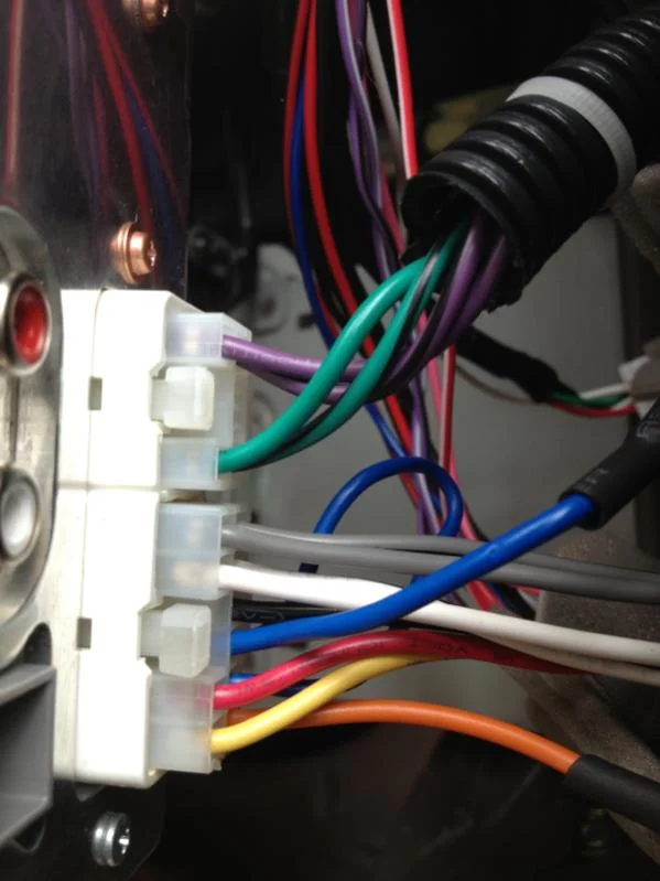

Here's my HU harness. Orange is spliced into green (dash harness).
I tugged on the splices but did not yet test if there is a connection. I'm starting to prefer solder&heat shrink over butt ends.
UPDATE:
For the Scion t1819 (PTR546-00120) head unit the Illum - wire (#5 in the 6-pin connector) should be connected to the White/Green wire in the stock LX450 harness.
When connected as above, if you turn on the headlights the buttons of the head unit illuminate and the display remains visible.
