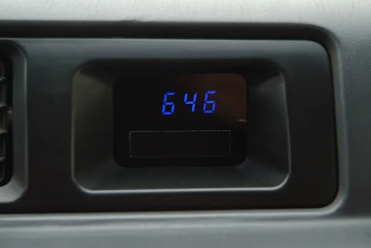

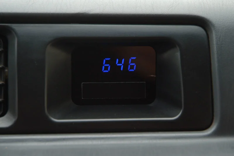

Got any pics of the warm white? How much for all 3 and the doors?
LJ_24 said:Do you want the doors to be warm white as well?
Did you check out the 80 series LED madness thread, pfran has a great kit in store if you are not picky about the "warm" white! Mine and pfran's kits are similar but he does not have additional color options and I believe he provides backup dome lights in the kits(which is a plus for those who want to be on the safe side in case a panel or bulb fails)
The price for the color matched warm white components to cover the whole 80 series is $54.90 shipped to your doorHigh powered 5050 SMD LED are what comes on the panels and bulbs, the diodes are 2-3 times larger than a regular SMD diode
$54.90 is for three panels and 4 bulbs? What do warm white look like?

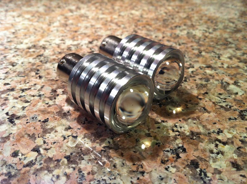

I run after market tail lights so my brake and running lights are a grid of LEDs. I do have LED back up lights and LED turn signals. You can install an 1157 LED bulb for brake and tail but make sure they are as bright or brighter than stock. This is something you don't want to skimp on.

Super Bright S25 1210 40-SMD LED Light Bulb - 1156 or 1157
